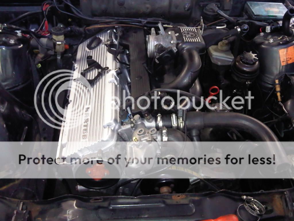

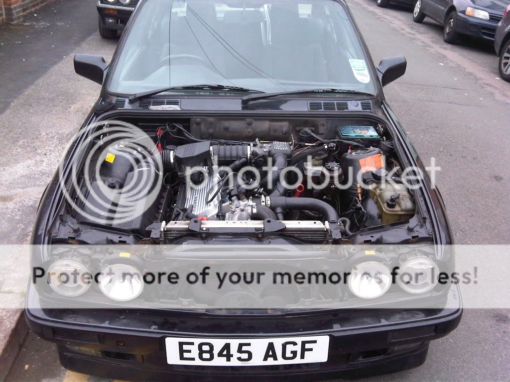

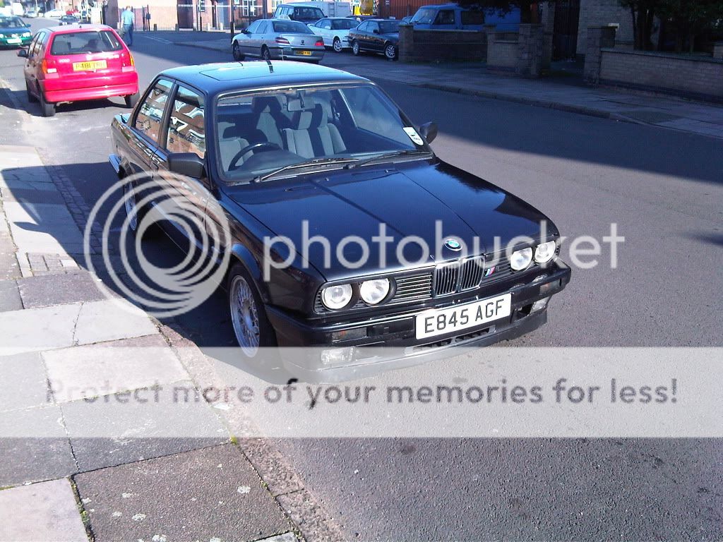

few guys were asking for some pics of the project, want to sell up to be honest as i haven't got the money to carry this on and run a business at the same time. here ya go....ImageImage
ImageImage[/img]three sisters,sort of!

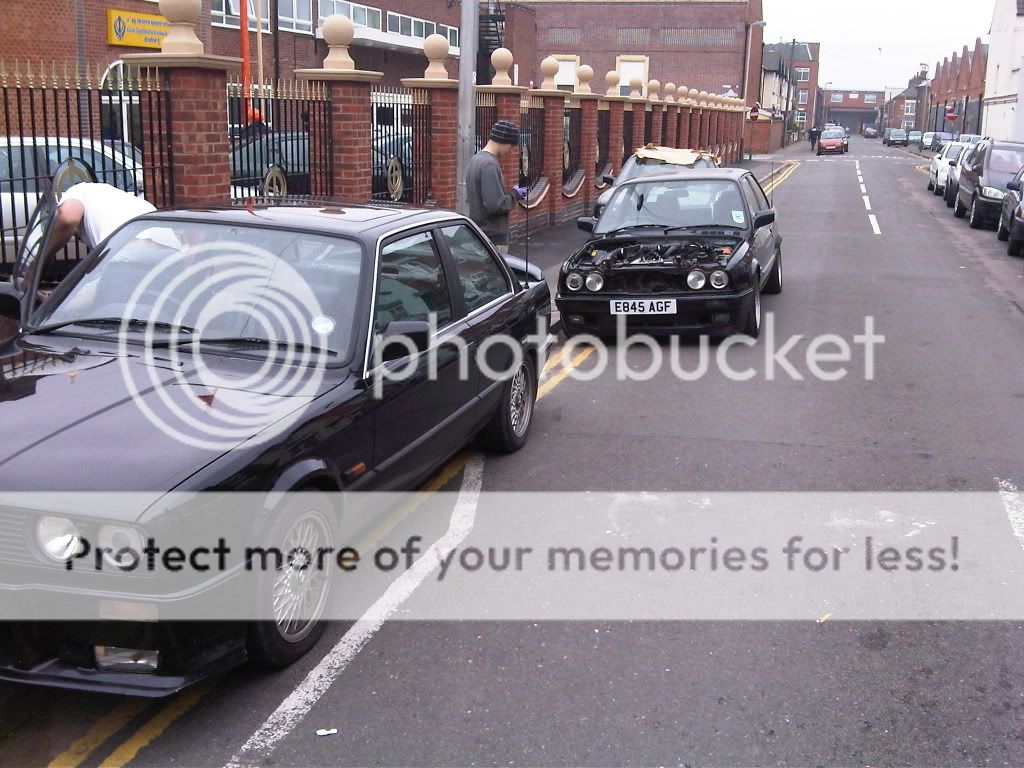

looking good mate,last pic is on east park road wright :D

yep,last pic is on roseberry street! opp the gurdwara...i will upload a few more pics

Is it a genuine Hartge M30 engine or just a couple of bolt on twinkets? i.e rocker cover.
'85 Hartge H28
staley_turbo
Posts: 1391
Location: Leicester
Wed Oct 20, 2010 9:41 am
This is a genuine engine, seen it myself.

bmwsport wrote:Is it a genuine Hartge M30 engine or just a couple of bolt on twinkets? i.e rocker cover.
nah its the real thing bud :D

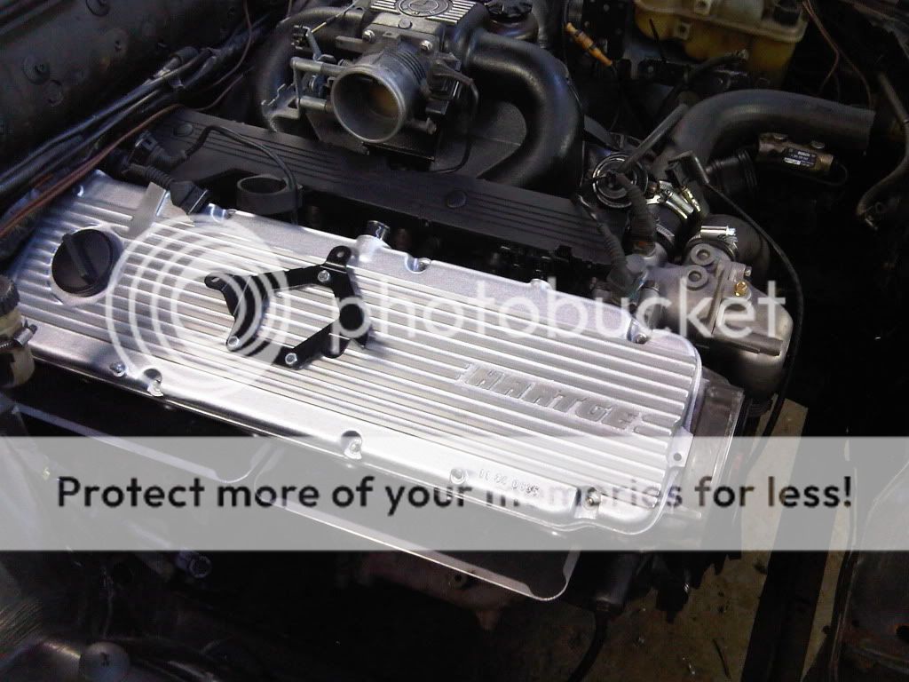

i think this one is 240bhp....not a hartge nut so i don't exactly know for sure,cam has defo been changed and the ecu mapped by them,as for other mods i don't know for sure,the pistons looked like non standard items when i had the head off it. but i'm sure somebody on here knows exactly what went into the hartge engines. did anybody like what i did with the rocker cover? i tried to make the engine bay a little brighter than the normal black finish...
