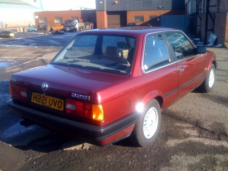

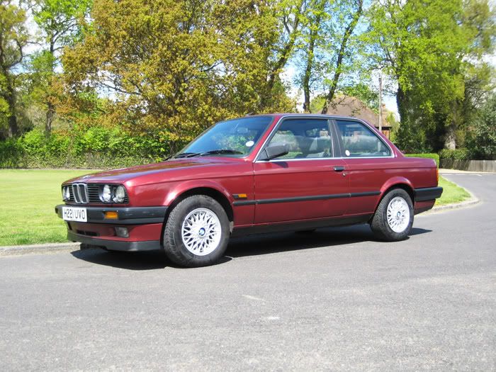

I bought and collected a totally original and unmolested 1990 325i (E30) Manual Coupe in Calypso Red. It had done 101000miles from new with full sevice history (main dealer up until 10 months ago), every tax disc and MOT from new and fully serviced. It is a really solid shell with only light surface rust to the rear arches which I will sort out and none anywhere else. I was thinking of using a MK2 Golf as a base for this project but have had 7 over the years and think I'll have more fun on the circuit with a RWD car. I am a big fan of E30s having owned one before so a manual coupe fitted the bill.
So here she is (sorry for the crappy iPhone pics)... The plan was very much to get my hands dirty and enjoy learning a thing or two about prepping my own car but unfortunately my work commitments have stood in the way of that!.
I got the train from Sevenoaks to Wolverhampton via London on a Saturday morning and drove her 160 miles back. She didn't miss a beat and was such a smooth drive. I am so happy with it! Having covered another 50 or so miles in it on Sunday and enjoyed it so much I was left thinking that this car is actually too good to strip and track as planned.

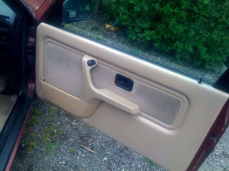

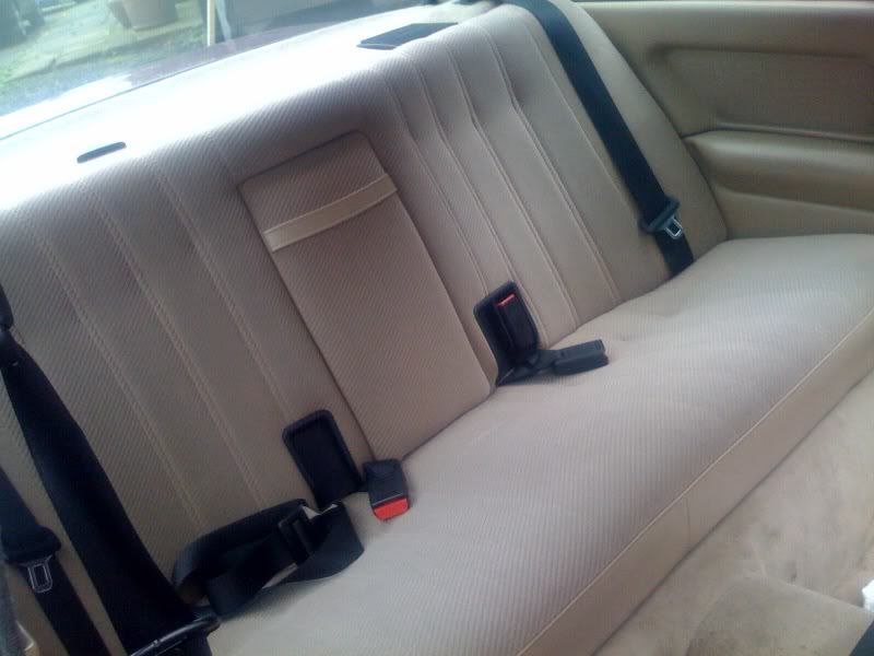

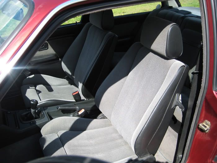

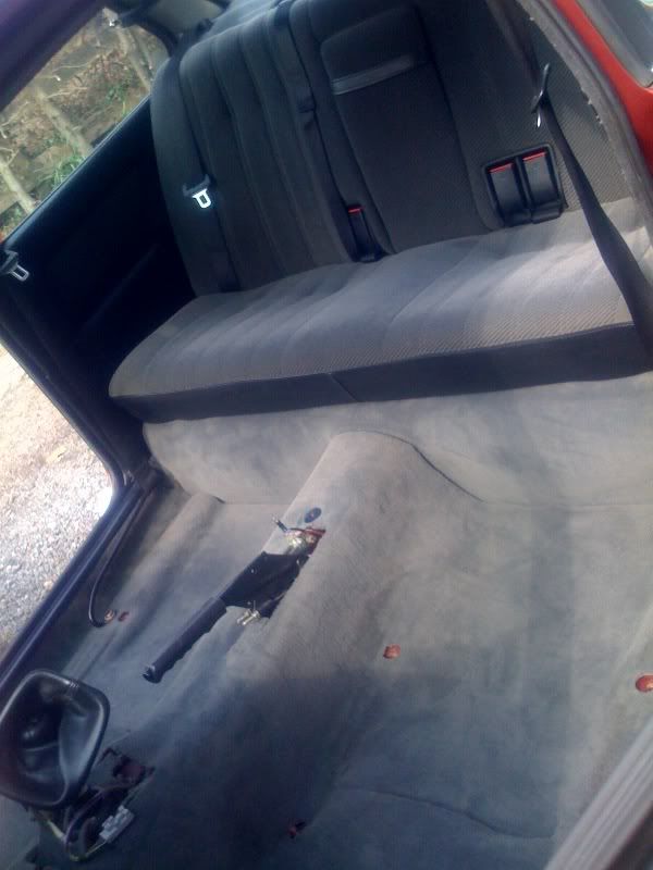

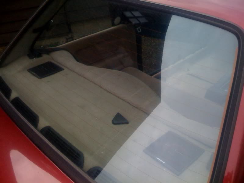

Ok a bit of an update. I had a moment of madness last week when I decided it would be a good idea to sell the E30 but it is too good an example to sell so soon and good honest cheap fun so I am moving on to the next stage. I have been too busy to start working on the car over the last couple of months since buying it (the main reason I was going to sell) so in that time have just been using it. I have covered around 2000 miles in two months and it hasn't missed a beat so I am really pleased with the purchase. Having enjoyed it sooooo much I decided that the car was too good to strip and cage so am going to make all the chassis tweaks as planned but maintain an interior as I am going to use the car as my daily also. This means I can get the full benefit of the car and save some money over the Summer not running this and another.
Two weeks ago I fitted a complete black and grey interior from an MTECII 'Sport' model to give more support with its much larger bolsters than the comfort spec ones. I also fitted a deeper genuine 318is chin spoiler too. My interior was beige and the new interior is black and grey. Fortunately a friend of mine (McCarthy) has just stripped his to build a track car so I was able to grab all his grey interior bits including the full carpet which I fitted along with the interior. A hell of a job but well worth it as it has transformed the interior of the car from an old man's cruiser into a far more supportive and modern feeling sports interior. Being the 'sport' seats there is also far more adjustment which has enabled me to get the fronts much lower in the car than the 'comfort' spec originals. It now feels a much better place to be sitting lower in the car. B)
So here goes, out with the beige...
Found this stamp under the carpet too which was cool...
And in with the grey Sport interior...

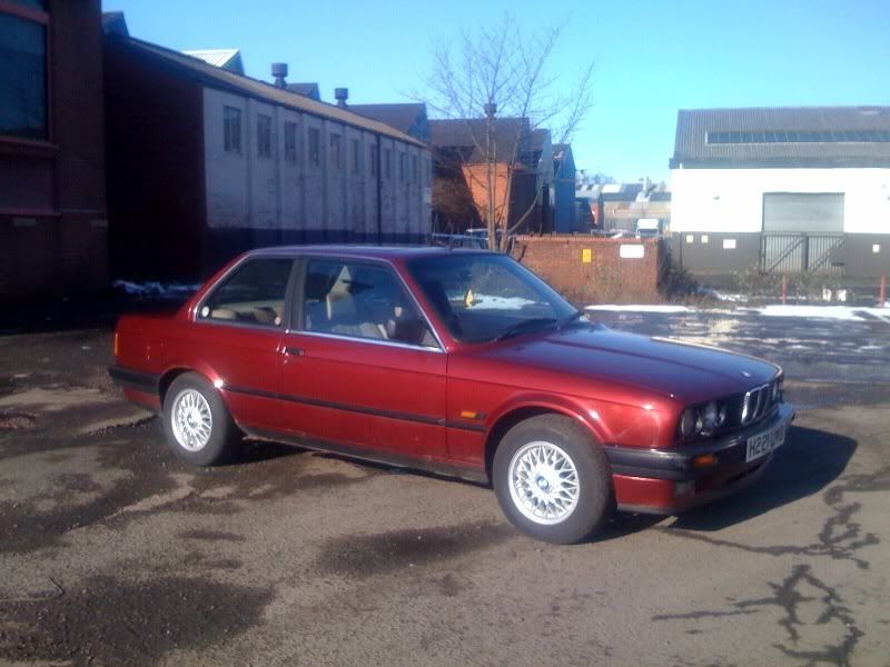

So below are some fresh shots of the car from when I had my moment of madness and was going to sell. The first time it had been cleaned since buying it which is unheard of for me :o: . Sport interior with the complete carpet/shelf etc from my mates car installed and the new 318is lip spoiler at the front.

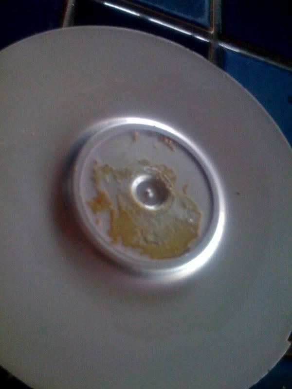

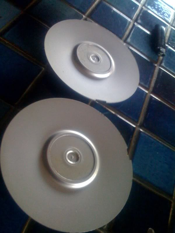

I also got up early on Thursday to take the Hartges to 'Spit&Polish' for refurbishing. I'm getting the guys to do the centre caps too so removed the old perished badges and set about clearing the 20 year old adhesive with some of my Girlfriends nail varnish remover. :ph34r:
Softened it up nicely...
And clear... :)

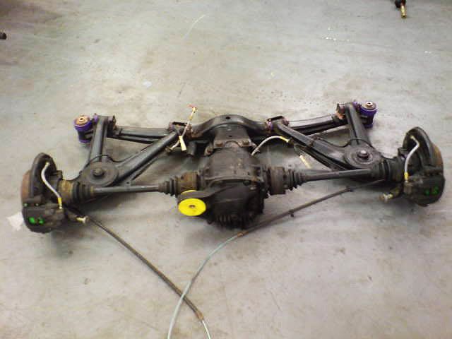

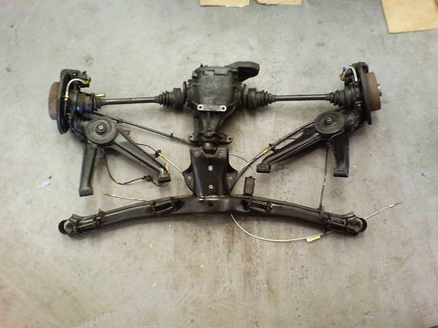

Ok so a bit of an update chaps. Darren and Rob at G-Werks resolved the ride height issue by contacting H&R and getting them to dispatch the correct springs. It turns out we were supplied the wrong kit which was for a Convertible with it's extra weight hence why it was so jacked up at the rear. The only difference between the two kits is the rear springs so the car went back into Alltech Garge for round two.

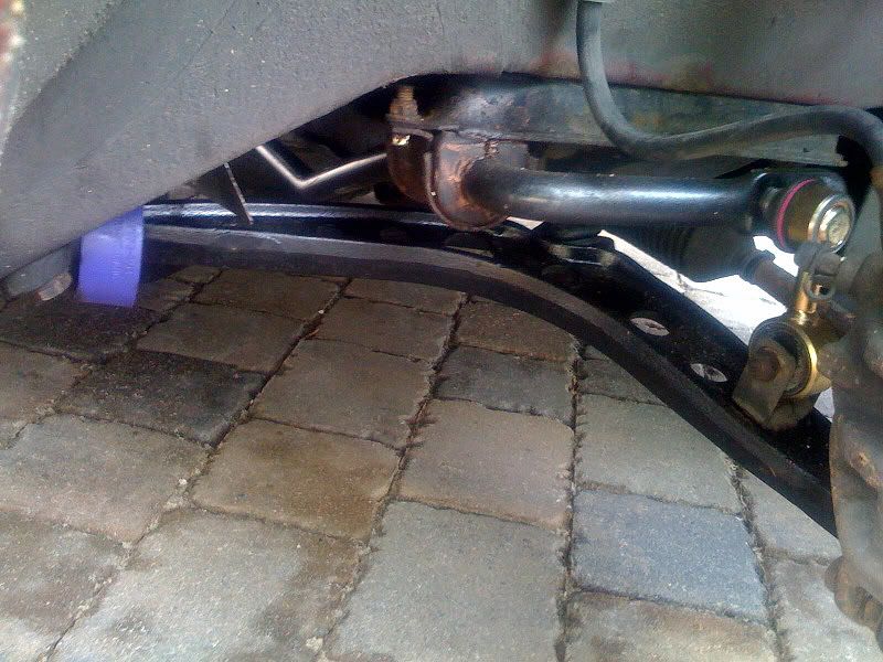

Here are some pics from round one when all the front chassis modes were done. All new bushes, droplinks, lower arms, H&R Cup suspension and H&R Anti-roll bars.
So round two...
- Fitting of the correct lowered and uprated springs (H&R 40mm rear)
- Goodridge brake lines
- Uprated brake pads
- 3.73 Limited slip diff
- Fully polybushing the rear subframe
- Custom fabricated brackets welded to rear axle allowing for rear camber adjustment
- Perished rear exhaust section replaced with another
The guys did an amazing job on the car. Once removed the whole rear subframe was dismantled, de-rusted, re-sprayed, polybushed and re-built it. At the same time the brake lines were upgraded, calipers rubbed back and re-painted black and a full service including all belts and cambelt done too. A seriously thorough job and what a difference it has made!
Dismantled, refurbed with replacement LSD...awaiting bushes from Powerflex...
Finally they arrive! Rebuilt...

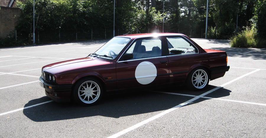

So wheels on and the correct ride height with stickers for Le Mans... B)
