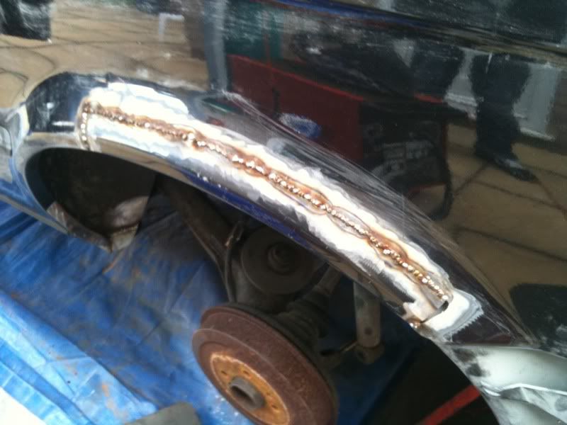

VW-will wrote:2 new lips for the inner arch and the outer arch made up, outer arch has the holes init so it canbe spot welded to the new inner lip, i do have a proper spot welder but it keeps nocking the fuse of my garage out, think its a bit to heavy! haha
If you have a mbc (circuit breaker) and not a rewire-able fuse swap it for a type C rather than a type B problem solved.

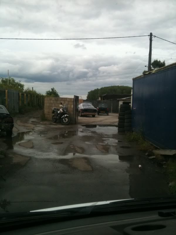

been a while since ive posted, done loads since then
cars back on its wheels and went into be sprayed today, here are some pictures..
Image 1st 59plate e30 yeh?
Saying goodbye to it at the sprayers..
