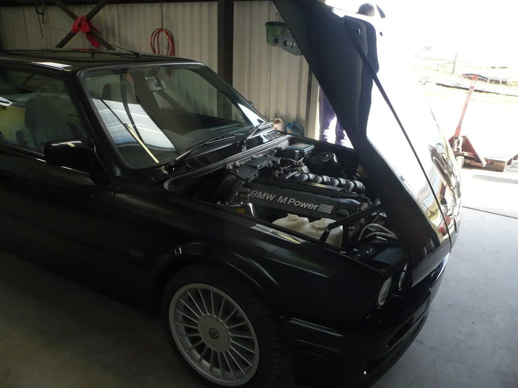

Top job mate. That engine bay looks great, very neat and tidy.
Paint job at the same time? You've got to have deep pockets!!

She looks lovely mate. The unbeatable looks of a schwarz black tech II coupled with S50 power.... perfect.

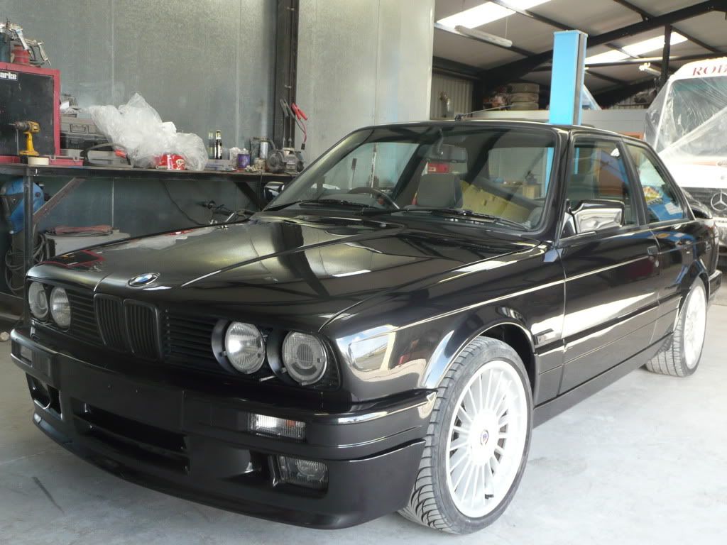

Blimey that looks lovely
Just needs a red interior

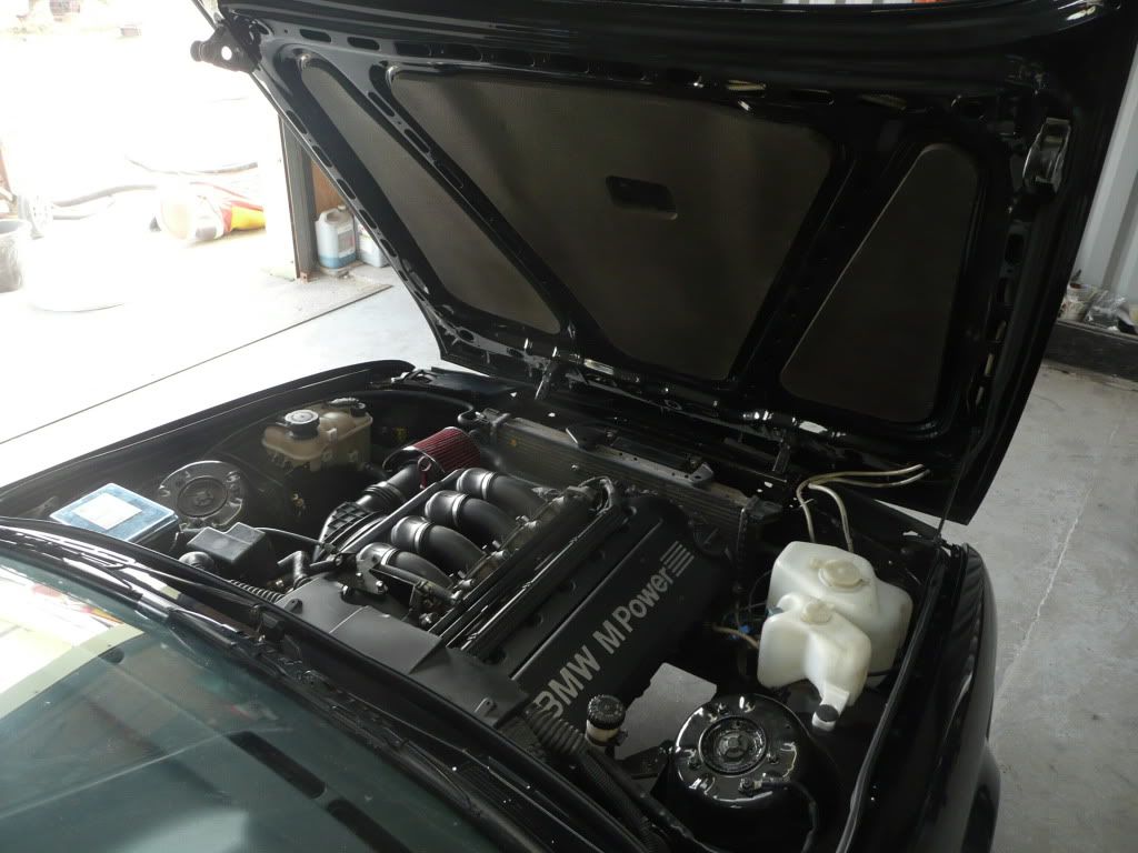

Very nice,, but please remove the cone filter and try to use an oem airbox if you can,,
on rough pedal,, the heat inside the engine bay will steal a lot of horses from you

Looks tops, the S50 looks like a factory fit. Good work

Beautiful! I'd say the front needs just a slight drop though.

datourer wrote:Beautiful! I'd say the front needs just a slight drop though.
its all new suspension so hoping it will settle a little bit more, but not wanting it much lower as the sump it quite low and bumpy roads up here

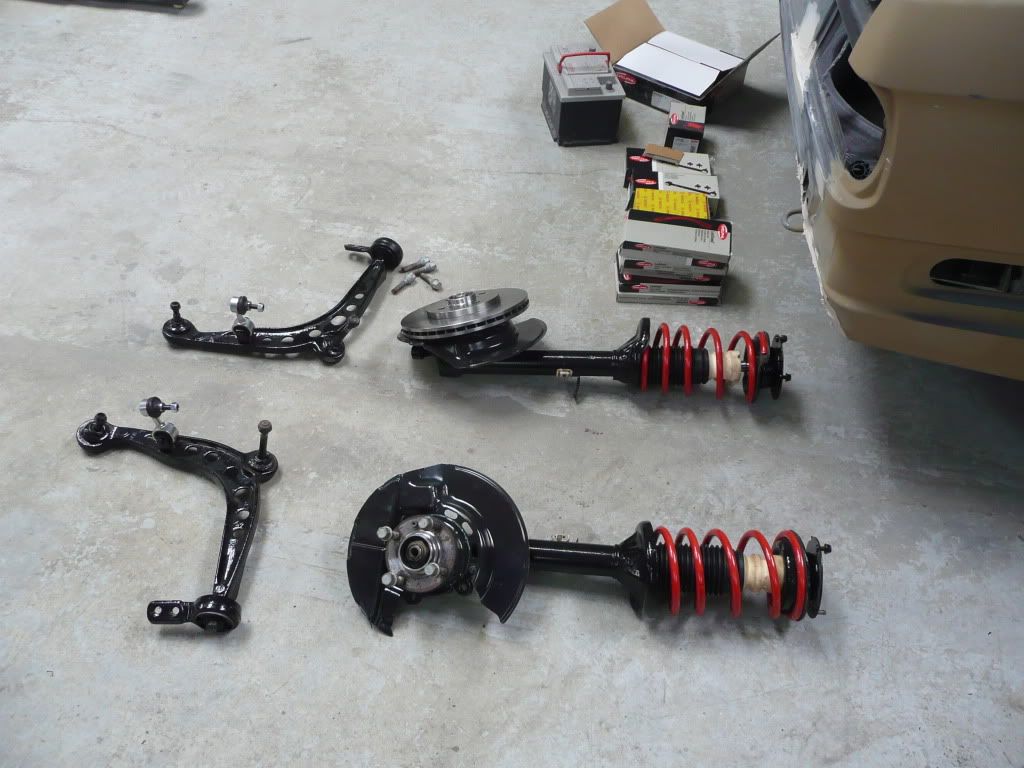

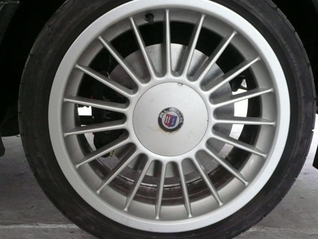

What size brakes you got there mate? Im looking to buy them and put pinas over the top aswell.

staley_turbo wrote:What size brakes you got there mate? Im looking to buy them and put pinas over the top aswell.
Hi, got the kit from Keri-WMS (its on the zone somewhere)
300mm discs,4 pot calipers and i had to use 20mm wheel spacers

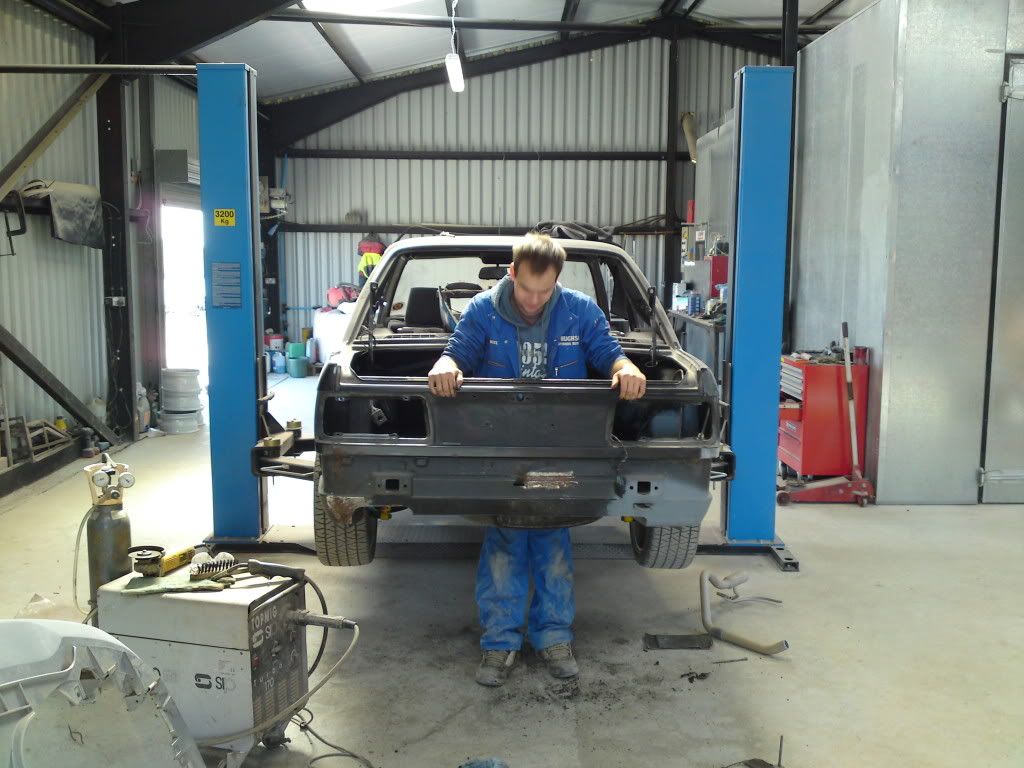

hey the car is looking great mate. some paint job that bit of orange peal tho you gonna give it a buff up? what exhaust you going for ? i think that cool looking guy in the photo standin in the boot floor would need a pay rise cos he has obviously done a great job

Ha Ha thats my apprentice that thinks he looks cool

Just for general reference, this is the "fat" 300mm kit (300x26 = 4P144, flattish disc), the other big WMS kit (298.5x24 = 4P028, deeper offset disc) gives the wheel 6.5mm more spoke clearance.
