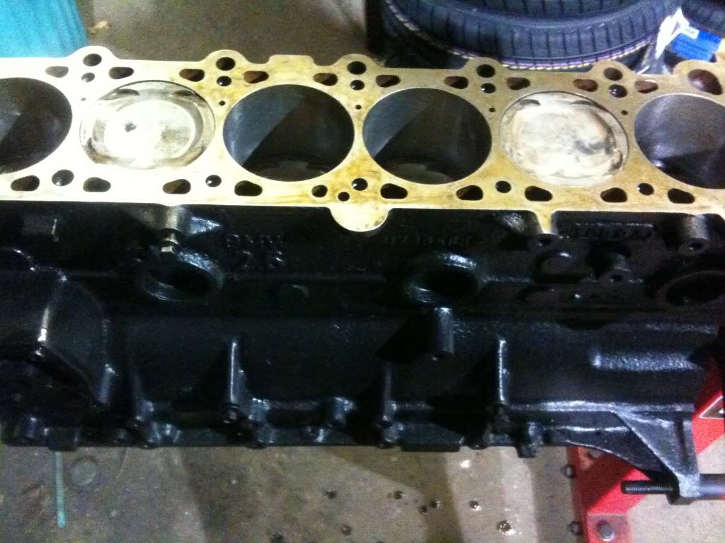

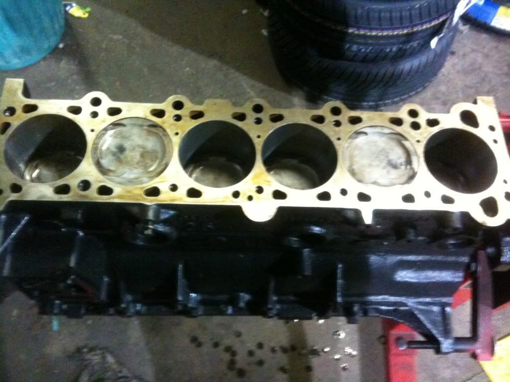

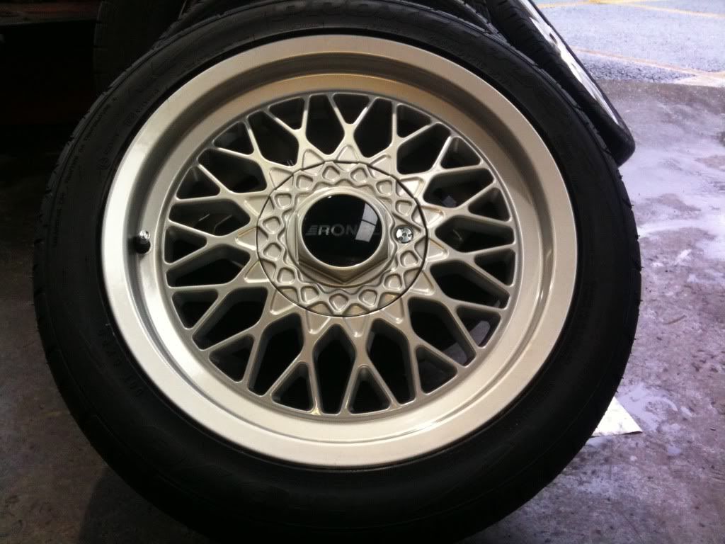

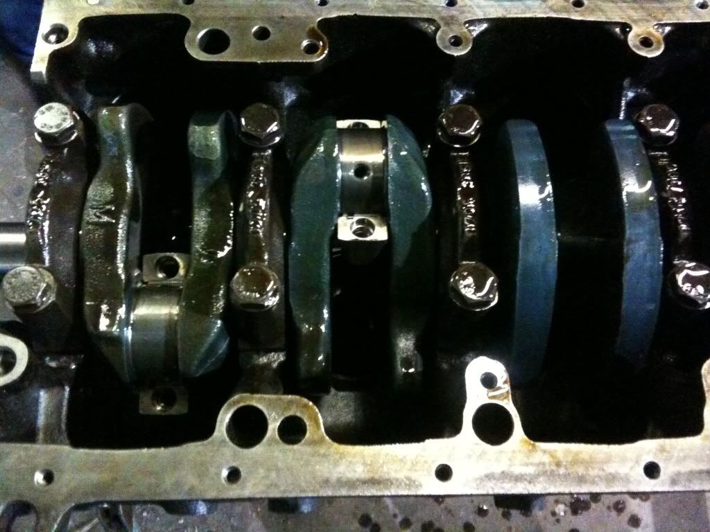

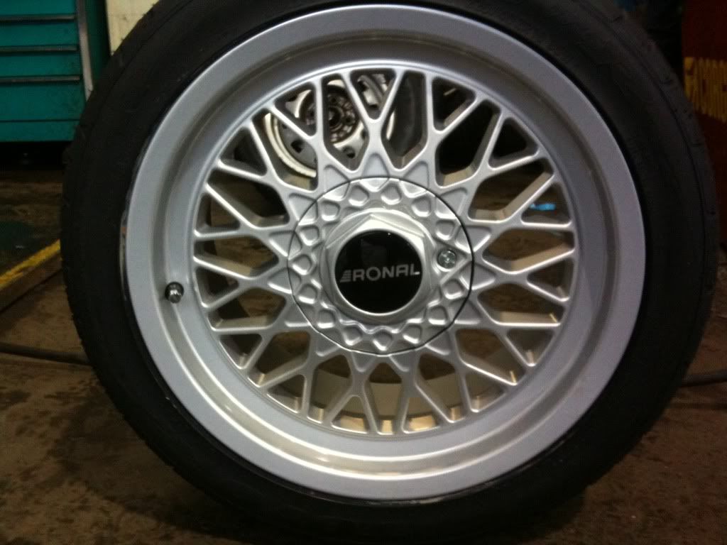

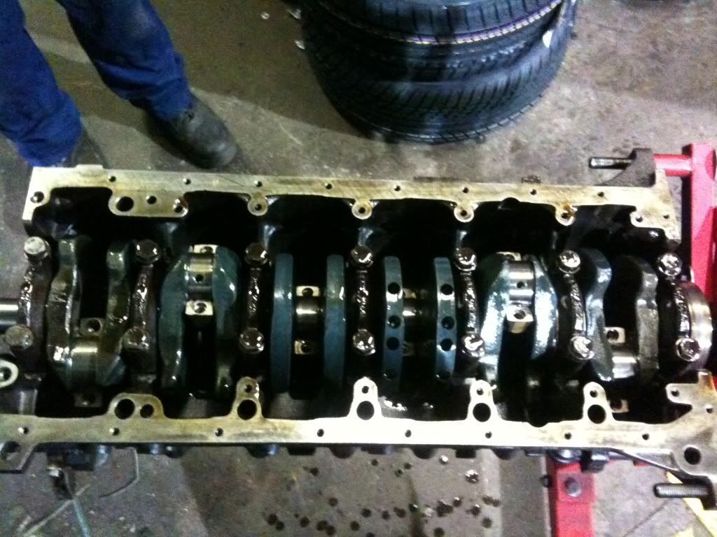

Got my finger out my arse today.
The M50B30 has a bottom end :woohoo:
Oh and new Wheels :cool:
I am just waiting for the diff case to come back from the coaters and my mate is putting new oil seals in the head.
Then i can fit the shrick sticks and chuck this bad boy togeather :wave:
Tue Feb 02, 2010 8:28 pm
Nice one breadbin, looking at those cylinders you should have used bigger pistons :) They are not flat topped like I expected
Be careful when pulling down those cams! :eek:
Tue Feb 02, 2010 8:30 pm
What crank, rods and pistons have you used to go B30?

bss325i wrote:What crank, rods and pistons have you used to go B30?
M52 crank
S50B30 pistons
2.926cc if I remember Dan?
Oh them cams are my babys mate rapped in oil rags in the cardboard tubes under the spare bed warm and dry. My arse will be going 5pence 50pence putting them in :eek:

Tue Feb 02, 2010 8:57 pm
DanThe wrote:Nice one breadbin, looking at those cylinders you should have used bigger pistons :) They are not flat topped like I expected
They are big enough mate. The machine shop wasn't happy takng 2mm out of the bores as it was especially as I want 0.5mm of the block too and custom little ends ha ha.
