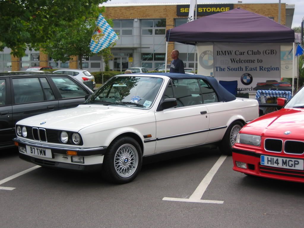

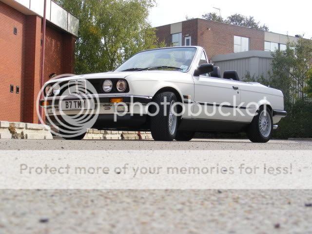

Heres a couple of shots from the vines "JOY" event.

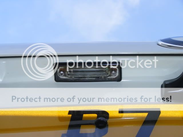

Numberplate light porn! Stainless bolts? The aggro I had replacing the rusted in buggers on one of the e30s I had... doesn't bear thinking about.
Had a bit of a nose round this car at Gaydon - must be among the best condition e30s in the country, a real credit to you.

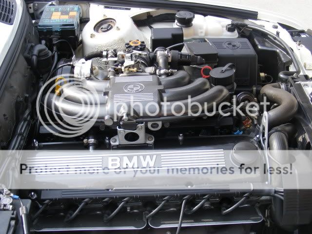

With the engine built

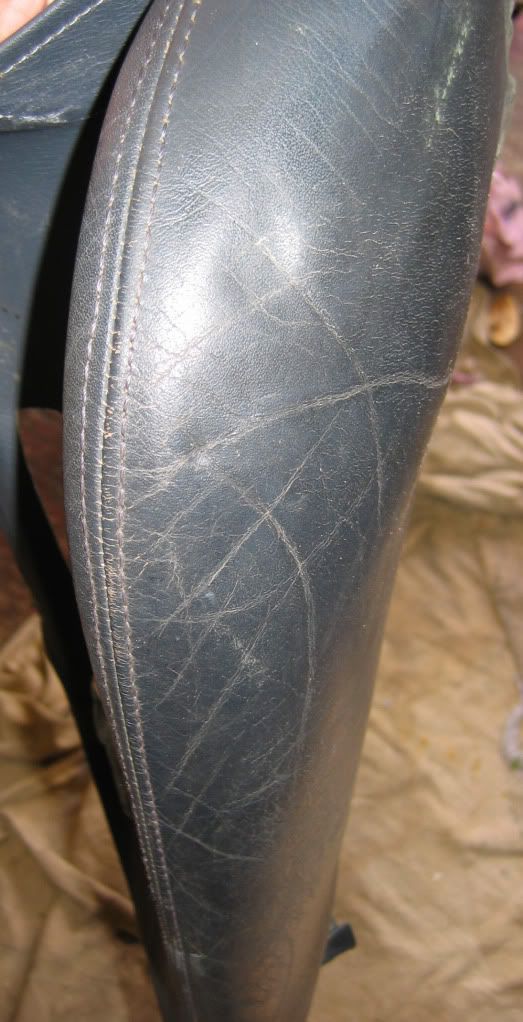

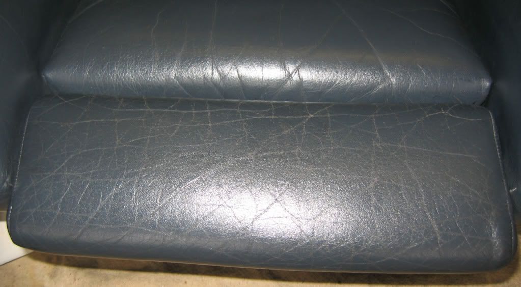

1. I've not been happy with the passenger’s seat, the base and lower outer bolsters both have significant cracking so wanted that improving.
2. The driver’s seat has always been a right pain. If I'm not careful getting into the car, my fat arse catches the recline leaver, pushes it down and the seat shoots to the floor!!!
3. Dash has JUST started to gain a few minute sun damage cracks. This will be covered later as I have now secured a MINTY MINT 65k dash from a broken 1 lady owned 316i. winkeye

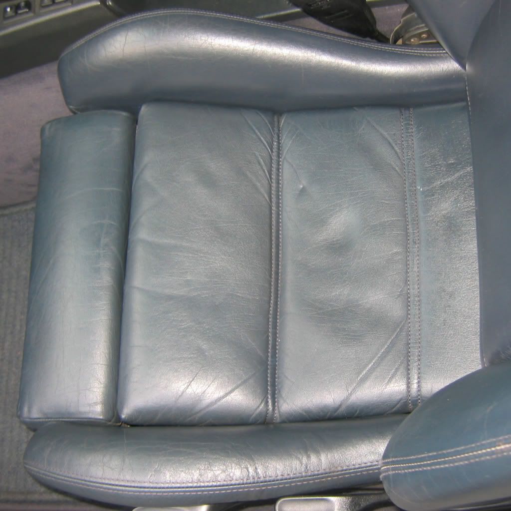

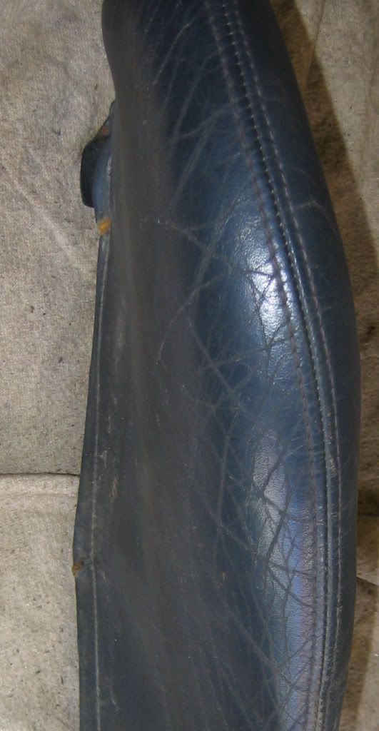

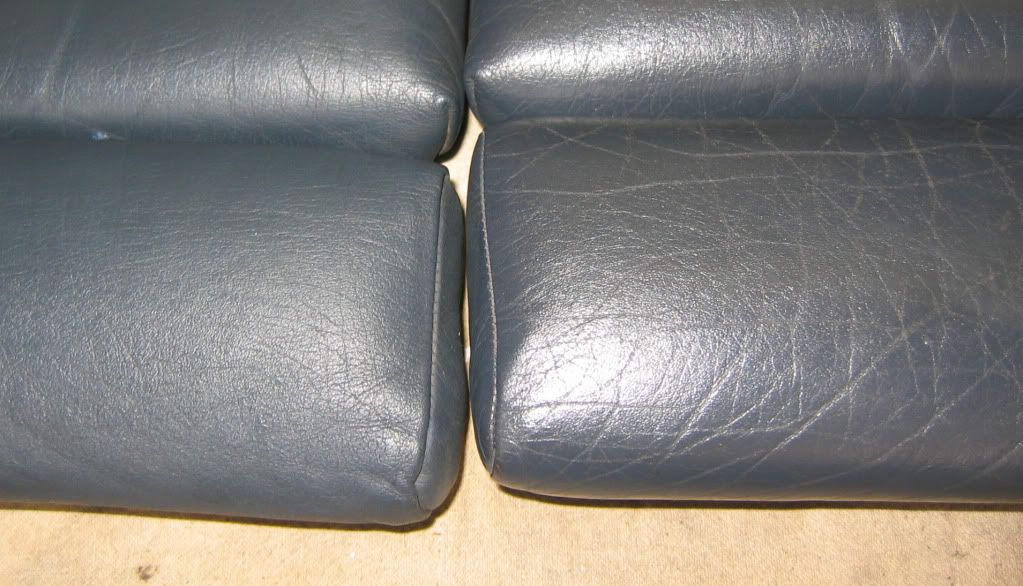

Here’s the passenger’s seat issues as per No1 above:

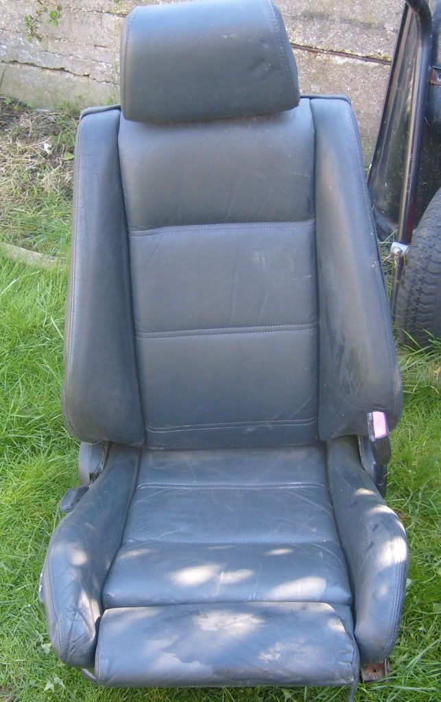

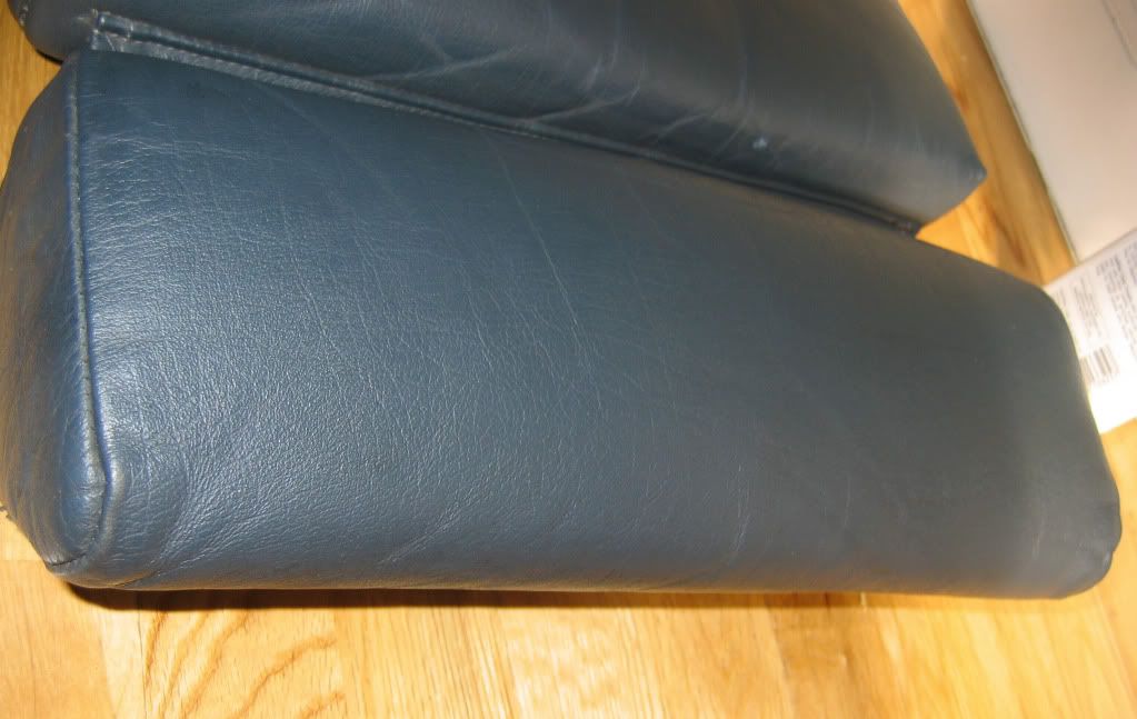

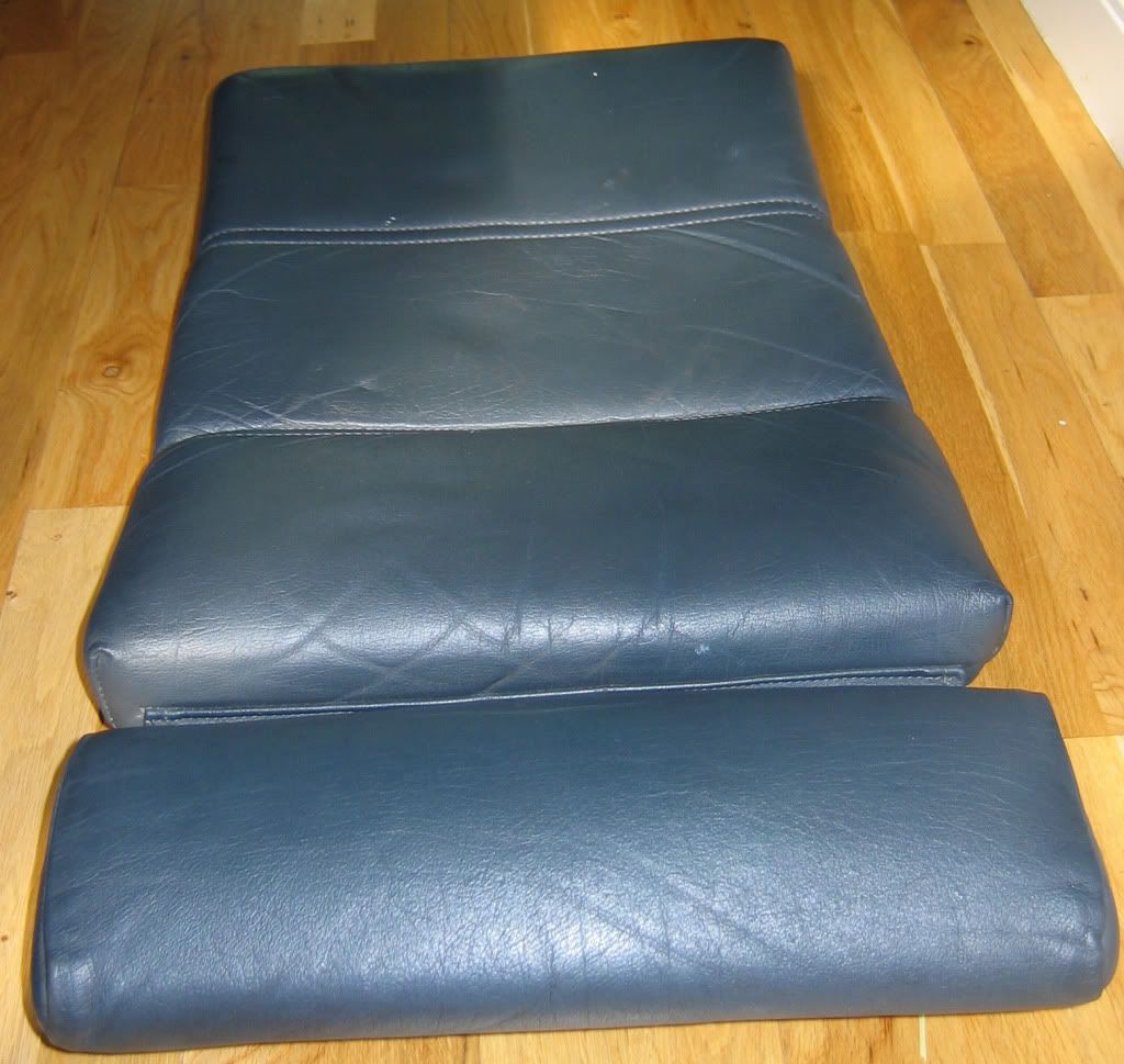

Adit rang me a while ago to let me know that he had an indigo leather convertible driver’s seat with no split stitching etc. Now with GOOD blue indigo leather trim now getting rare I decided to take a chance and buy it. Apologies to Adit now for the delay in collection but finally, last Wednesday, I got down to sunny Cosham and collected.
I buy as much Convertible leather parts in indigo as I can and have a loft full of it. I figure that if the seats ever get a snag or damaged, I have original parts to rectify it. Plus I’m not a fan of retrims as they never look original to me.

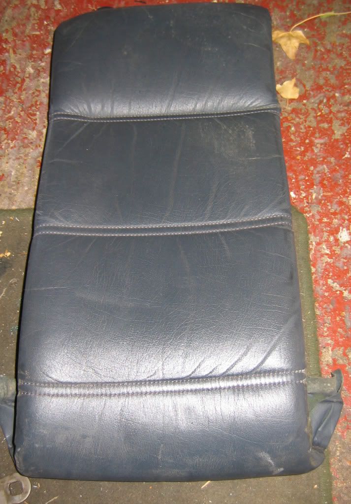

This is what I picked up:

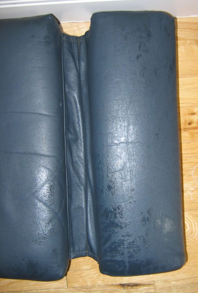

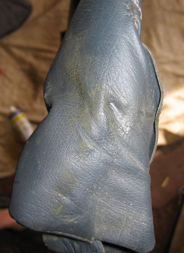

There’s no doubting the seat had been soaked at some stage and was rock hard.

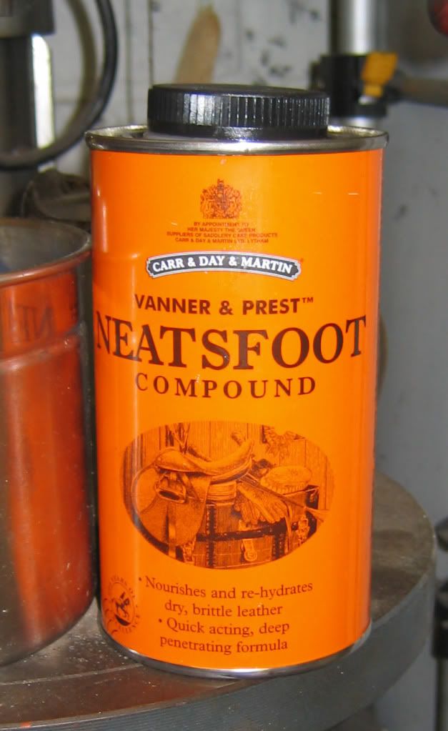

So I bought some of this after investigation on the interweb:
It’s supposed to rehydrate leather saddles replacing the natural oils. It’s a bit industrial TBO and I was a touch scared of using it as it says coat the inner flesh side of the hide. However, I though that may rot the bolsters so only used it sparingly on the outside. It definitely soaked it up and became more pliable.

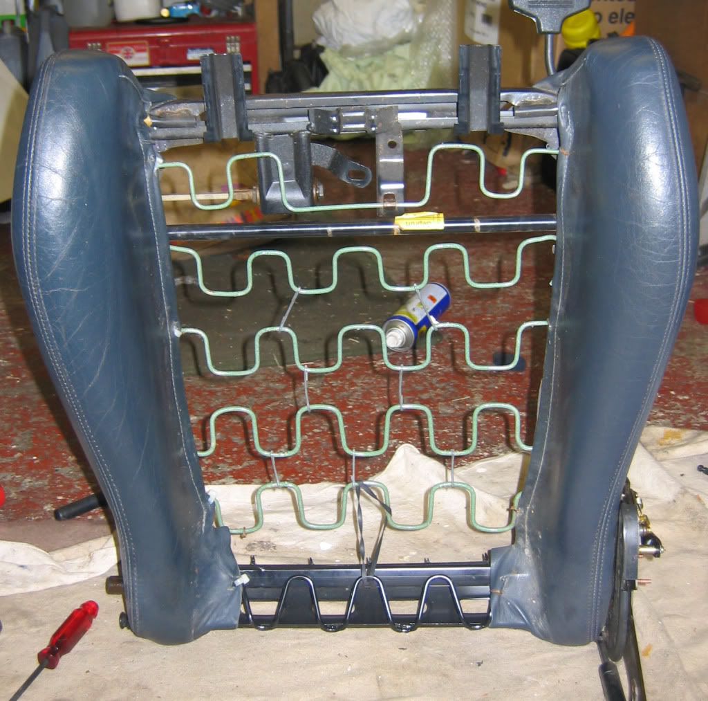

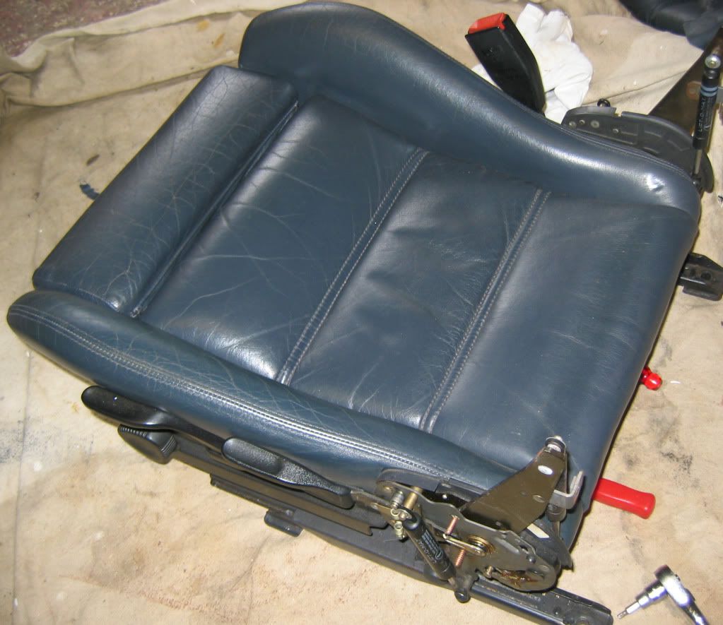

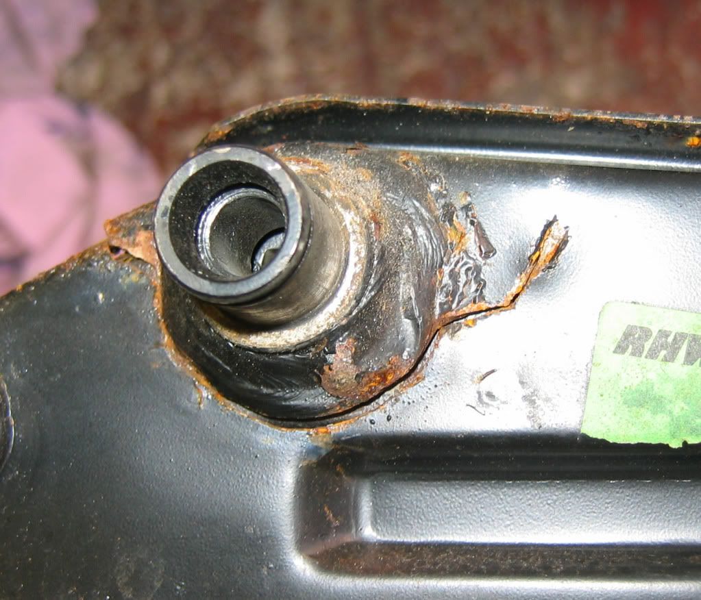

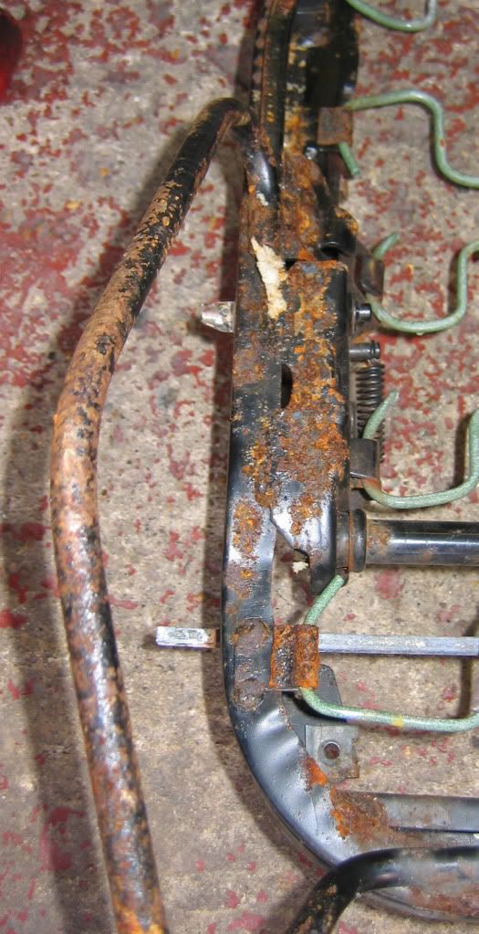

But before using it, yesterday I decided to strip the seat to the bone to see what could be salvaged.
The frame was scrap. Cracked around the hinge hole and looked like it’s seen the Titanic.
The hides were all in fairly good shape albeit hard (and green in places). So this is basically where we start the process:
I then deep cleaned with ”aCitri clean”a which I use for all my interior work. It’s a natural citrus based product that I got a free sample of with my last batch of TFR. I was so impressed I bought a gallon! Using a brush to get in the grain, the shit that came out was amazing.
http://cgi.ebay.co.uk/CITRI-CLEAN-ULTIM ... 415ab707a6

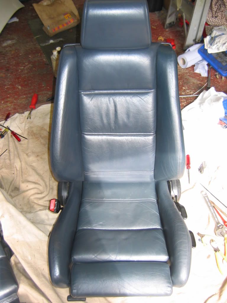

Then a coat of the Neatsfoot oil and you can see here how it’s soaking it in:
And finally, a copious amount of Autoglym Leather Conditioner has resulted in?????
Well please TBO. Should be a massive improvement over what’s in there!

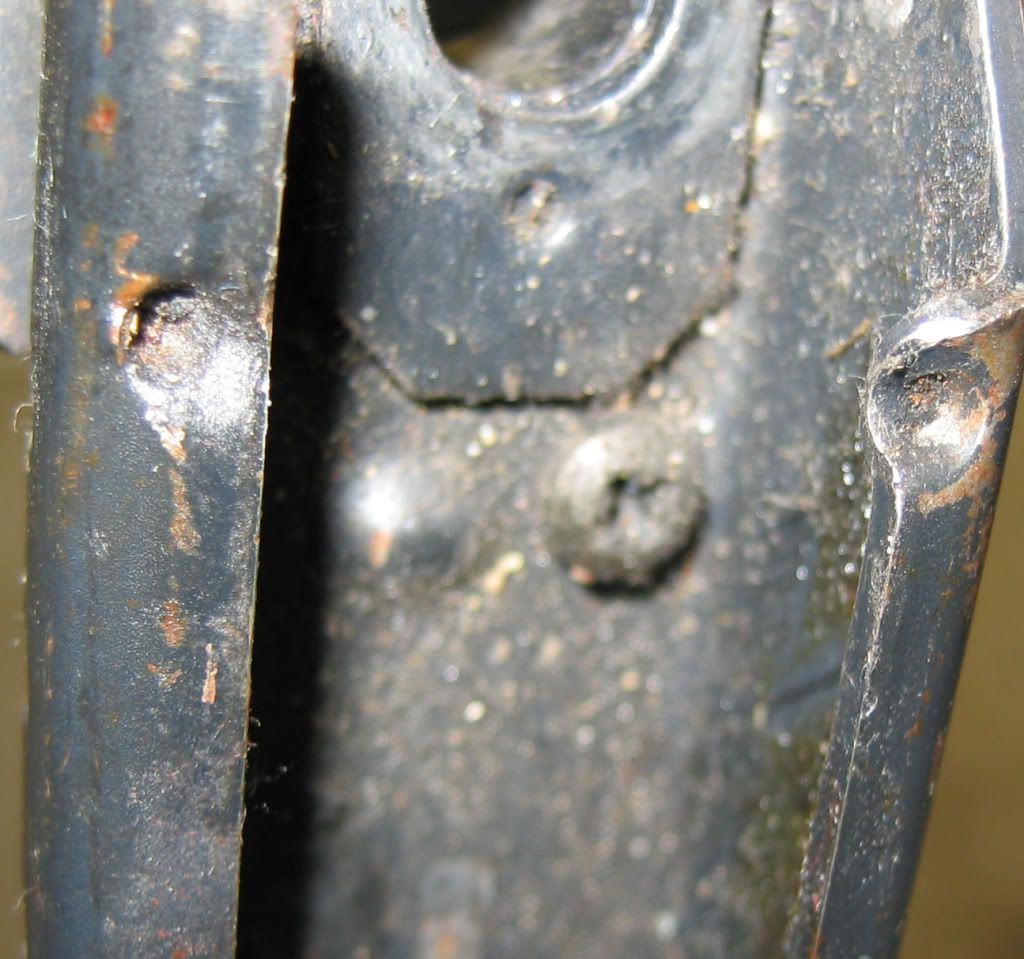

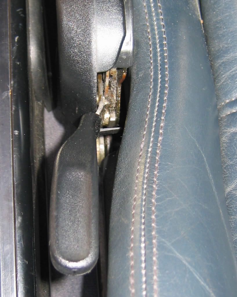

I next rebuilt the drivers seat using the mechanism’s thrown spare by Adits seat. Result? One straight handle and no more dropping to the deck as I enter the car!
You can see here the bent arm of the old mech:
And here’s the straight one in the car:

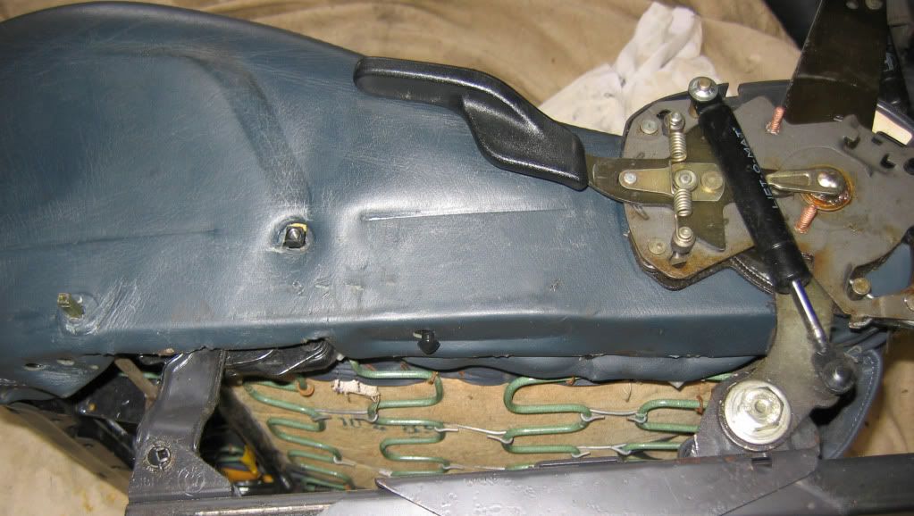

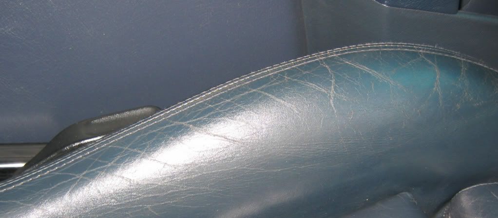

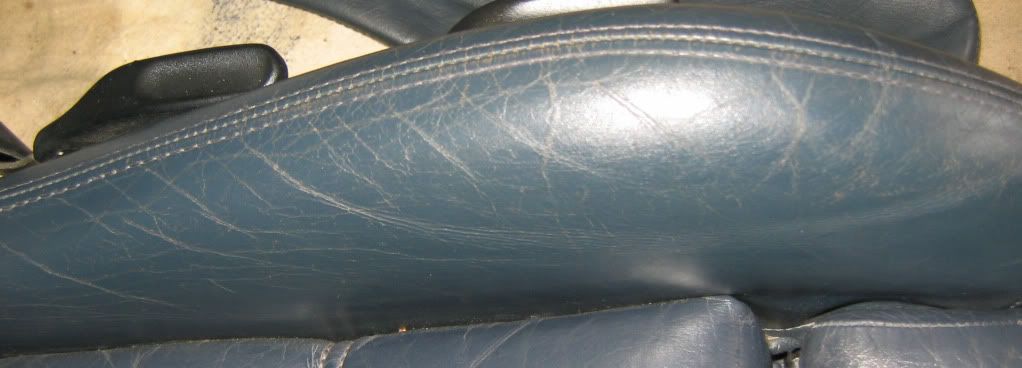

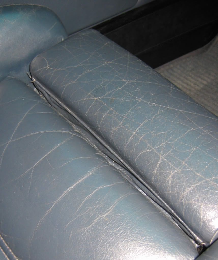

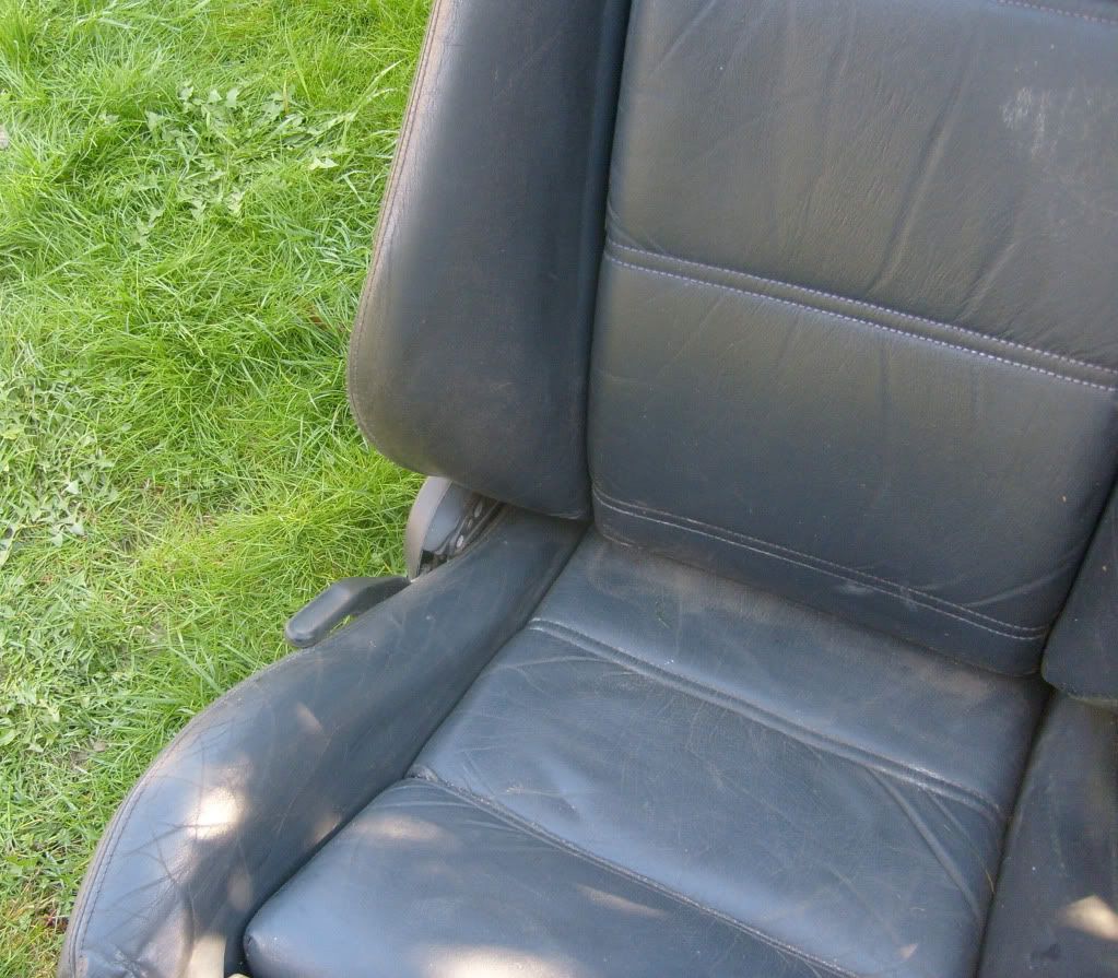

Finally got round to stripping the passengers seat out of the car and rid of its cracked wrongness.

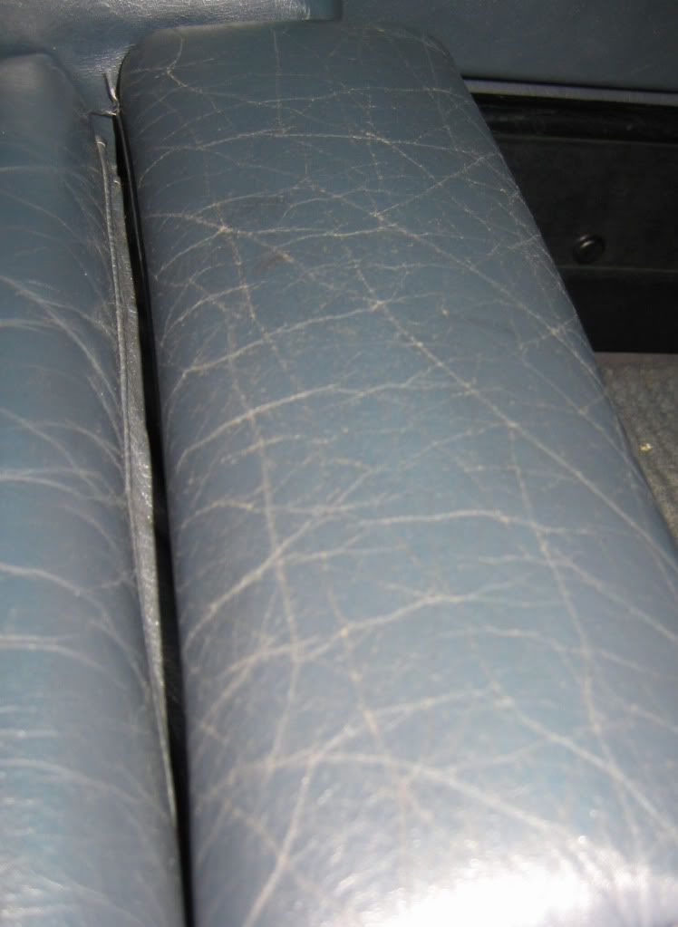

Here’s a shot of the seat out of the car and a couple of the cracking I want gone:

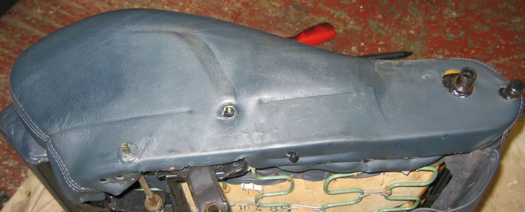

Now we get to the strip down. After removing the back rest you are left with the base.
Removal of the knee roll adjuster knob and the front height lever than allows the removal of the lower skirt trim. Also removed here is the recliner mechanism trim. This has to be removed before the backrest can come off as you need to disconnect the tilt cables.
As I was only replacing the one side bolster, only one base rail had to be removed. There’s a trick to removing the funny hinge / clip thingies at the front. You insert a small screwdriver as such, and drive it out from the other side.
Once the recliner mech is out the way we can start the real stripping.

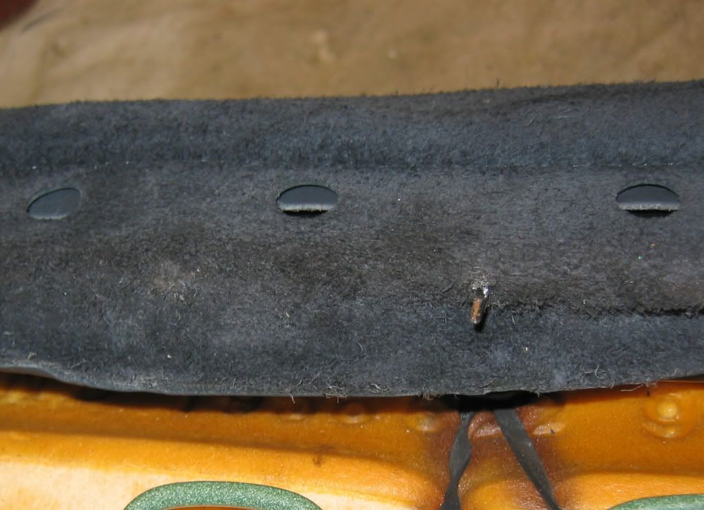

From here it’s a case of bending all the retaining tabs and spikes so that you can release the leather and cutting all the hot metal rings out.
And after removing the single clip and pin from the knee bolster mechanism, the old base can be lifted out.
The bolster is exactly the same, just a series of hot rings and bent tabs.

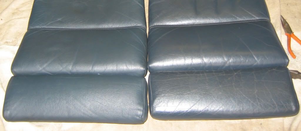

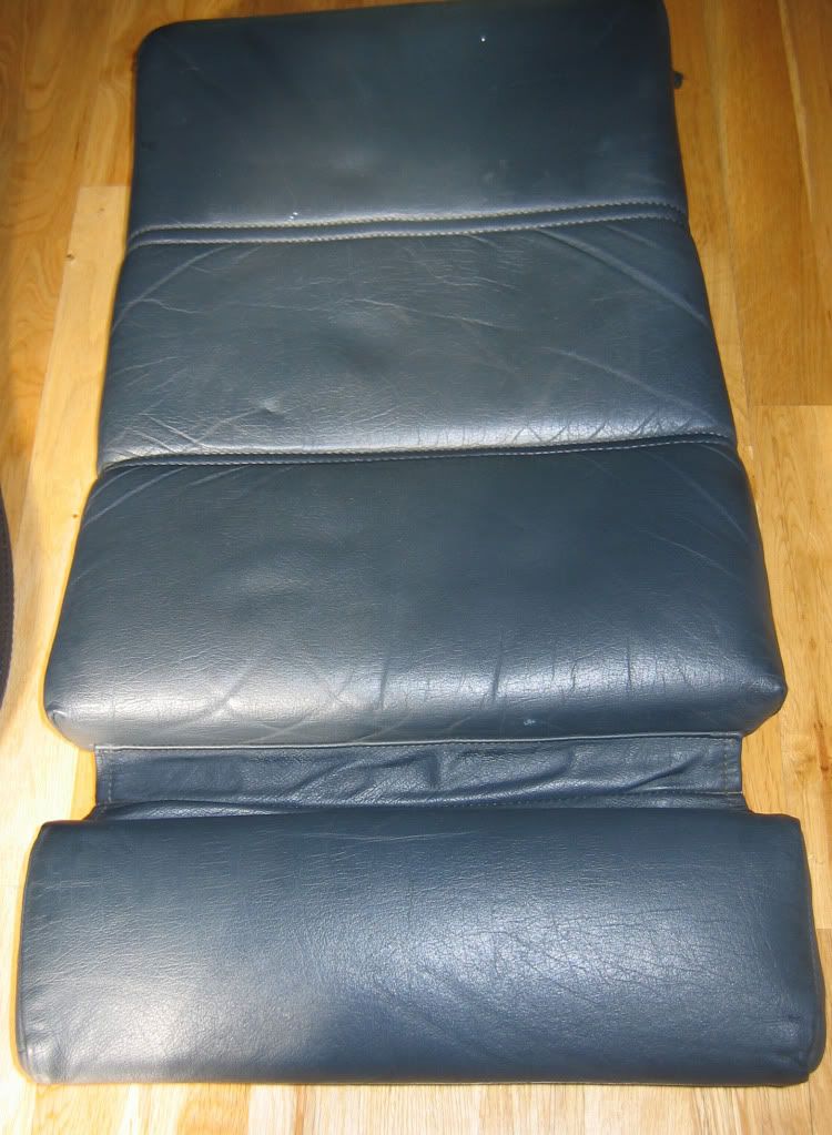

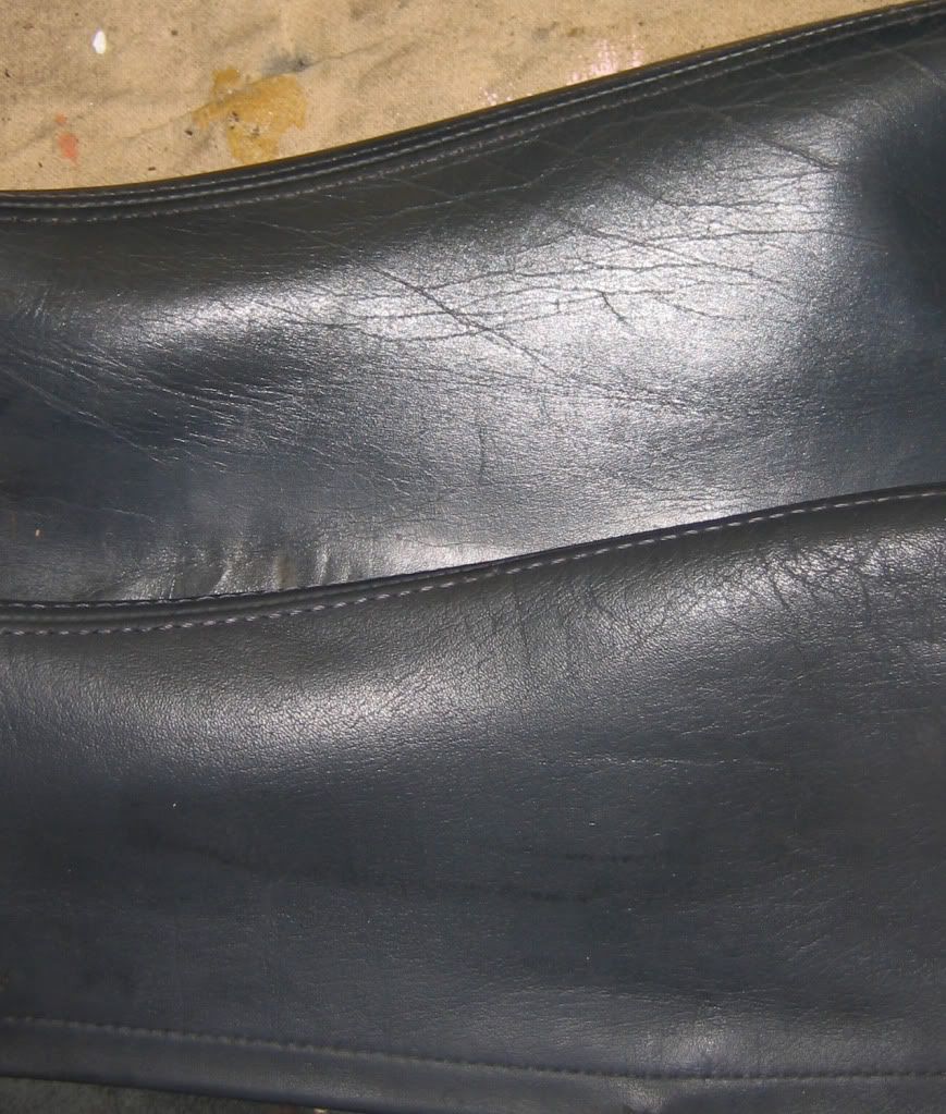

Here’s a shot of the old and replacements compared. The difference is obvious.

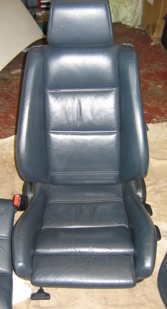

Reassembly is reversal of above taking time to ensure the bolster is in the right place. You can place too far forward, meaning the back won’t stretch over and the hide won’t reach the tabs.
And here’s how it looks in various stages of reassembly.
WELL pleased with the results. It actually looks a touch too new TBO but its soooo much better than the cracked look!

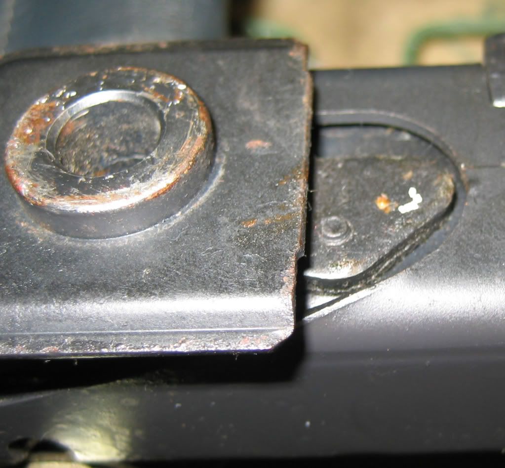

And I actually learned something today.

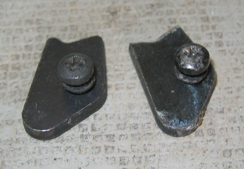

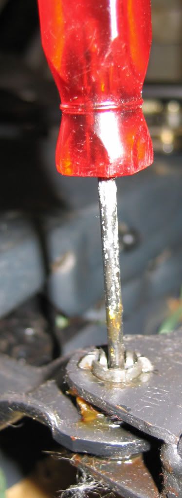

Ever since buying the car 7 years ago, I’ve been bugged by why I can’t get the seat far enough back! 7 F*cking years. I can get it right in a saloon, touring etc, but in a convertible I always sit too near the wheel. And today I found out why!
These little blighters are factory fitted to (one can only assume) ensure there’s enough legroom in the back. You can see them restricting rearward movement in the first shot
They are secured by this single screw accessible from above with the seat right forward
And these are they once fished out!
Once out, I can get the seat perfect! Happy days. I left the passengers in as that’s the side I will need legroom in.
