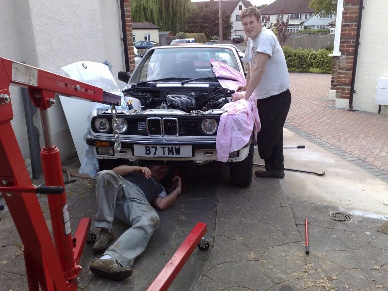

Not the best day I've had. The f*cker won't turn over!!
Engine turns by hand
Battery fully charged
try to start it (or at least spin it over on the key to get the oil pressure up)
CLICK.
Terminals all tight on the starter motor
Terminals all tight on the battery
earth strap all tight.
The b4stards all back together except the air flow meter and air filter but I'm stumped.
Bl00dy taxed the sod this morning as well :x :x :x :x

Crank sensor?
Posts: 15846
Sun May 10, 2009 8:04 am
cliffybabe wrote:Crank sensor?
It would turn over but not fire neil.
This it just a very loud click on turning the key.

Starters not jammed is it?
Posts: 15846
Sun May 10, 2009 8:48 am
d6dph wrote:Starters not jammed is it?
Thats what it sounds like. But I've beaten it up with a long extension and a hammer. No luck.

Have you taken it off and shoved 12v up it's arse?
Posts: 15846
Sun May 10, 2009 9:28 am
d6dph wrote:Have you taken it off and shoved 12v up it's arse?
easier said than done on an m20. I gave up yesterday. It's basically all there now. Just need another push really.
