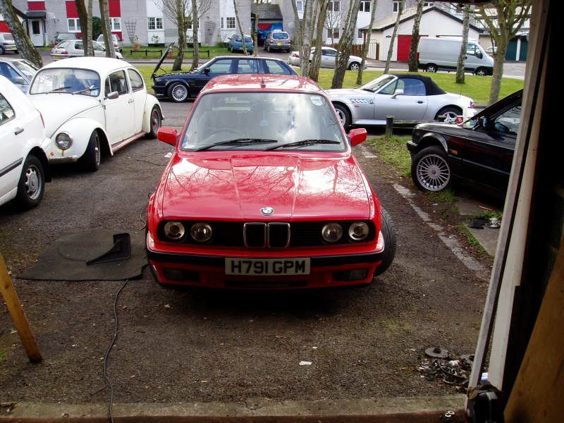

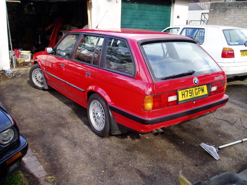

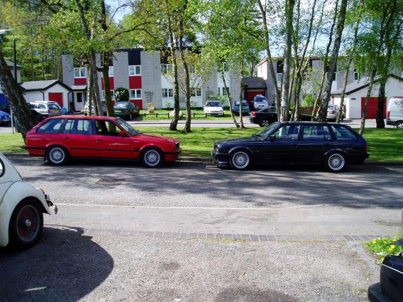

13's new daily, 320i touring!
Wed Apr 29, 2009 10:45 pm

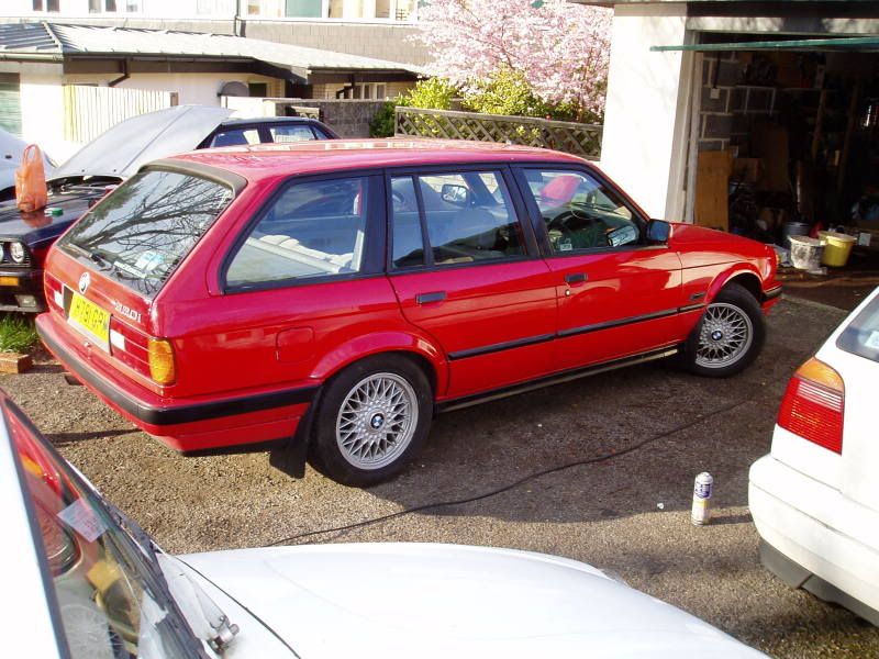

Yes after all these years of slagging the 320 i went and bought one. All of what i had said was true!
This maybe familar to some on here as its Gazmans old car.
I've changed the red skirts to stock black

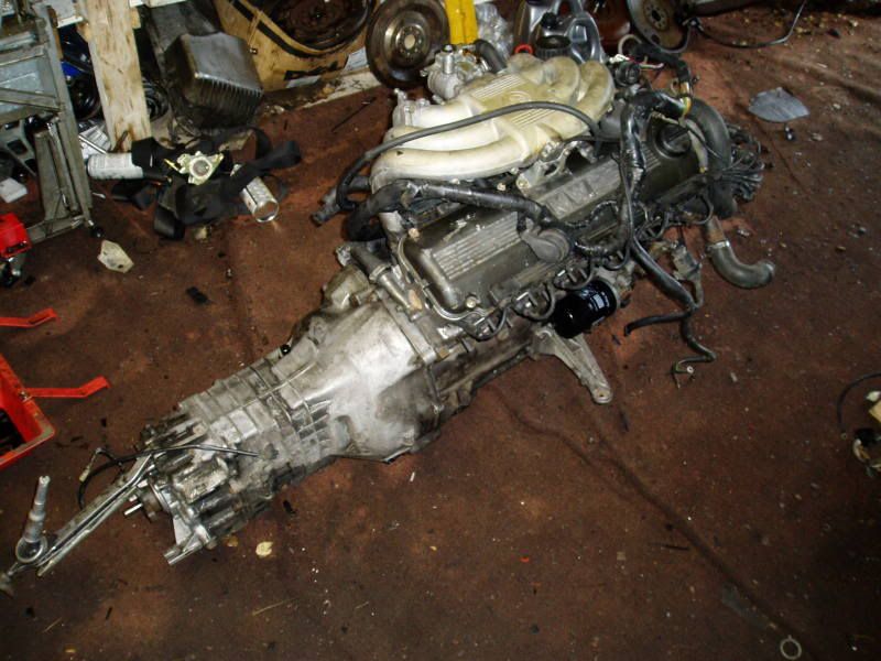

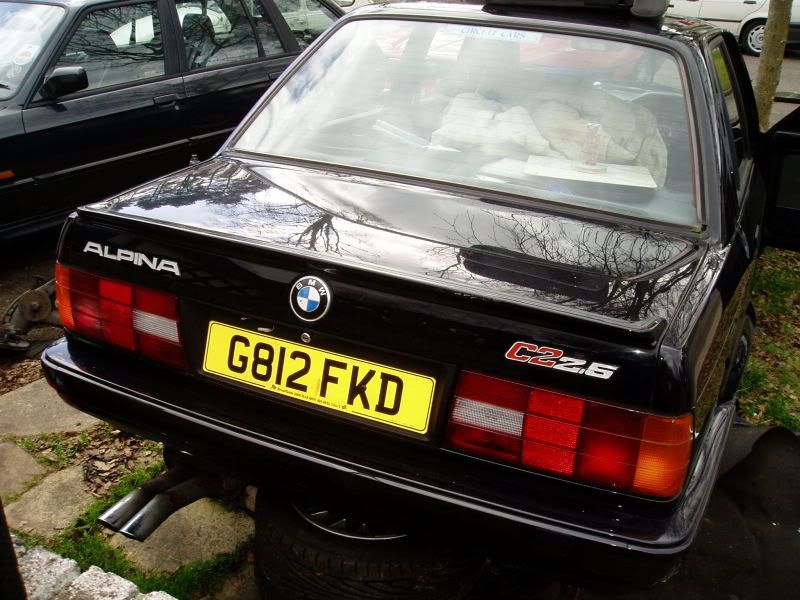

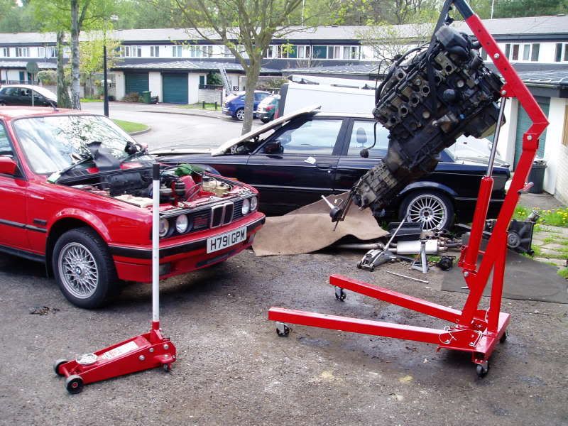

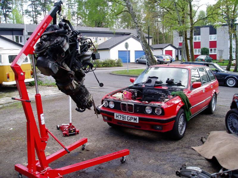

Oh whats this?! a 2.5! Relax its no ordinary 2.5 as it's come out of this turd!

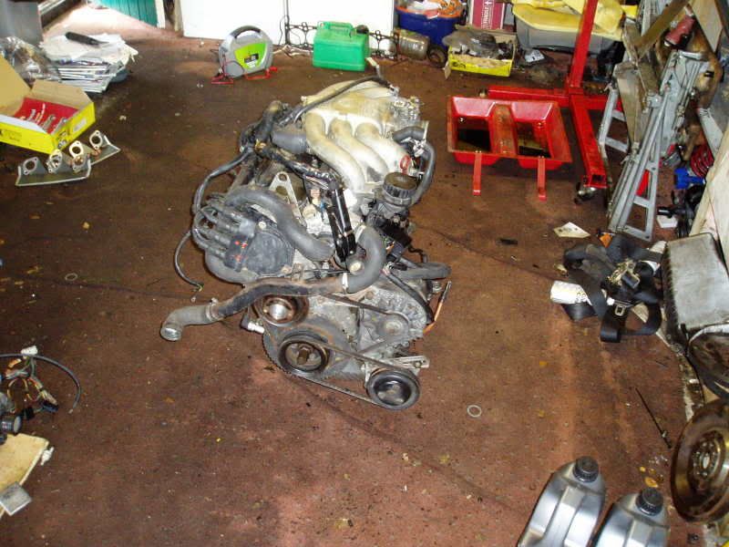

An Alpina 2.5 engine which was the 268/268 cam with alpina exhaust and a remapped ECU to suit good for 191 BHP in the day. It's covered a megre 115k and has been strapped to an auto box. It's in fine fettle after i've been near it! lol I've had the head off getting the camshaft copied. So all new seals top end, service items,belt, water pump bla bla and a good clean with a sump gasket to boot and all the other shite you do when its on an engine stand "while your there" stuff
Excellent service history and proof of alpina history to go with it also
I've attached a manual box to it from a tech1 sport with a new knuckle for the gear change, LUK clutch and lightened fly around 5.9kgs it is. I had to use the f**king manual propshaft from my 2 dr resto as the 320i one would go with the 2.5 parts but hey ho!
I did this last week in the evenings after work.
I've also fitted a 3.91 LSD so it's full 325i now bar the ABS, fitted some M3 lolipop bushes to tighten the front up

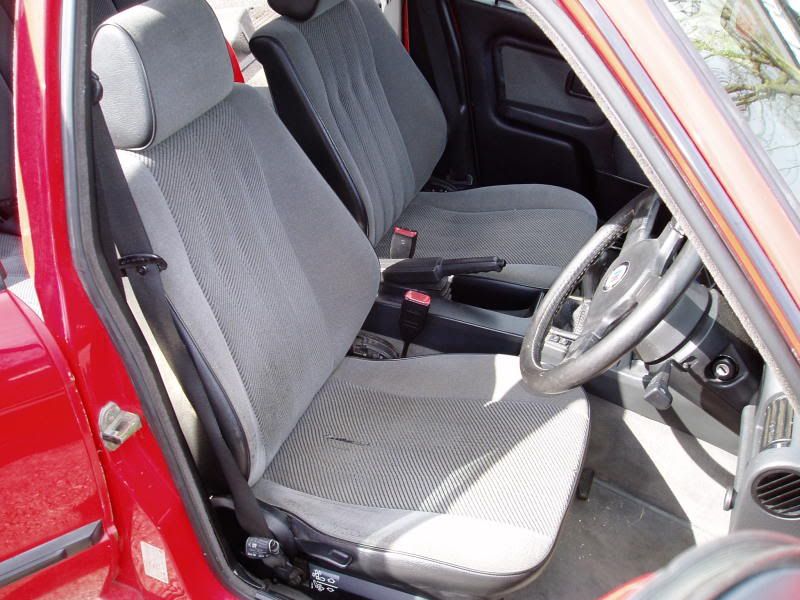

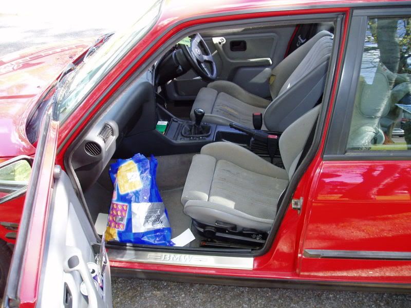

I've swopped the interior to this sports trim, which i've yet to finish. It's a bit scruffy at the moment and letting the car down but i'll get round to it
All done then basically and being used

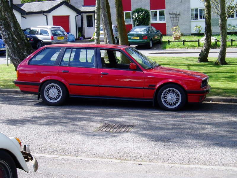

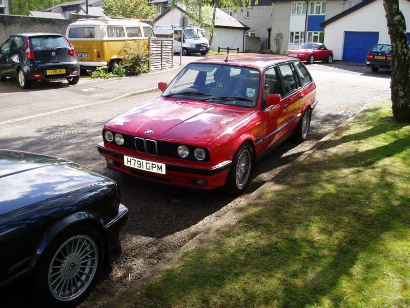

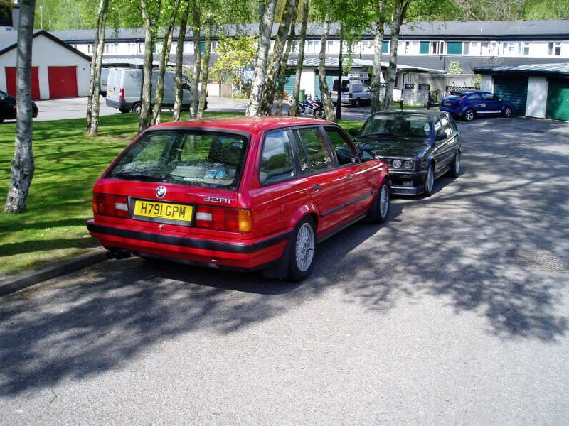

Great little car for a daily, it's on a 40mm drop what i couldn't tell you Dave knows! It rides nicely though
I've got alpina 7j rims and a front spoiler along with steering wheel, gear nob and badges all spare from the breaker to make it full C2 2.5 spec. What do we think?
I like it as it is in Grandad spec with mudflaps and 320i badge! No one trying to race you, so what do we think? Madness i know but.......its all good fun

That black 4dr engine donor is sadly very rusty, shame as dare i say it. It was the best looking 4dr i've ever seen or would of been 10 years ago when it wasnt a turd

Also i've had to remove the 2.5 engine, i've had the head off and dramas with GSF giving me a 320 headgasket and me only working this out when the head was torqued down and the engine seemed to be seized solid!
Throwing it in isn't the worst drama it is prepping for the time to fit that takes time.
I like 320i plain jane at the moment, i don't have the money to refurb the pina rims and get the spoiler painted red either
