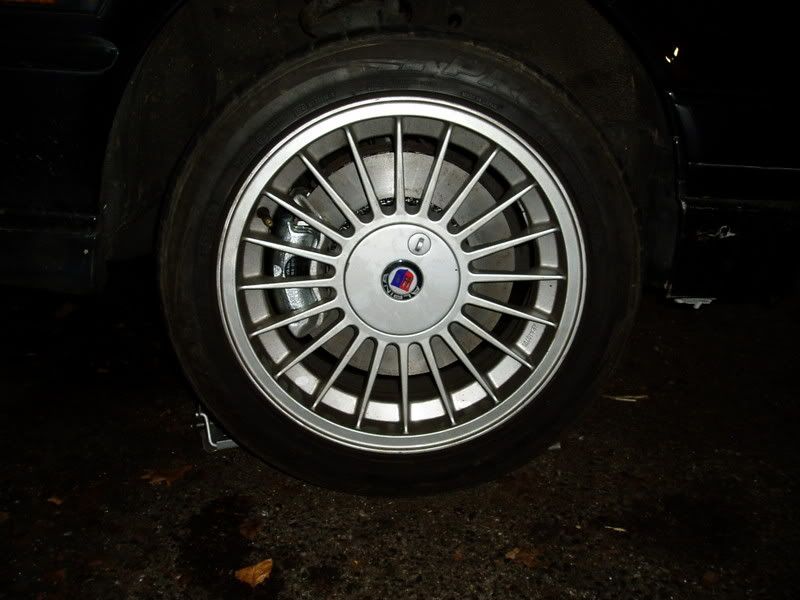

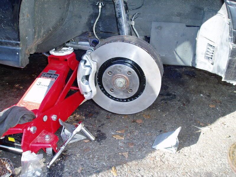

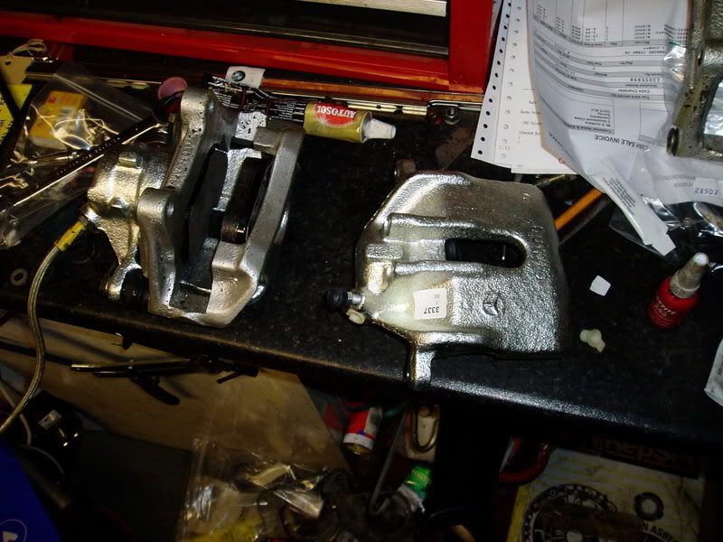

Also had time to get these fitted
Alpina big brakes

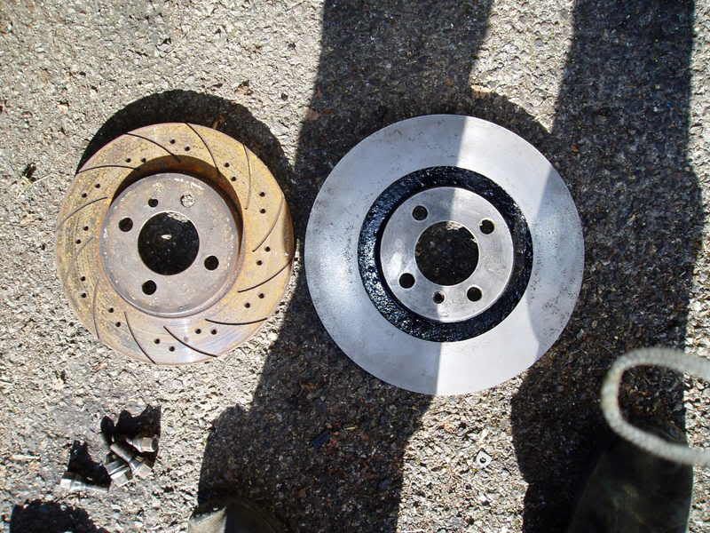

325 disc on the left
Looks great! Always had small brakes until now.
All i've got to sort now is the correct master cylinder and the brake bias valve and we are done on the brakes

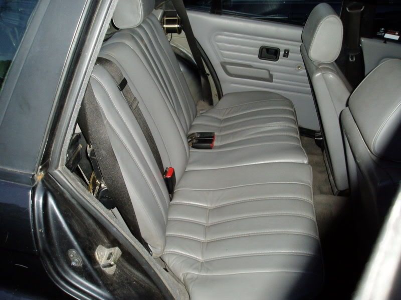

With the replacement fuel tank in i could get the rest of the leathers back in and 95% finish of the interior. IT's got that lovely leathers smell inside now

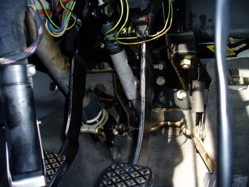

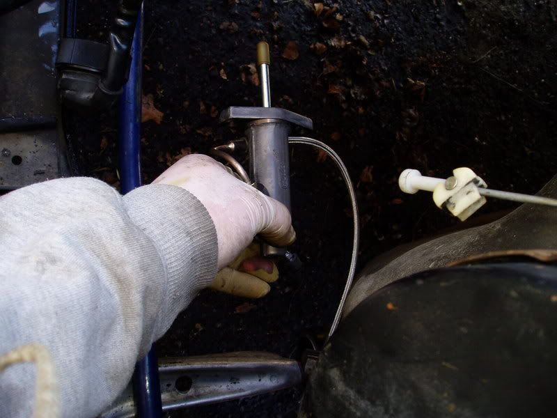

new clutch master, it was starting to leak and stain the carpet
New clutch slave also which was leaky with a new custom braided line also (Thanks for the line Si)
Alpina big brakes

What's the story behind the larger Alpina brakes? I've never heard of them never mind seen them before?
Are the discs and caliper alpina specials?

These where for the 2dr but if i'm going to the Ring this year i want to stop better with a 2.7 donk! I did a deal on these with Tomson a few months ago.
The calipers are big Merc ones! the caliper carriers are custom for the E30. As they are Girling/Lucas calipers getting one made up is going to be difficult. Shame as if they where ATE calipers things might be easier!
Discs are 296mm. And a 15bbs wheel fits over this lot too!

You can buy an alpina big brake kit from BMW still for £1200 plus vat or something stupid like that.

Not much different to some other big brake kits, all depends how it compares performance wise??Simon13 wrote:You can buy an alpina big brake kit from BMW still for £1200 plus vat or something stupid like that.

I reckon those brakes should slow you down niceley, what with all that extra weight, still the extra power from the tweaked 2.7 should even things out
