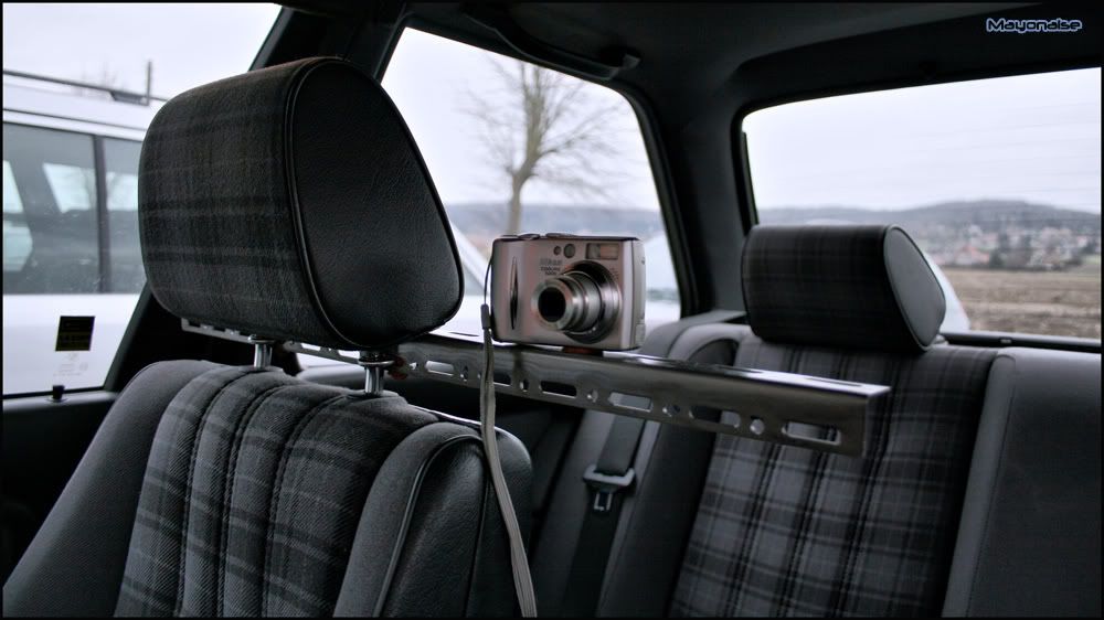

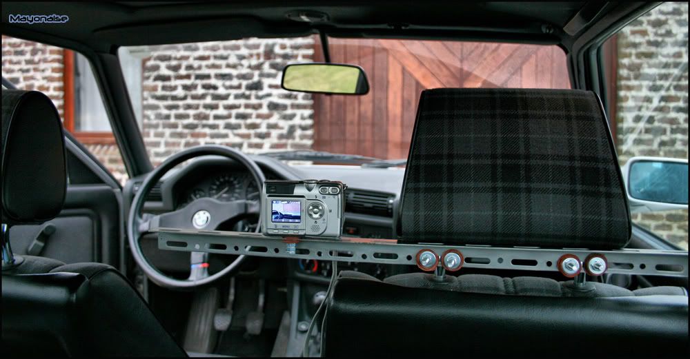

Made a new toy. :D
DIY Cruisecam. :cool:
Testvideo:
video link: (can't embed :o: )
http://www.youtube.com/watch?v=7_b0Cjy7uwk
Remarks: There is still room for improvement. I would like to change the angle between the camera and the horizon... Anyone a proposition?
Thanks for watching. 8)

Mon Feb 23, 2009 10:38 am
Do not crash it like that as you could end up with an L shaped hole in your skull :eek:
Get some hefty roll cage wadding around it, if it has to stay.
aj_mckay
Posts: 1782
Location: Winchester
Mon Feb 23, 2009 10:45 am
Malaise wrote:Remarks: There is still room for improvement. I would like to change the angle between the camera and the horizon... Anyone a proposition?
Since the mount looks to be an 'L' shaped piece of metal I would just bend the part that the camera mount is fixed to up or down to adjust the aim. Job done :D

I'd be very nervous of how far out that mount sticks, I wouldn't want it sticking into my neck. I lashed up a similar setup a little while ago:

Jon_Bmw wrote:Do not crash it like that as you could end up with an L shaped hole in your skull :eek:
Not a stupid remark i must say.... :)
Will do that! I have been thinking about cutting it a bit shorter to.
For the record: it's not for daily use, In 2min I can put it on/off the chair. :D
Thanks for the thinking, but I want a solution where I can change the angle over and over again, something that is easy to use. :D
(Changing the agle of the entire seat isn't a solution :o: :P )
Cut it as short as possible, you would be amased at how far you body will move in a rollover.
Sadly, when drifting with your camera mount on, this is the probably the biggest chance of you crashing into something. :mad: Even with padding it out, i'd still be slightly sceptical unless wearing a helmet.
Can you not relocate it to the rear parcel shelf or the dashboard somehow?

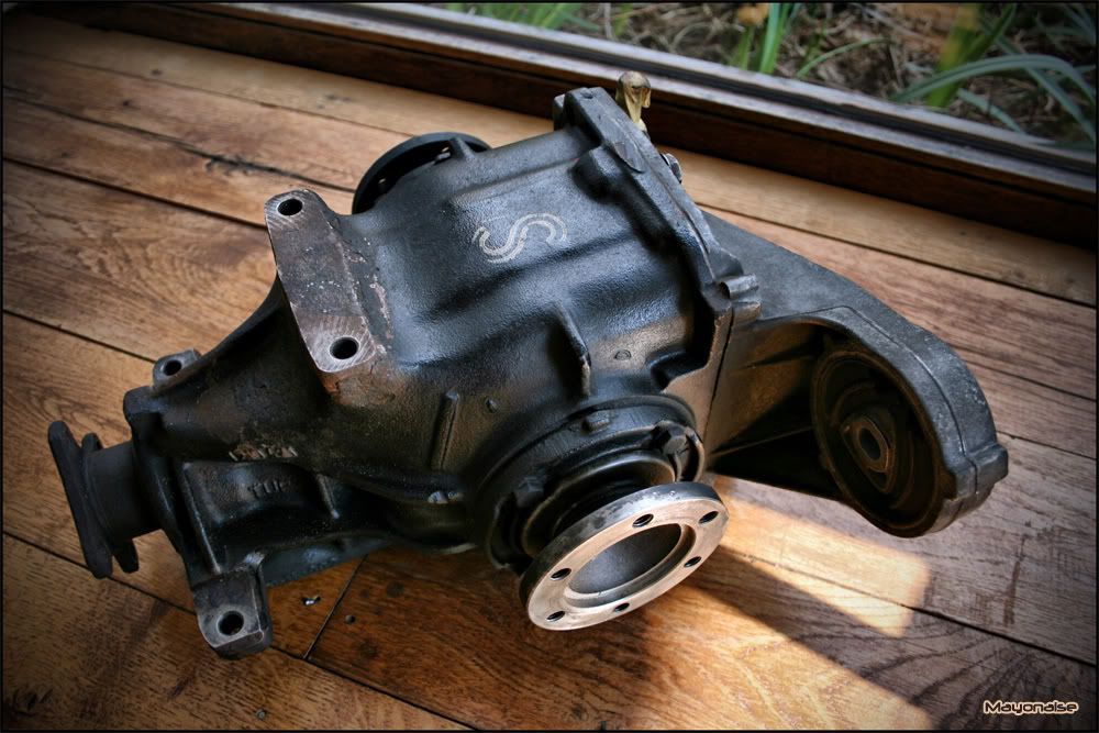

Thu Mar 12, 2009 5:48 pm
Like u can make up from the last post, I've made the flyest update 'till now...
LSD S4.27 :teehee:
Mounted since this weekend. (FULL CREDITS for Belgian thezone members Asserti & Soundstorm) :notworthy:
In +- 3hours the job was finished. :rock:
I haven't been able yet to do some tests in pooring rain, but the results in moistly road are already good. The 'normal' drifts are a bit faster, with bit less angle and the car is a little bit less able to get in unbalance in the usual way.
But.... clutchdump :o: now rocks ... bends are taken sideways from begin 'till end.... 8)
Sprint results are less impressive as espected. I hoped to be a little bit faster with the shorter 4.27 diff compared with the normal 4.10 diff. :(
I have measured sprinting results before and after with a Racelogic Performance box. (Thanks for using gTa (member aw-forum))
Sprints have taken place in same weather conditions / no passengers / gas tank full. Results in Km/h - seconds
4.10:
0-60 03.6
0-100 08.6
60-90 03.4
90-120 04.6
4.27:
0-60 03.6
0-100 08.6
60-90 03.5
90-120 04.6
Exact the same 8O except for the 60-90 there is the 4.10 even a bit faster :( (I suppose 90km/h isn't possible in 2nd gear with 4.27)
In 5th gear:
4.10:
60-90 09.3
90-120 10.6
4.27:
60-90 09.1
90-120 10.1
And now let it rain please. :D
