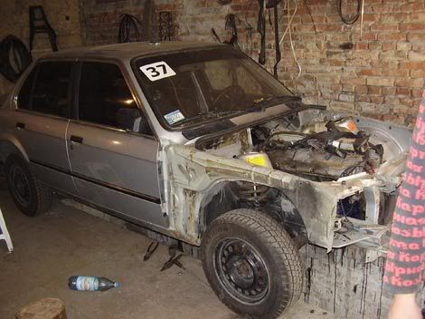

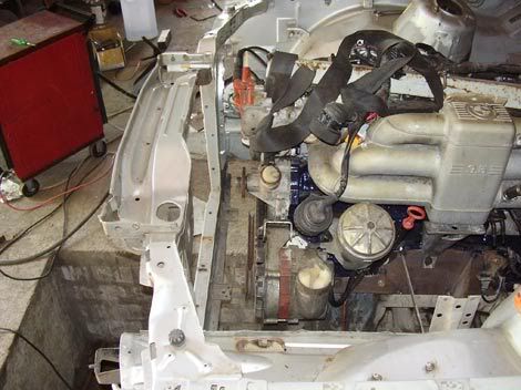

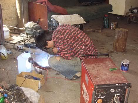

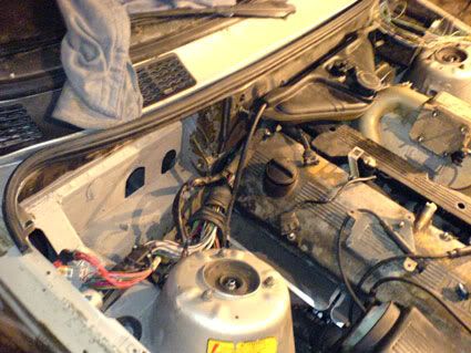

hello everybody. let me introduce my BMW.
abs from e34
p.s. my english is not perfect, and its difficult for me to write all tehlical aspects. but I'll try to answer for all questions )))

Welcome to the Zone! Car looks a proper sleeper with the steelies 8)

you need a lot of work to do.
1. you'll need engine and gearbox
2. radiator from 535 e28
3. the fan of the conditioner from e34 or e36 instead of e30 on the water pump
4. custom made engine paw.
something like that
brakes from 325(minimum) better m3[/img]

there would be a problem with oil pan, and oil pump (you'll need e32/e34)

cardan from 325 (mechanic) , tail of gear box from 325, flexible muff from 325...
2-nd year works properly

Isn't there also an issue with a water pipe on the back of head (E28) and the exhaust manifold fouling the bulkhead for the 335 conversion??
BMW_3xx_i, project is looking good :thumb: what plans do you have or are you going completely sleeper style (if you understand what I mean?) Do you not have problems with the E34 coolant overflow hitting the bonnet??
thanks for remember, it must be removed
the best donnor for 335 (as for me) is e34

one more thing... I've cut the battery platform (easier to change spark plugs of 5 and 6 cylinders)
no problem with coolant and temperature
charlE30 wrote: and the exhaust manifold fouling the bulkhead for the 335 conversion
sorry can't understand
