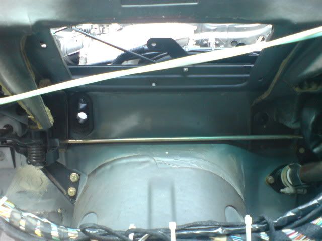

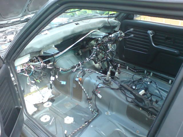

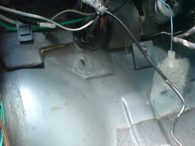

Due to another leak (not found yet, but not rust this time) i have had to take the carpet out again. At least i can shampoo it properly again to get rid of the mess from the bodyshop.
Lots of waxoyl

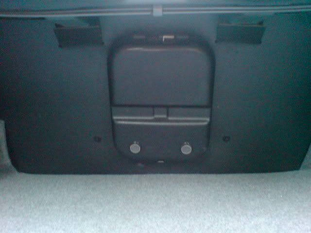

Unopened first aid kit, mint warning triangle, bbs wheel spanner, full tool kit, battery storage tray, wheel chock etc
Not very interesting i know!

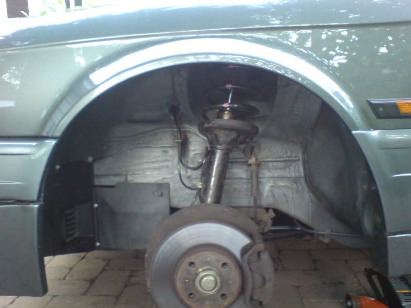

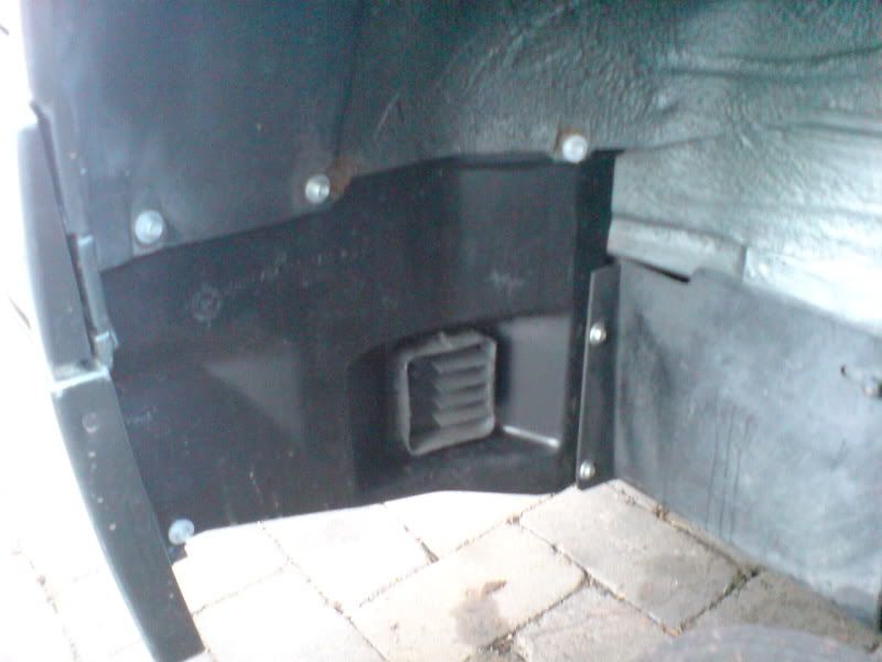

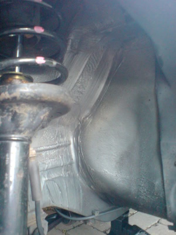

Insides of wheel arches after 2 cans of stone guard and a can of lacker - should last a few years

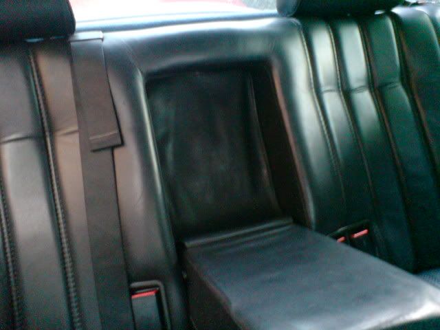

Replaced the rear bench with the correct armrest type. Then the armrest part turned out to be broken so I got hold of another and swapped the leather over.

Re-laid carpet after checking the leak had stopped!

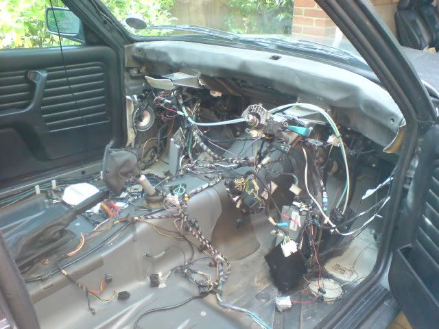

When I had a lot of the body work done last summer, I never removed the dash to fully check the bulkhead, so I stripped out the inside (again!). Luckily there is no rust in sight whatsoever, not even under the sound deadening. I stuck my head inside the scuttle and again not a spec ”“ result.

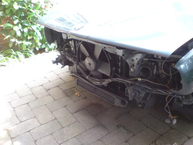

While the dash was out it was a good excuse to load the car with some more extras, so I fitted an air-con heater box, cruise control set up, and a 13 button OBC. I re-did all of the loom tape using proper cloth based car loom tape ”“ this takes ages (!) and routed all the wires in the factory harnesses. I then fitted a nice crack-free dash in place. Fitting a new heater box seal sorted out my ongoing nightmare leak, which I won’t miss.
I took lots of pictures along the way while I fitted the air-con, with the intention of writing a fitting guide for the zone, but most of the pictures got deleted on my old laptop annoyingly. I basically bought every bolt, nut, washer, and any small part for it new ”“ about 50 little bags of bits! I also bought a new air-con radiator and condenser from euro car parts, and would recommend them to anybody ”“ great quality. I also bought the R12-R134a conversion kit from BMW, and re-did the wiring to suit, again using cloth loom tape.

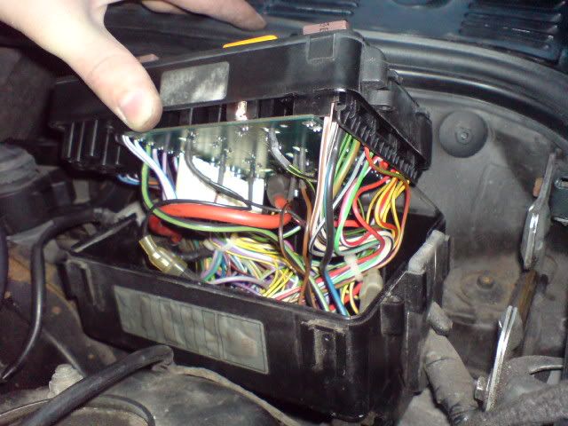

This is the only picture I have of the air con! Wiring the loom into the fuse box:

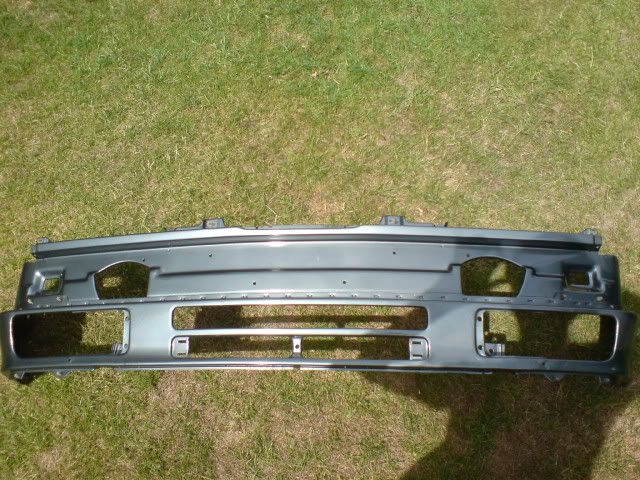

To finish off the air-con I bought a fairly new air-con front valance (cheers Barry) and had it prepped for tech 2 kit and sprayed (Candy Automotive ”“ I would recommend them). Also fitted a nearly new kidney grill.

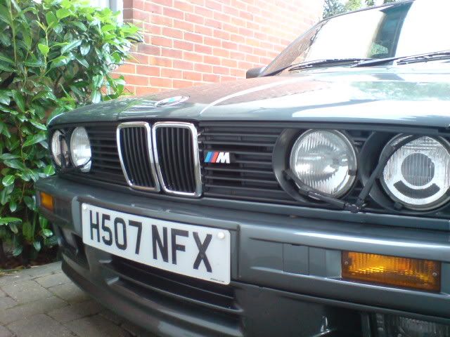

Next I re-built my headlamp units (not the actual glass, but the frames/setup). I then re-built the wiper motor units for the headlamps, and fitted new valves etc to the cleaning system. Headlight washers and wipers now work perfectly. Also re-vamped the main cleaning system, and bought a new washer bottle and valves.

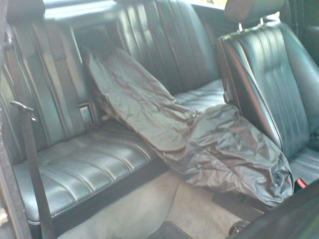

I bought this E30 ski bag, something my car came with from new, but must have been lost at some point. This black panel folds up when you push a ”˜button’, and magnetically sticks to the boot roof.
In the car, unfolded.
All tucks away behind the armrest leather flap.

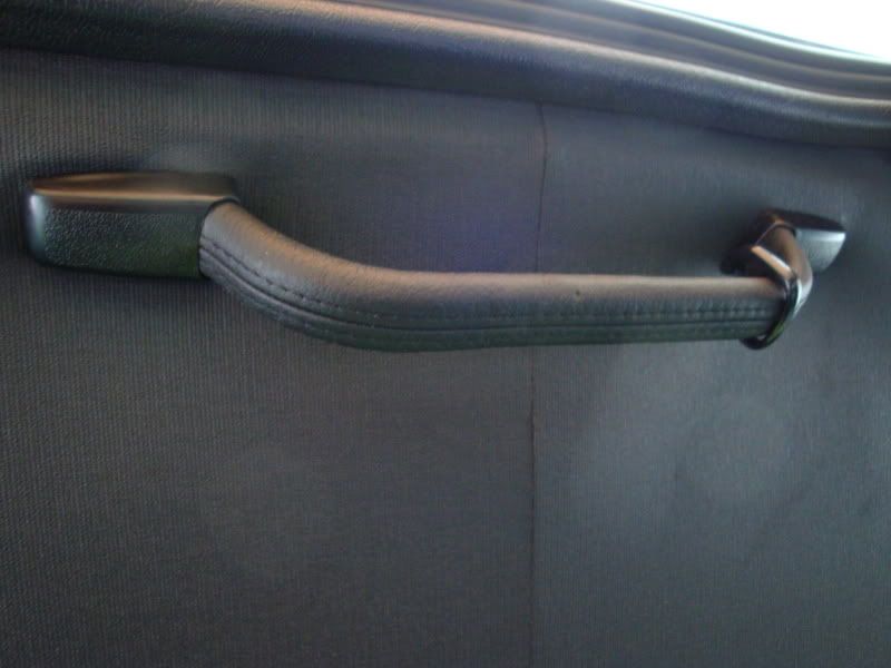

Got some leather grab handles. I’m convinced they are OEM, although it’s the only set I have seen.

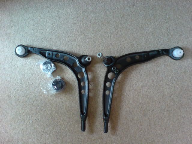

Next onto mechanics. The front of the car needed a bit of an overhaul. So, I replaced:
- Complete steering arms
- Control arms and bushes
- Drop links front and rear
- Rear disks (again, warped one)
- Front shocks for new m-tech ones
- Some very good, not much rust, front struts ”“ cheers Ant
- Fitted a set of the correct original m-tech springs ”“ almost new ”“ still with BMW stickers!
- Also bought new bits of plastic trim in the arches.

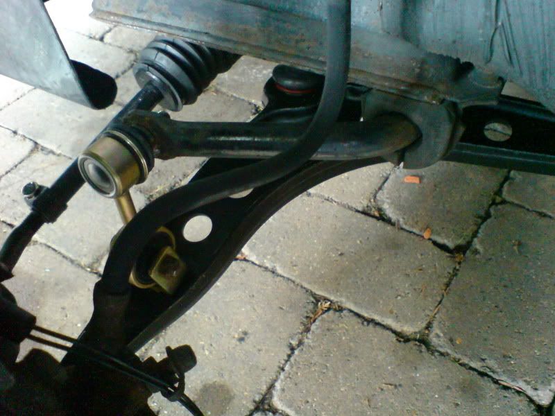

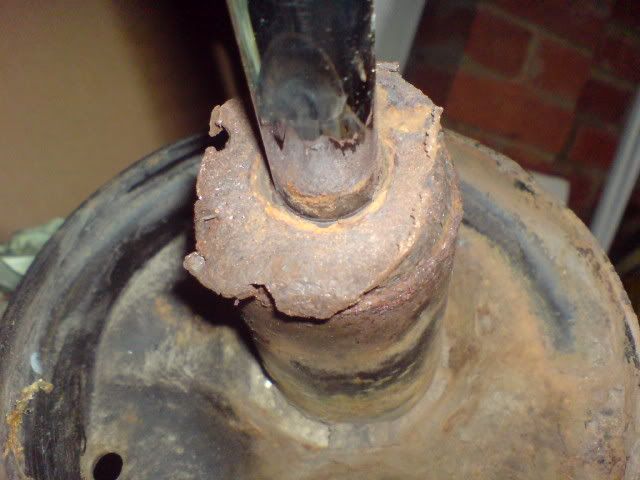

Note the new locking rings, with lots of copper grease around the top this time (its not rust!). New bump stops etc also.
Getting the old shocks out was impossible thanks to this locking ring (yeah, it’s fooked)
Hence getting replacement struts and locking rings for the new shocks.

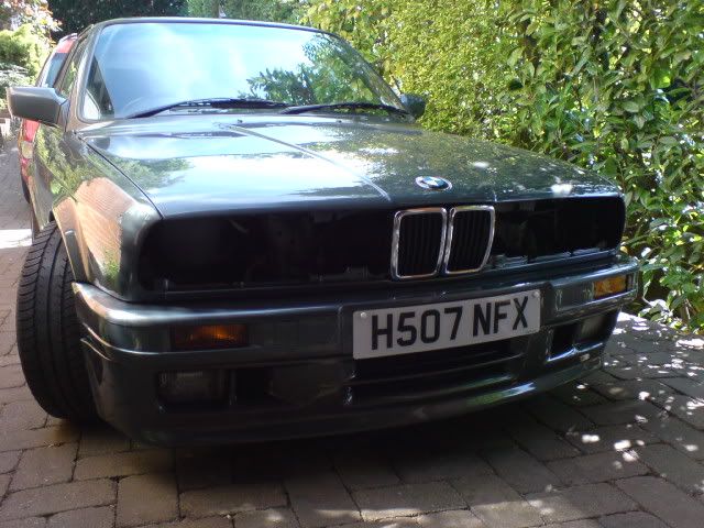

Right, a little update. Over the last couple of months I have done a few things here and there, so thought I would post it up.
I gave the carpet another clean, and re-fitted the interior.

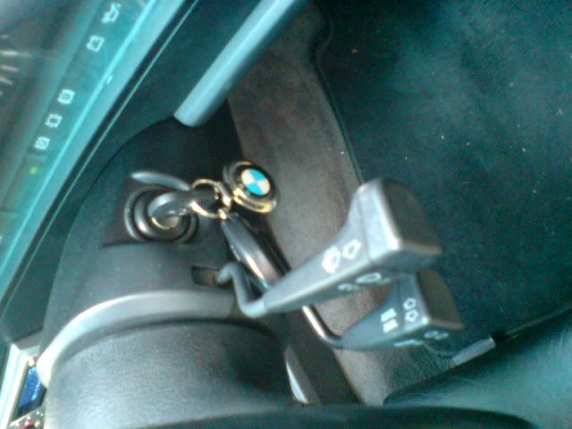

Next job is to use a Schultz gun to spray this BMW original underseal over the underside of the rear half of my car ”“ it’s not rusting, im just not happy with the thinner stuff I used last year.

Sorry I never replied! It's probably too late now, but I used the aerosol stuff, but I don't recomend it - its not thick and tough enough, hence im about to re-do mine with the schutz/bmw stuff. You need a schutz gun and compressor to apply this.bmwsport wrote:Just had a look on the hammerite website, you can get it in schutz or aerosol form, which one did you use? It also says overpaintable with most topcoats, i don't suppose you know if that means you can paint over it 'if you want' or 'you have to' paint over it!? The last thing i'd want to do it spray the entire underneath and find out its porous like primer or something![]()
It does not need to be overpainted, and is not at all porus. Painting it just makes it look better.
