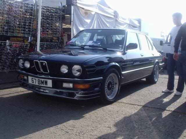

Malc, I hope for the alpina's sake he doesnt get anywhere near one
