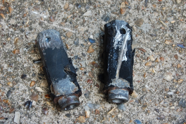

Ok, we got the subframe off. The bushes were so far gone we put a bush puller on them and they popped the centres out. Good points - the subframe is off. Bad points - the centres of the bushes are still frimly in the car!
Managed to get the rest of the old bush out with fire, and ideas how to get the centres out? They are well stuck.
Some pics:
Fire!
Stuck centre
Subframe
James

Snap 'em off and drill out what remains! When they're stubborn, they really are stubborn.

Try a 3/8" extension bar in from the top, then whacking the protruding end.
They tend to snap off in the end, worst way, leaving you to drill the remnant out.

Yes I just set fire to the old bushes with a blowlamp - a few minutes of flaming and they practically slid out!
The f&*$ing centres are still in the car! I tried this evening wrapping it with plastic and tape, and filling the hole from inside the car with parafin and leaving it to soak for a bit. Made no difference, still stuck fast :cry:
Its beyond funny now!

Got the bastards out at the weekend!
Wrapped a wet towel around the petrol tank and heated them up with a blow torch, then sprayed with cold water to give a bit of rapid cooling. A couple of sharp taps with the hammer from above and out they popped.
