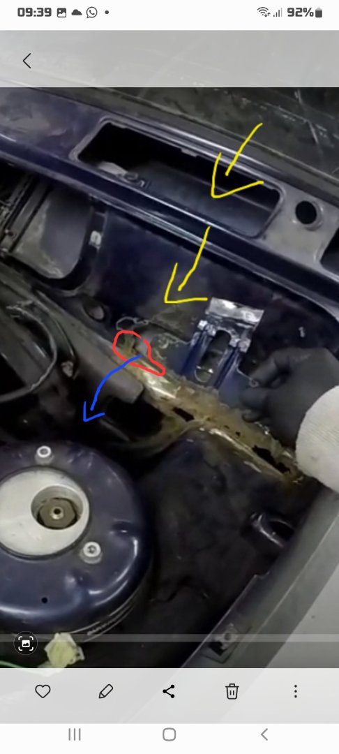

I've added a picture which kinda shows my issue.
The water enters via the scuttle drain (yellow arrow) and down into the scuttle gulley.
There's a hole about the shape of the red area to the lower left of thr fuse box. This is where the water comes out from the scuttle drain then runs down the bulkhead (engine bay side) blue arrow thrn comes in where there's a small grommet which I've used tp route my brake pipes now that the servo lives in the cabin.
I'm still going to have to remove the fuse box to make this repair though so same procedure really which is shit lol.
And I'll definitely make a cut in the loom where he has and leave the back half in the car and rejoin after
