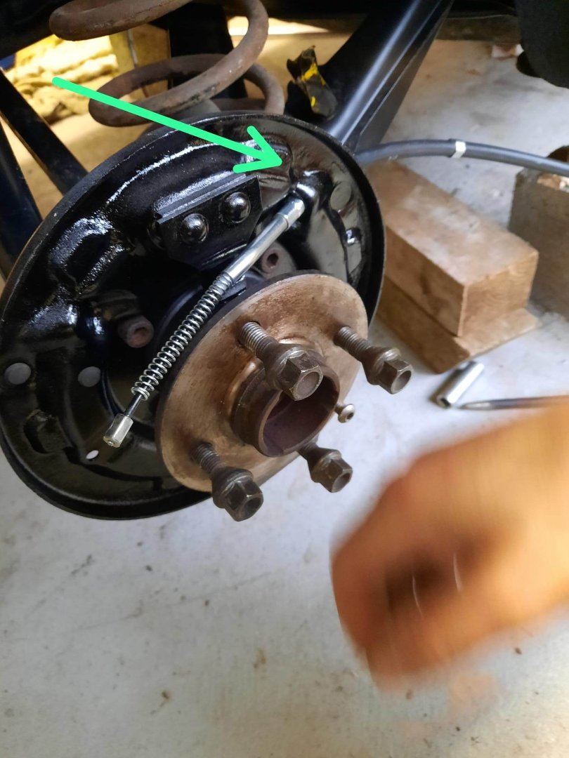

Hi,
I've been restoring the rear axle of my 316 (carburettor model from 11/1987)
A couple of weeks ago i took out the old handbrake cables and threw them away, but apperantly there is a ring or a clip there where the handbrake cable enters the dustpanel (arrow on picture) But when my new cables arrived there was no ring or clip delivered with it and i can't seem to find some on internet. Anybody has an idea what clip/ring i shoud use and were i can order it ?

Realoem is your friend :D looks like #12 here,
https://www.realoem.com/bmw/enUS/showpa ... Id=34_0344
Part number 34411153126, should be available new from Cotswolds or your dealer, some on ebay but usually pay more there :thumb:
