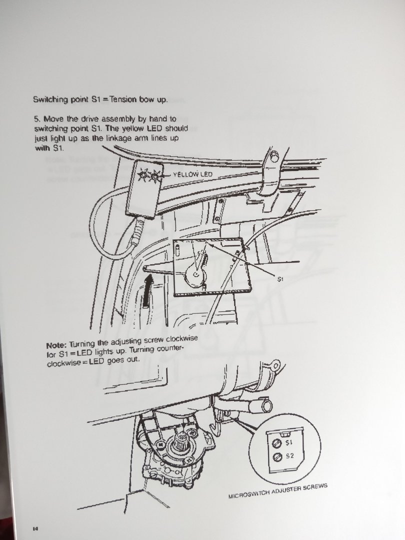

I hope this helps people and if you want the pdf then pm or e-mail me .
e30@sky.com
Cheers Mart.
