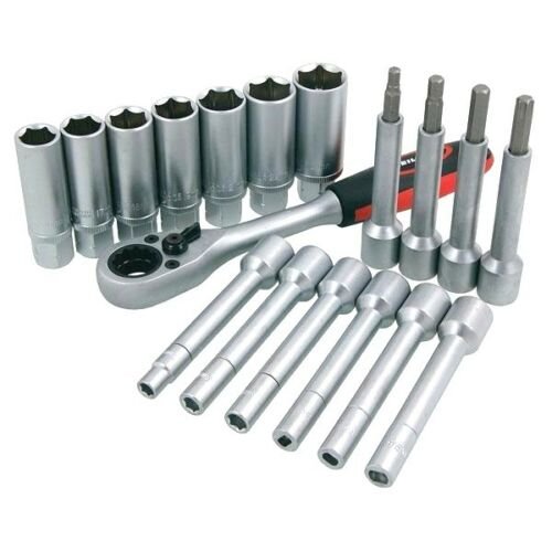

Like I say, not familiar with spannering a Cab but can you fit the top mount to the shock absorber first where you have better access and then fit the both to the car? Just leaves you the two nuts per side to do up.
There is a proper tool for the job but where is the fun in that :D
If you fancy cowboying the job a rattle-gun will also work
