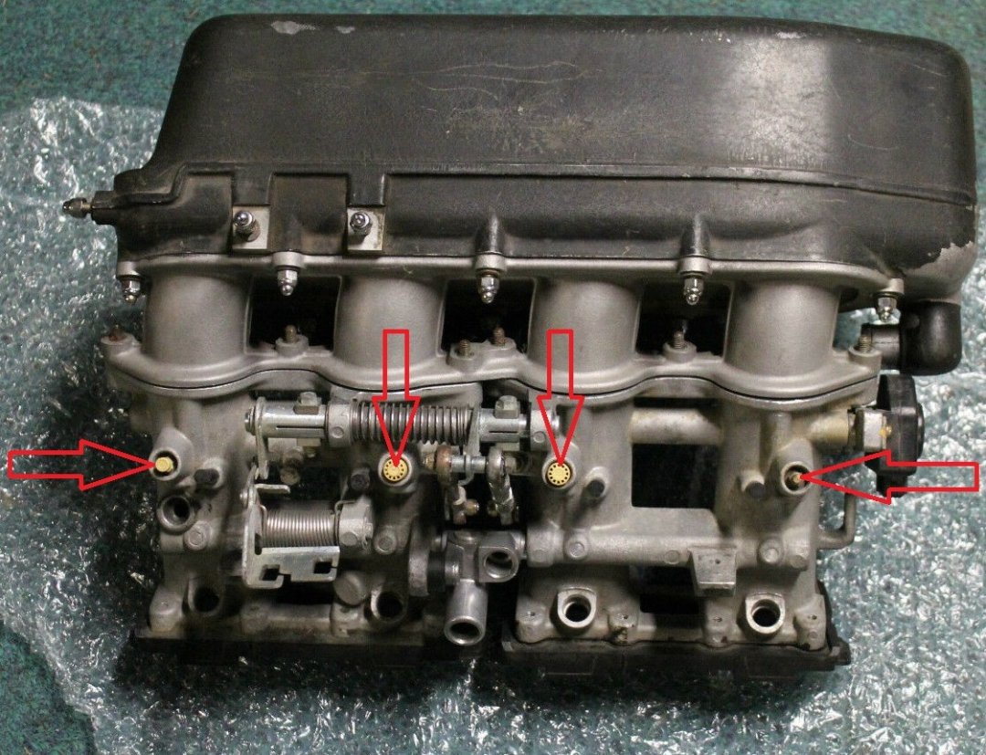

Hi All,
Anyone able to shed light on the Throttle screws on each throttle body / intake on the E30 M3 S14 engine? Part # 13541402567.
1988 E30 M3

They seem redundant but are maybe used for tuning the engine?
Any hints gladly received as the car is nearing return to the road and I want to set the engine up as best as possible.

Photo of the screws in question
1988 E30 M3

Those screws are used to balance the individual throttle bodies. If you do a search for balancing ITBs on S14.net there is plenty of info on how to set them.
