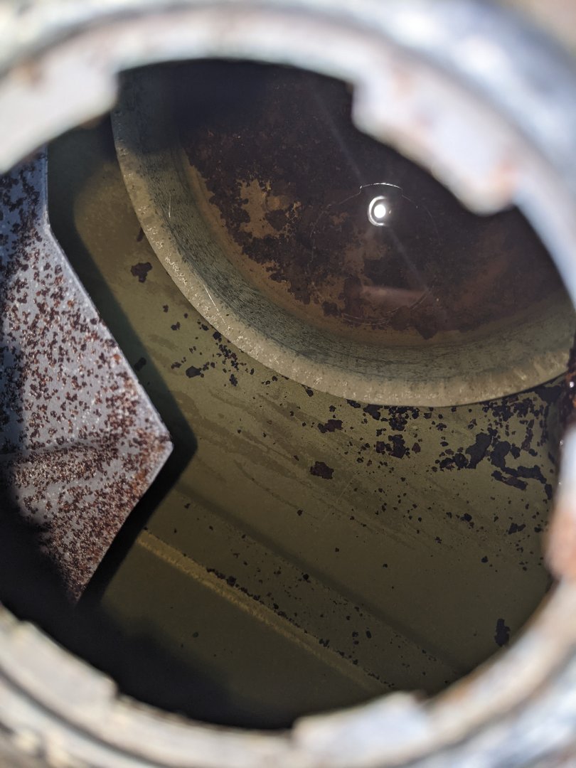

Replacing the fuel pump today. Took it off and saw the bit with the pipes quite heavily corroded and some rust inside the tank itself. The connectors for the lines look clear though (inside and out)
Any cause for concern? Should I just clean it up and stick back in?

The pump does have a filter within it and also the fuel line should also be present so they should protect against any physical contamination . But looking at the amount of crud what is the condition of the tank itself ? That could be a potential for a much bigger problem .
See pic above mate
See pic above mate
Yes seen it , difficult to tell due to the small aperture but that's a lot of rust just off the pump holder so its quite possible the top of the tank is the source. Tanks can be cleaned and treated but to do it properly/safely then it should be removed and then you need to weigh up the cost and effort to cleaning to replacing , there are after market tanks out there so you have a few options

Quite possibly the result of the ethanol contaminated fuel foisted on us for the last few years.
