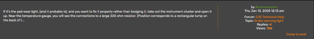

I managed to get it off briefly but when I took the instrument panel out again and put back it turned back on. Deffo a connection somewhere. Couldn't locate it so far but have unplugged bulb as need MOT done today. Going somewhere else and hope it passes.

It does sound like the resistor problem. Sure you soldered the right joints?

Have you checked the soldered joints of the blue and white sockets are soldered to the main circuit board? They're not a weak point, but if someone pulls on the plugs hard enough...........
