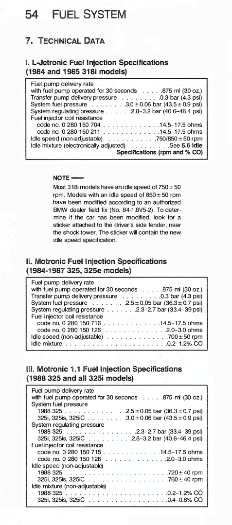

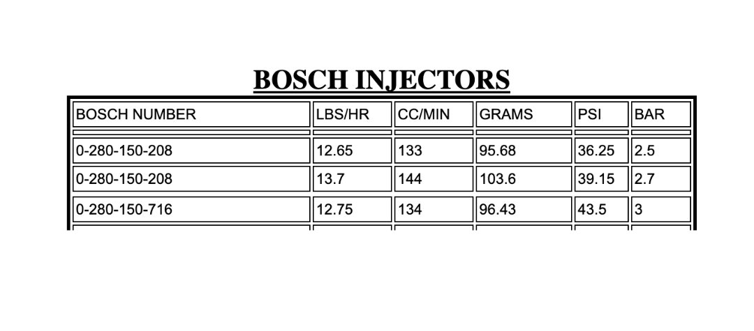

After doing a bit of research I found this technical data for the two injectors.
Looking at this data it would seem that they are fairly closely matched, with the the only difference seeming to be .5 BAR of pressure in the spec.
As far as I can tell both have EV1 type connectors.
Myself being from from an expert on injectors was just wondering if any peeps could chime in with some advice on whether the newer cheaper version would be suitable or recommend a possible alternative, or maybe just steer me in the direction of getting the ones I already have restored...
