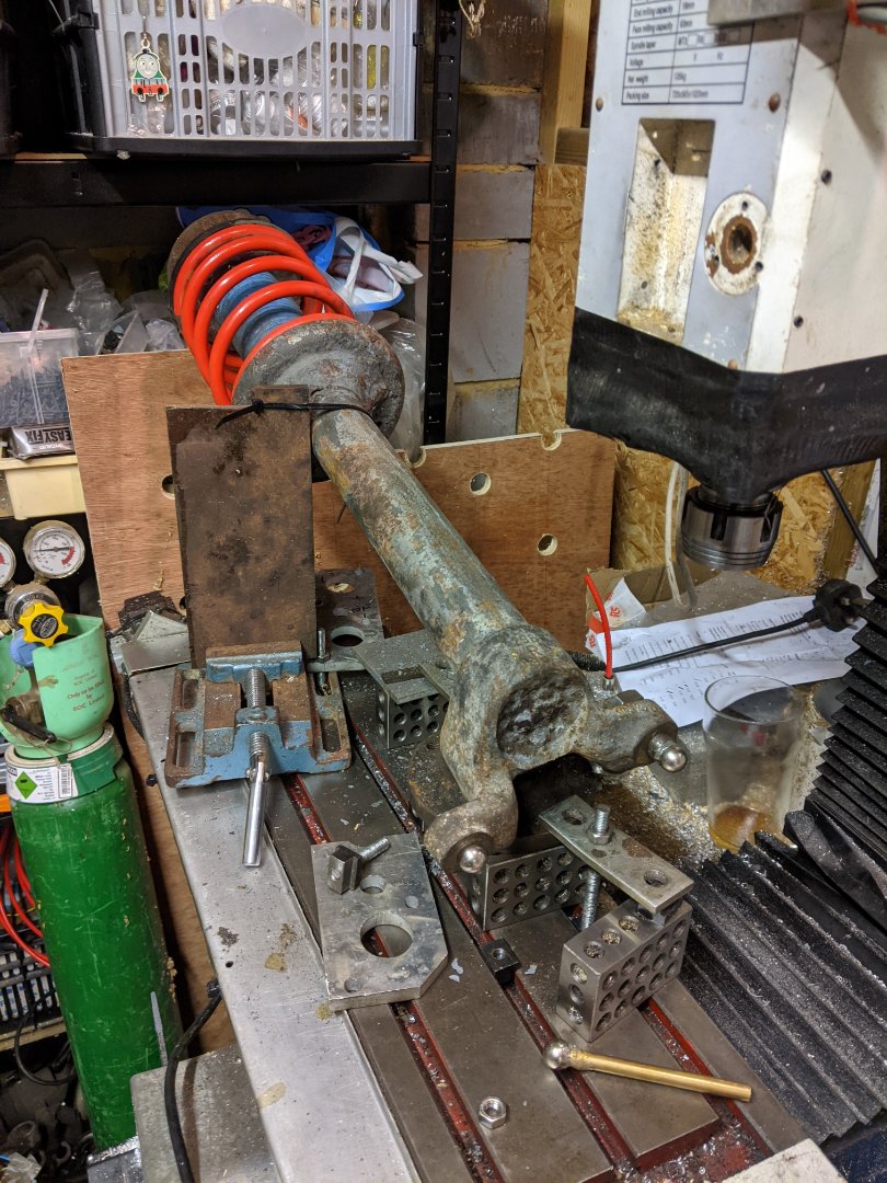

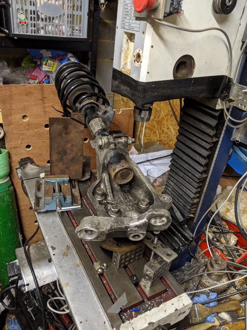

As a starter for ten, I clamped both struts to the bed of the milling machine. This puts the mounting face of both hubs on the same plane.
The good news is that the strut tops appear to be at the same height. This is just eyeballed so needs more careful measurement.
What it might mean is that just the mounting to the wishbone and track rod needs modifying.

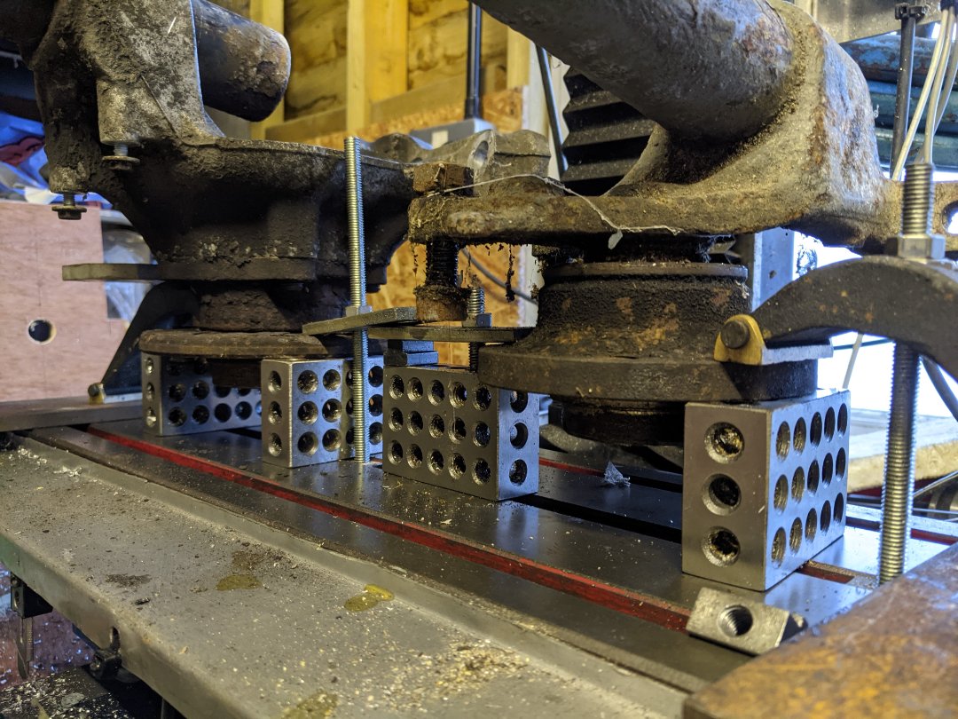

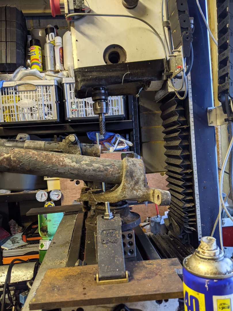

Spent some time measuring today, like all things,takes longer than you think!
Made a high quality probe by gluing a ball bearing concentric with the mill collet holder.
Then used a combination of the probe and the clock to take measurements.
Popped some bearings in the taper openings of the track rod end, measuring these in X,Y and Z means I can plot the axis of the track rod. Need to find bigger balls for the wishbone though.
Next up is plotting all the points in CAD.
Lot of the measurements are offset by the diameter of the probe, hopefully I've got enough data to make a good start!
Might have to cut up an old wishbone so I can accurately position the centre of the joint.

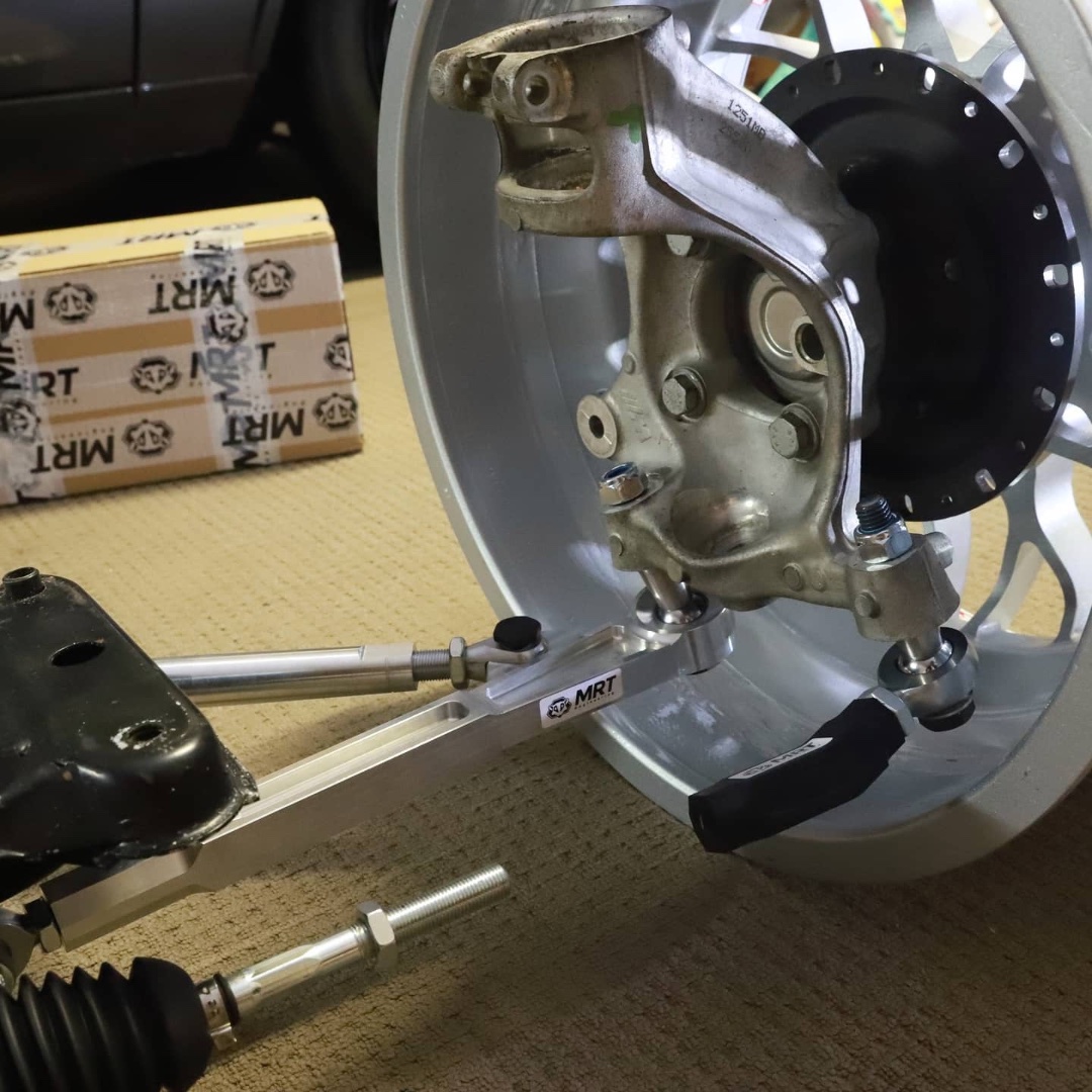

I noticed a post a few weeks ago which was going down a similar road using some Group A style arms,
I think both the E90 ball joints are larger than E30 from memory so an insert would be a good way to connect the hub to the wishbone, E46 track rod ends use a larger ball joint (may be the same size), combined with the rest of the track rod this can be bolted onto an E30/E36/E46 rack

Ah has, great minds think alike!
They've got E90 M3 knuckles there though which cost M3 money! :LOL:
They must have moved the wishbone ball joint towards the centre of the car by a good amount to avoid insane amounts of camber with the setup pictured.
Would love to see the rest of that thread.

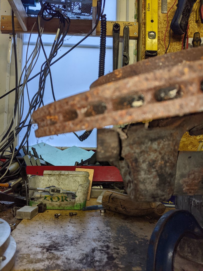

So using the mill as a CMM is a new game to me, and like all new games it takes a bit of practice!
Decided to make the fixturing for the strut more rigid and take all the measurements again today.
Also made a pin with a sphere on it so I could find the centre of the wishbone ball joint axis.
Took lots more measurements today too in the hope of pinning down the geometry more accurately. Ended up with 64 coordinates to plot in the CAD.
Overlaying yesterday's and today's models, some key things are reassuringly similar, but one is miles out.
The top of the strut where is would affect camber is about 0.8mm out, which equates to about 0.1degrees of camber.
Fore and aft it's about 9mm out but yesterday's measurements didn't account for that very well.
The track rod lines up to about 0.2 which isn't too terrible.
However, the wishbone is miles out.
Yesterday, I just eyeballed that measurement whereas today I made a datum to measure to so hopefully that's the smoking gun!
Grey is yesterday's model, white is today's.
Plan for tomorrow is to double check the wishbone setout then put the E90 strut on the machine and probe that followed by CAD and overlay.
Plan A is to investigate whether the bottom of the E90 upright can be machined off and an adaptor which replicates the E30 geometry be bolted on the back, hopefully using the hub bolts.
Plan B is entirely new uprights!

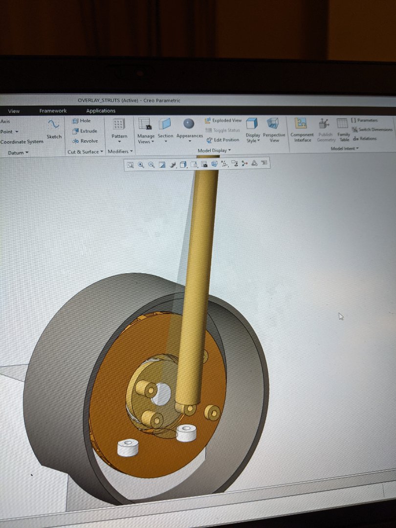

Solved the mystery of the out of place mounts, had accidentally offset them twice, glad I checked!
Probed the E90 strut today.
And built the CAD model to overlay with the E30 strut.
Good news is that the camber looks like it should be about spot on! The tops of the struts align almost perfectly! White is E30 and transparent is E90.
The ride height is about 7mm higher using the E90 strut, but that's compared to the E30 with a 40mm drop so should be okay I think.
The less good news is that I can't use F30 discs as they're set back too far. Shame as the 340mm ones would have been ideal!
Next closest is the E46 330d with 325mm discs. Much shallower, but still clash with the track rod unfortunately.
Made a crude wheel to see where that sits, would have just cleared the E30 strut, has miles of clearance to the E90.

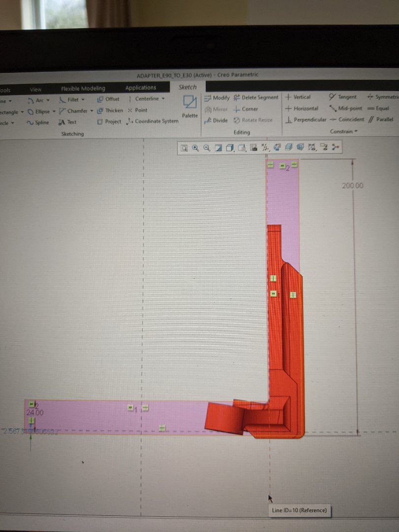

Going to look at using two piece discs and hats to get around the disc and track rod problem next.

Old school fitting & machining - I like it!Turbo-Brown wrote: ↑Mon Dec 28, 2020 5:46 pm
Pfffft - who needs these fancy Coordinate Measuring Machines...

Reason I've referenced everything to the hub face and axis is that I can faithfully replicate the E30 geometry that way.
Basically, I don't want to move any of the mounts with respect to the hub so the strut top, wishbone and track rod end all ideally want to stay where they are.

Mini Paceman (whatever one of those is!) to the rescue!
Has 307mm discs and pulls the disc about 8mm away from the track rod end.
Turns out my model for the E46 disc is a mm or two out as in reality it doesn't clash.
Remembered how much I love these wheels too!
Excuse the crap model, I mapped out the back of the spokes to see if the calipers fit. Might need a 2mm. Spacer possibly.
Also trawled the internet for other cars with 5x120pcds, decent sized discs and the right kind of offsets....

Lots of CAD work today.
Whilst the Mini brake discs do appear to fit, they're really heavy at almost 8kg so have decided to go with Wilwood discs to match the calipers.
The Wilwood discs are about 4kg and my bells are 600g so big weight savings to be had!
These discs are about 310mm diameter and about 20mm thick which means I don't need any spacers for the wheel now.
Discs are about £40 each and material to make the bells is less than £35 for the pair so comparable costs to the Mini discs overall which is a bonus.
Had a stab at the adapters for the uprights, will do some FEA on them, but I suspect something like En24T or S275 will be more than up to the task. Will certainly be able to optimise the design for weight, it's around 1500g at the moment.
Red thing is the adapter.

I wouldn't trust my welding or casting for such a critical component!
Looks like I can make from stock 200x200x24 angle, so S275 grade which should be plenty strong enough!
Minimal waste too as my adapter is L shaped.
My mill isn't backlash free enough to make the tapers sadly, I'll have to measure the taper and either make or buy a reamer. Will step drill or interpolate to clear most of the material then ream to size.
