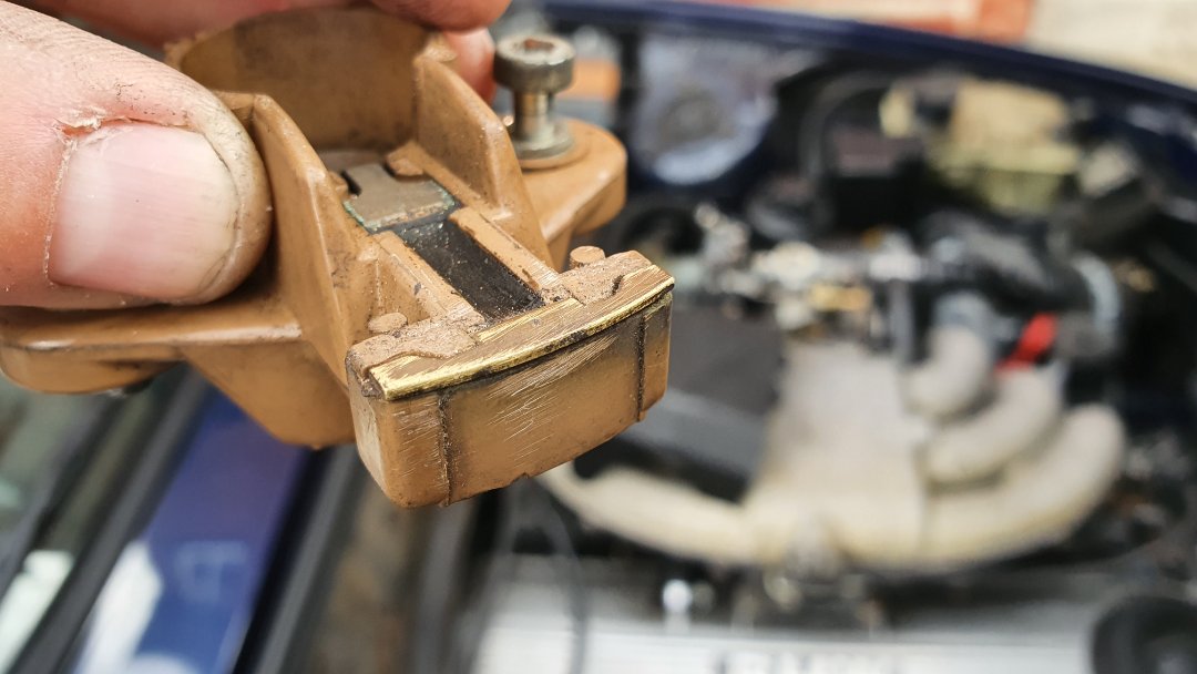

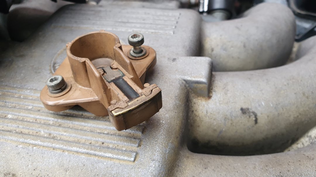

Had a quick half hour on the car.
Photos of the cap and rotor below, the carbon button is present and moving freely on the spring. I can see a clear shiny spot in the centre of the rotor arm where contact is there.
Cap not exactly new but was working beforehand.

Post Tue Apr 07, 2020 5:53 pm
Mine had such a small tracking line it was almost imperceptible. In fact until I replaced it with a secnd new one that cured the problem, I would have sworn it was ok. It doesn't take much for tracking to happen. I think, from the photos, it would do no harm to change the rotor arm (worst case scenario is you have a spare if it proves not to solve it.
