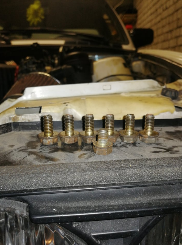

Post Tue Mar 10, 2020 6:13 pm
okay so i figured someone in the future might come here searching for the same thing, so here it goes. all of my headache was caused by 6 bolts that hold the trigger wheel in place. The engine i bought came from an e34 which had AC, so obviously it had one extra wheel to run the ac so the bolts were longer. Now i just need to replace the crank seal that was broken because of these bolts and should be good to go. Shorter bolt for comparison came from my old m50.

Post Tue Mar 10, 2020 8:08 pm
This is exactly the scenario that DanThe was suggesting.
