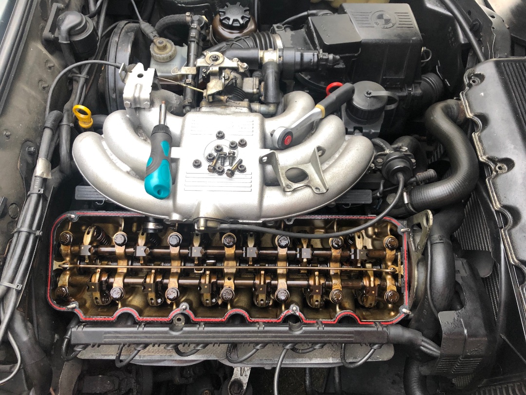

Hey guys,
Little update on this one. Did a valve adjustment today - some had zero clearance some were loose. Changed them all to 0.25. Wow perfect idle. It’s never run so smooth.
Worth a shout if anyone is having a bumbly idle, that isn’t super erratic just annoying.
Very happy
Very happy

BristolE30

Brianmoooore
- Posts: 49360
NOT a good idea to park those nuts there! Oil drain holes in the head are big enough for a small nut to go down. (I know from experience.)
BristolE30
- Posts: 532
- Joined: Thu May 16, 2019 7:43 pm
- Location: Bristol
It’s okay I was careful lol. Will remember for next timeBrianmoooore wrote: ↑Sat Dec 21, 2019 6:28 pmNOT a good idea to park those nuts there! Oil drain holes in the head are big enough for a small nut to go down. (I know from experience.)

Really scratching my head now. I’ve noticed the AFM has been dismantled at some point in its life and the cap is missing from the adjustment screw, so some PO has probably had issues. Do think it’s worth me ever so slightly tinkering with the adjustment screw when it’s warm to see if smooths idle out? I know I don’t have all the equipment to measure emissions but figure if it makes it worse I’ll just adjust it back..
Appreciate any thoughts
