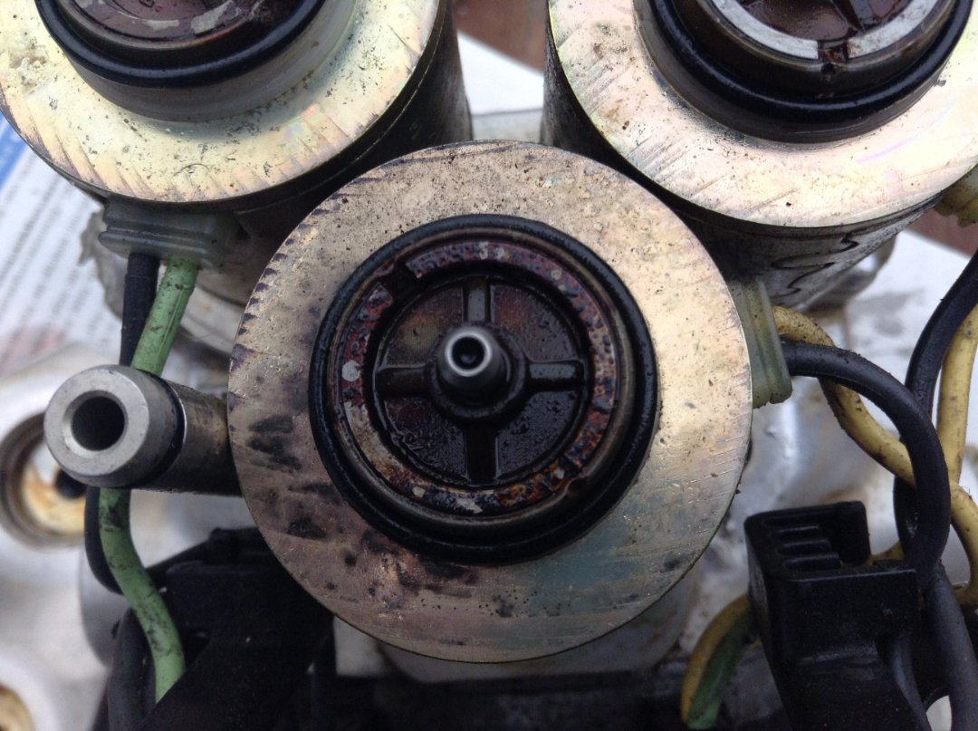

well i finally got round to trying your method paul, (been laid up with a dislocated knee for a few weeks)
& the outcome is it looks like his abs pump has seized,
the fluid is going into the abs pump but none is now coming out the other side,
at first thought the seals had gone in the M/C due to using the pressure bleeder, took the M/C off & bench bleed it, all worked fine, so made up a couple of new lines direct from the M/C to each corner & surprise surprise, fluid came out each corner using the two man method.
so i've given him a choice, either source a new or known working 2nd hand abs pump, or remove it all together.
just waiting to se what he comes back with.

Yes, it does sound like the filters are blocked restricting fluid flow - to test the ABS on the bench you should be able to feed fluid into the Front L and R inputs and get fluid out of the respective outputs - and the same with the single rear input should pass fluid out the rear output.
I tested mine with cheap suringes connected to brake pipe stubs - you should be able to push the fluid staight through without a lot of pressure - this indicates clean -ish filters - I've had ones totally blocked.
Paul
Paul

thanks for the reply.
well i've spoken to my mate & he says to pull the abs system for now till he can get another pump, he wants to go for an exact copy of the set up on my car,
in the mean time i will try & test the pump & see what sort of condition its in internally.
& before anyone chimes in, he know how to drive with out abs as he's a rally driver in the modified historic class with a mk2 escort running a millington diamond 2.7 (based on an N/A cossie YB) & he knows how to pedal a car.
also about the knee, not to worry i broke it on the 9th sept 2001 at work (was at home, foot up watching the twin towers on the news) & it's been "trick" ever since, goes about 2 - 3 times a year so i'm used to it.
steve_k
- Posts: 8044
forgot to add, there was a slight bit of fluid that did come out the abs pump but it was filthy & looked to have what looked like fine metal "shavings" in it which is what lead me to think the pump was done for.

I was amazed at how much rust was in the last one I opened up - it's not surprising that the solenoids seize up and the filters block solid too.
It all relates to old brake fluid full of water rotting the insides of the ABS pump unit - it shows you exactly why flushing and changing brake fluid
is so important.
Paul
is so important.
Paul
steve_k
- Posts: 8044
i'm expecting if i open thi one up hats what its gonna look like inside. fingers crossed.paultv wrote: ↑Wed Sep 04, 2019 2:35 pmI was amazed at how much rust was in the last one I opened up - it's not surprising that the solenoids seize up and the filters block solid too.
is so important.
Paul![]()
