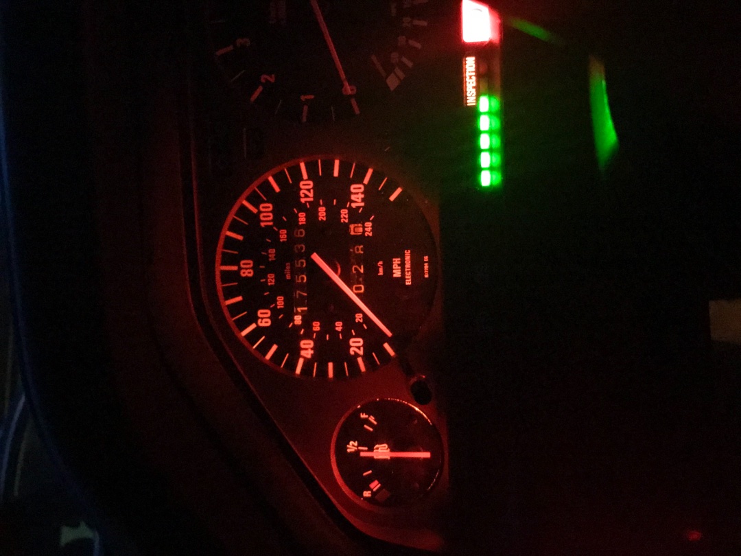

the first problem is that the red backlight for the instrument cluster has given up. all the other backlights for the clock and switches work its just now in the dark I cant see my speed winkeye

I think ..............there are two cap less bulbs in the cluster but please be very careful and not replace them with the incorrect wattage !!
I think they should be 3W and not the usual 5W but have a look in the "wiki" first.

Took out the cluster and got confused. Put the cluster back in and hey ho.... they work again! As with many of the electrical problems with this car just fiddling around with the connections seems to get it working again.
