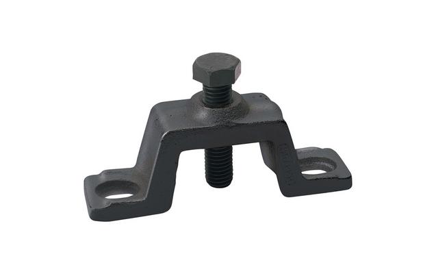

i would personally stay with a reputable brand. when i did mine after undoing the hub nut i was able to pull the bearings off with my bare hands. if it is a bit stubborn this type of puller may help: http://i1.adis.ws/i/washford/1440746196609?w=637&h=403
but you could have a harder time if it leaves the inner race of the bearing behind on the stub axle.
