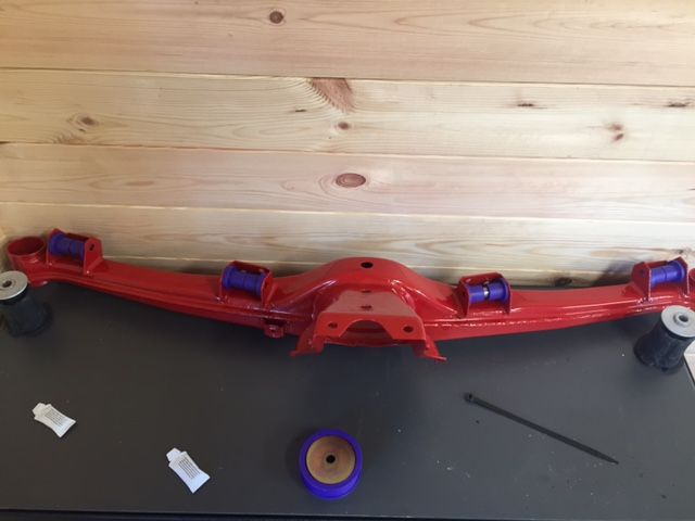

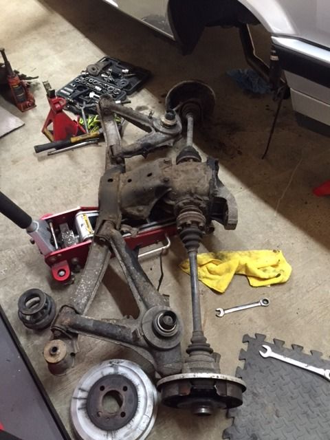

I am in the middle of doing some work to mine. It's defiantly stamped 427
I am running a 318is box now with an m52. Tops out about 115mph. Sits about 3.5krpm at 80mph.
Gearings a bit short but I like it that way. It's more of a B road blaster than a motorway commuter.
