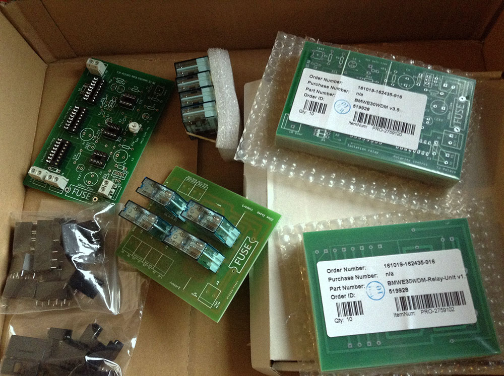

....after 3 months of design work and further testing, I've got my prototype circuit boards in.
Consists of a relay unit that lives with the switches in the centre console and the control electronics that lives in the tunnel next to the handbrake.
Now in the process of building the first boards up to test in the car
Paul
Paul

yup, quite right indeed, I'm using paired physically small relays to handle the stall current of two window motors - the automotive relays were just too big, at least it is all pretty small now....
Paul

I built this, and yes there are numerous ways to make it more "integrated" except you need to modify the car quite a lot - either with dedicated switches or adding E36 door catches which I think need you to cut a larger hole in the door jamb and so on.
I opted for something that whilst not "perfect" requires only the odd cable adding and some wiring mods under the window switches in the centre console.
I've been running this on my car for years - it has a nice personality - dissabled by lifting the rear ashtray - or lowering the roof - I built it because my roof cover sags and I'm unable to adjust the windows to compensate -
The problem is that a lot of people have aircon controls in the centre console which is where I stowed the electronics - so it only fits in some versions of the car, making the demand for this about 3 people who've voiced an interest - just not worth the hassle.
There's also a guy who wants the drawings for my design... nah. I think not... I had fun with this and until I get a new roof I'll keep using it or I might re design a new mosfet/non relay much smaller unit if lockdown comes around again!
You can easily pull the design from my blog if you have a spare few weeks
(The Window Drop Module is below the ABS article - just scroll down)
