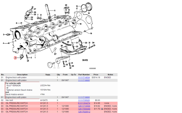

I think there may be a bit of confusion here, between the oil pressure switch and the oil level switch, but as aimlessrock says, the oil cooler is little more than an ornament on a non track 325i.
pianist
- Posts: 396
- Joined: Mon Mar 12, 2012 11:00 pm
- Location: Lancashire
+1 I think aimlessrock is talking about level switch not pressure one but I would replace the pressure switch and see if it fixes it
