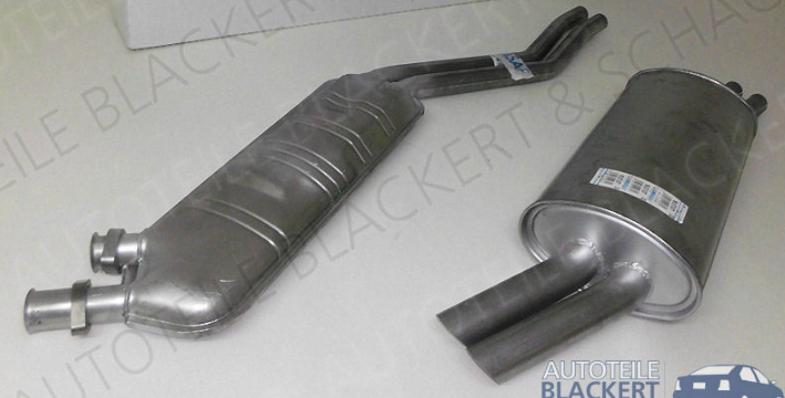

Thanks for that Brian, yes I've had an experience or two like this, but I'm a bit freaked by the system I have. It's now off the car, I'll post some pictures, maybe someone will help to identify the bits I may need.
The back box has been chopped and split to allow the pipes to be sleeved - obviously a bodge - I just need to determine what's real and what's not.

So, this is what I have fitted, having dismantled all the old crap, it appears to make sense - looks like U bolts are needed though.
