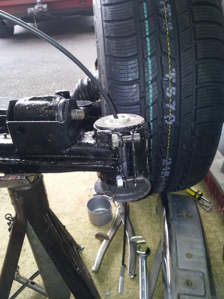

HairyScreech
Posts: 6265
Fri Mar 06, 2015 1:20 pm
This is why I altered my beam as below:
Has been fine for the last 1300 miles so I can't see it being an issue.
