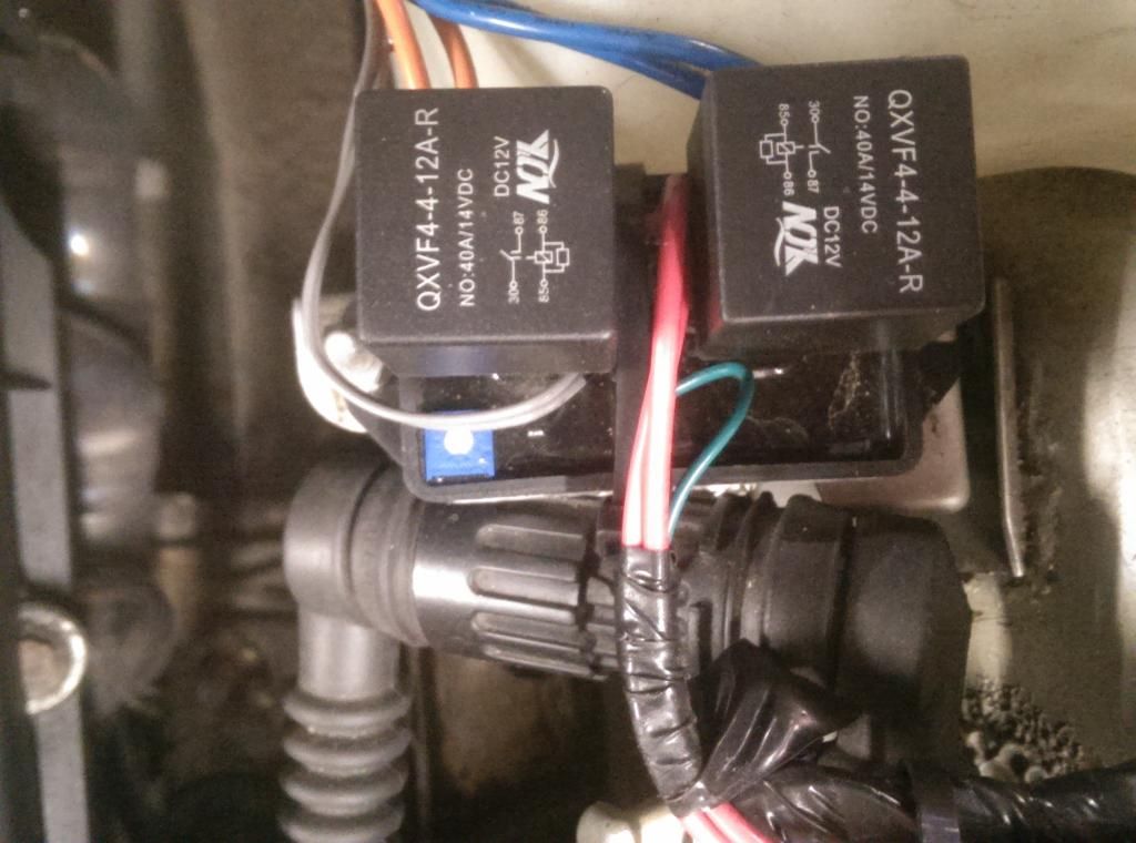

Is there a relay in the circuit?
Where is the negative (earth) lead from the fan connected?
Is there a fuse in the circuit?
Where does the fan circuit obtain its power from?

There is a relay in the circuit, the negative earth is connected to the front panel. There is also a fuse which in the circuit which I should check, Also the circuit obtains its power from the battery.

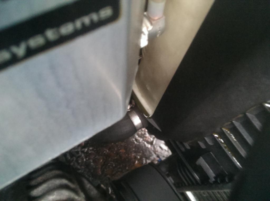

I should also mention that the radiator had a leak and I got some rad weld as a quick fix, I had to fill it back to level with water and bleed it with the screw on the rad but maybe I'm not doing it right as temperature sensor is at the top of the rad. Would it be a good idea to flush it all and try again, whats the best way?
You can see where the leak is coming from:
Wiring for fan:
