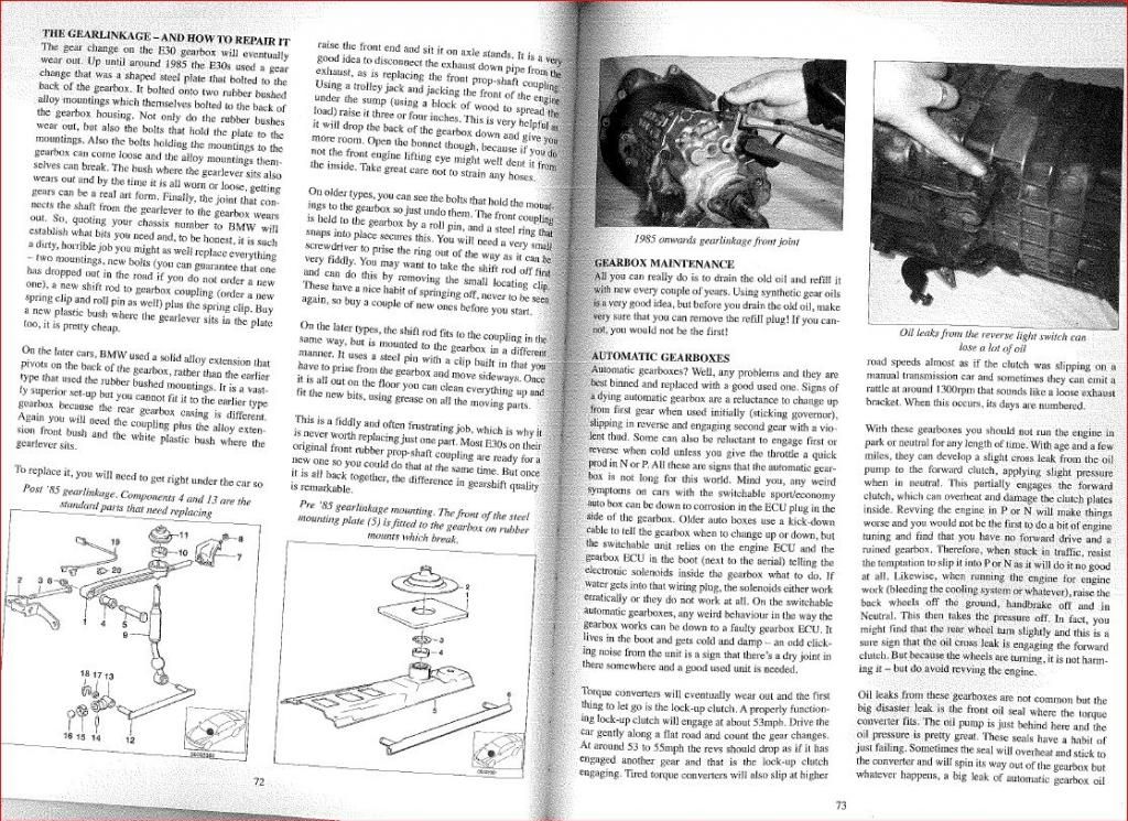

Anyone know the part number of the bracket that bolts on the rear of the box to make it compatible with a post facelift shifting mech for an M20B25.
page 72 of andyboys resto guide shows the part as item 2, but no part number.

Thanks, I have looked and cant find the diagram that is reproduced in andyboys book...

unfortunately neither diagram shows the part I need.
I guess the question now should be... has anyone ever seen a getrag box with the bracket bolted on... ?
many years ago I did a manual conversion with a G260 box from a 323i (sept 85) and that had the correct rear casting for an alloy shifting arm even though the car was built with the crappy earlier style steel plate shifting support

No fella. I want to fit a late shifting mech to early box...
G260s don't grow on trees in Oz so I'm going to see if I can get a bracket made up.
I'm still baffled by the diagram in Andyboy's resto Bible that clearly shows the part that I need on page 72.

Must be an old ETK picture in Andyboys book. I see the bracket you are referring to
Re reading page 72 itseems to indicate that you need to change rear covers to fit the late shifter mech to an early box.

I just got back from Saul in Tottenham... great bloke, still grumpy as fook, but he knew exactly the part I need.
Thanks for posting the page I was referring to... maybe jog someones memory.
fundamentally, part number 2 in the left hand diagram on page 72 provides support for the linkage in Andrews hand in left side photo on page 73

mark_i wrote:fundamentally, part number 2 in the left hand diagram on page 72 provides support for the linkage in Andrews hand in left side photo on page 73
I have never seen number 2 on any later type shift linkage. The main arm (number 1) fixes through the actual rear casting of the gearbox, not a bolt on support like number 2.
Sounds like you need to swap over the rear casing of the box to achieve what you want, if that's possible.

swapping the rear casing is a possibility... probably easier to get a bracket made up

mark_i wrote: probably easier to get a bracket made up
That's what I was thinking. Although I've never seen one of these brackets, it's just a bent flat steel bar that picks up on a couple of studs at the rear of the 'box and positions a mount for the later linkage arm where there's a casting added to the later rear cover
