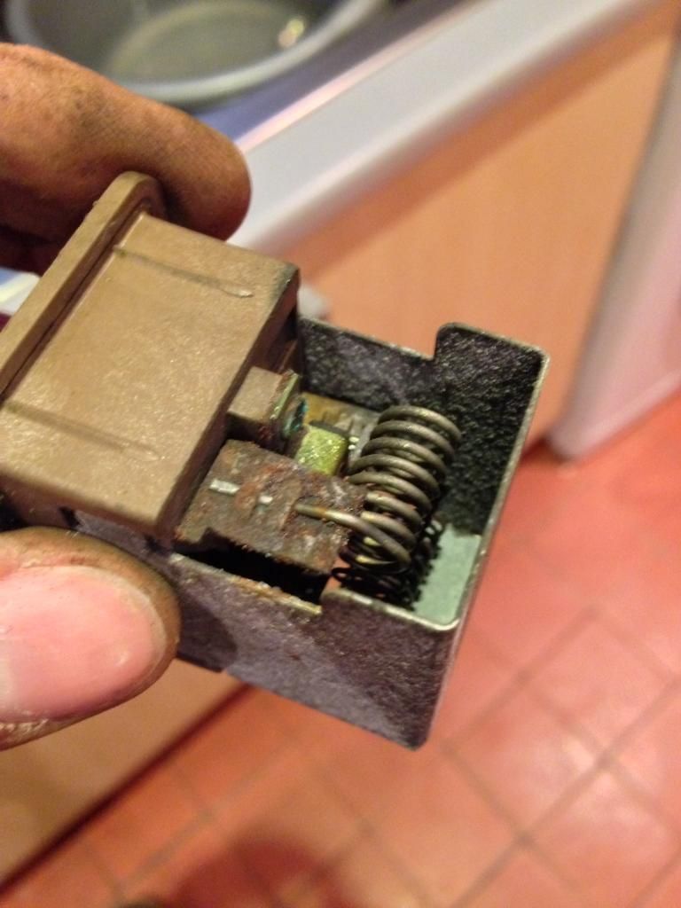

I had this issue and so I just pulled my heater resistor out through the passenger footwell, wasn't hard to do.
Looked a bit grubby, gave it a clean with some WD40, sandpaper and a fine wire brush, whacked it back in for all 4 fan speeds.
Although my fan had a slight squeak on 1 or 2 so it will need to come out to be lubricated eventually.
