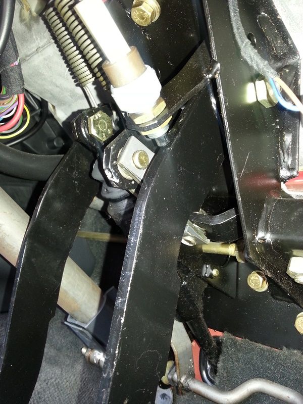

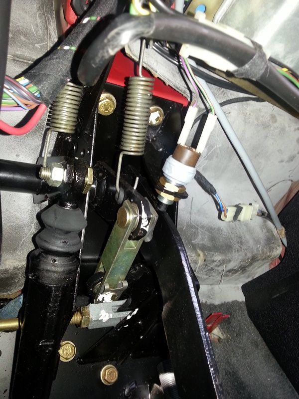

Had a look this afternoon.
A simple task of adjusting the brake switch, which is threaded for adjustment, 17mm spanner to release the locking nut & move the switch forward. It only needed 2mm of adjustment & job sorted.
Still looking brand new under there, not bad for 28 yrs old. (that's the car not me!)
Thanks for the help, Cheers

Brake switch is only adjustable on older models, and if it was set correctly at the factory, shouldn't need to be adjusted now. Pull rod (visible behind clutch cylinder in second pic.) is probably what you should have been adjusting.

Do you think I should do that then, there is no play in the brake pedal at all.Brianmoooore wrote:Brake switch is only adjustable on older models, and if it was set correctly at the factory, shouldn't need to be adjusted now. Pull rod (visible behind clutch cylinder in second pic.) is probably what you should have been adjusting.
Brianmoooore
- Posts: 49360
There won't be now that you've moved the switch down. Back the switch off, then see if there's any play.
