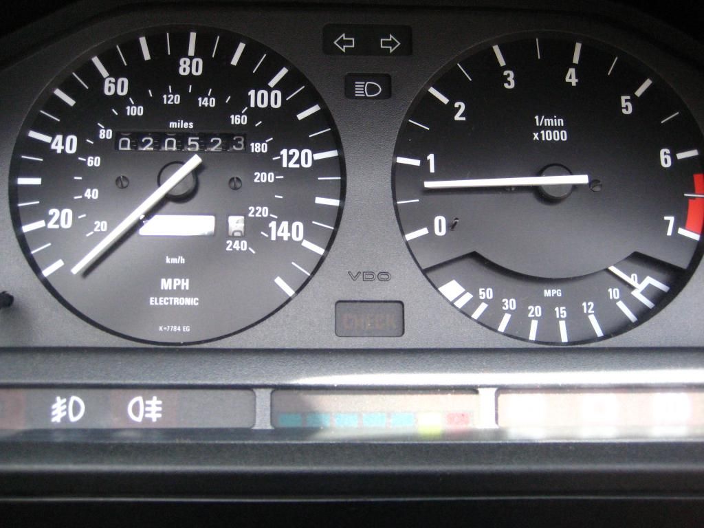

What does the tacho. do when the problem occurs? Drop with the engine revs., or drop rapidly?
The tacho drops with engine revs, although it's not a particularly smooth movement, a tiny bit "jerky" I'd say. (when the fault occurs)
Fuel gauge still doing it's own thing, not sure this is related though. The only instrument not working as it should.

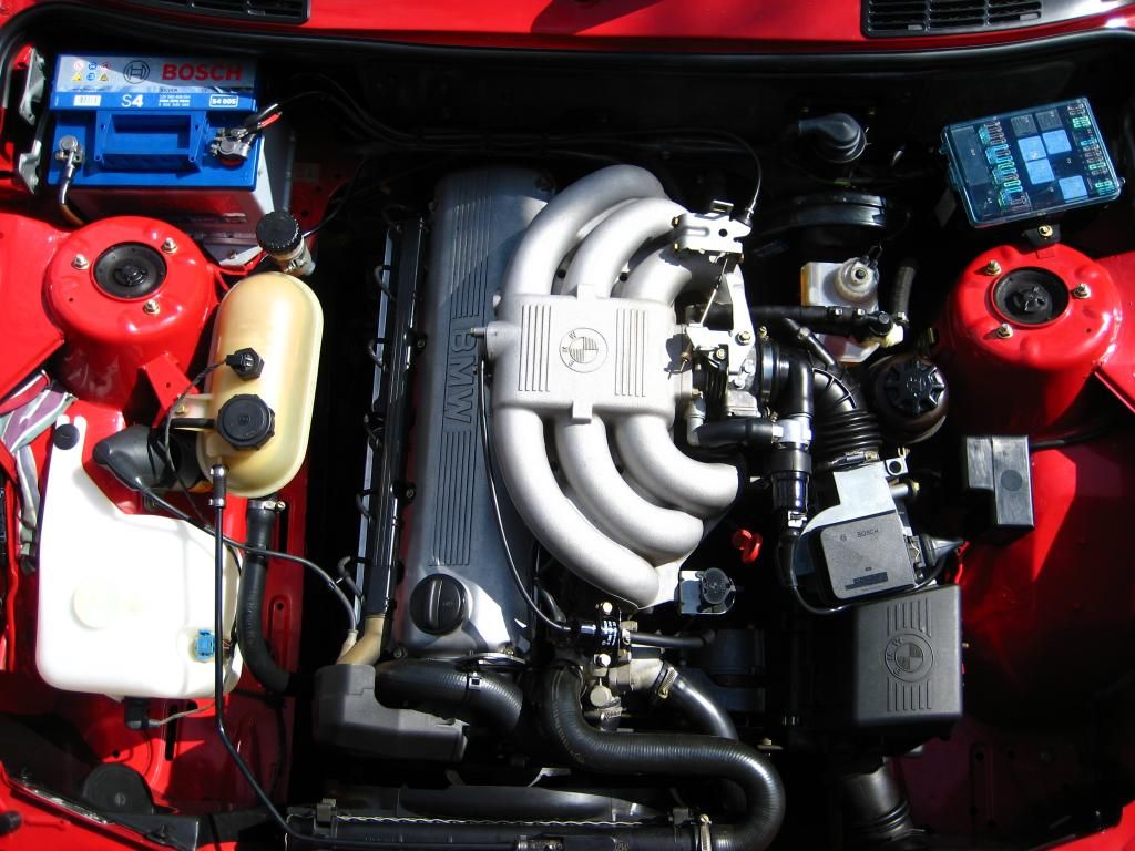

Update:
I also took the CPS from it's holder, cleaned it checked the connections & cable, then replaced it ensuring it was positioned correctly in it's holder/bracket.

bloody hell that's clean
Lovely motor you have there.
It's always worth sending the injectors off to be rebuilt (10 quid each with Injectortune in the Trader's section) as it may be that one or more is sticking, which is why it can't handle high revs.
If you've got an assistant who can hold the accelerator pedal, then using a screwdriver as a stethoscope should help you confirm whether each injector is firing or not.
'89 325i Touring | Touring Resto Thread | In-Dash Screen install

I would try running some injector cleaner or Redex through it first, before attempting to remove the injectors.
- Brianmoooore
- Posts: 49358
Someone mention snake oil?
- Old Skooler
- Posts: 14070
- Location: Canterbury
Worth a try, surely, before going to all the hassle of removing injectors and sending them away...
Don't forget, this is a 20,000-mile car - the injectors are unlikely to be worn.
