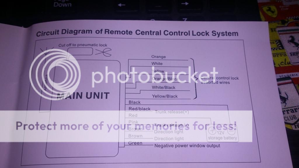

Here is the device in question:
http://www.ebay.co.uk/itm/290997092780? ... 1497.l2649
Here are the instructions to it:

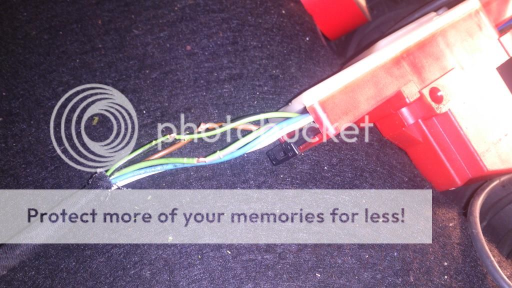

First thing to do is access the boot area of your car, take off the carpet at the rear panel by the lights so you can see the lock mechanism for the boot.
The lock mechanism is white & red with a cable going to it.
Basically that cable is what you need. (Sorry for the poor pictures)
The wires you need are, Brown = Ground
Green with black stripe = Lock
Green with purple stripe = Unlock
The other wires just ignore.

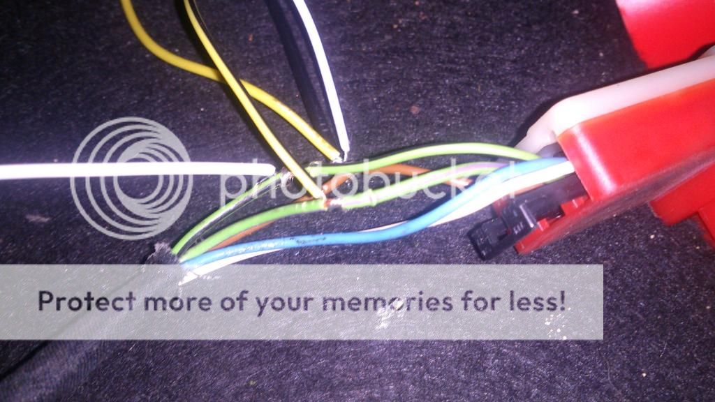

So from this unit, the Lock wire is WHITE, so join white onto GREEN WITH BLACK stripe.
The Unlock is YELLOW WITH BLACK stripe, so join this wire onto GREEN WITH PURPLE stripe.
The E30 uses a negative trigger (dont know what this means) but i know that from the unit join BLACK, YELLOW & WHITE WITH BLACK stripe all onto the BROWN wire from the cable.
When you cut into the wires DONT COPY ME, cut it back bit further, closer to the left compartment because the wires aren't long enough. Then solder or put proper connectors.

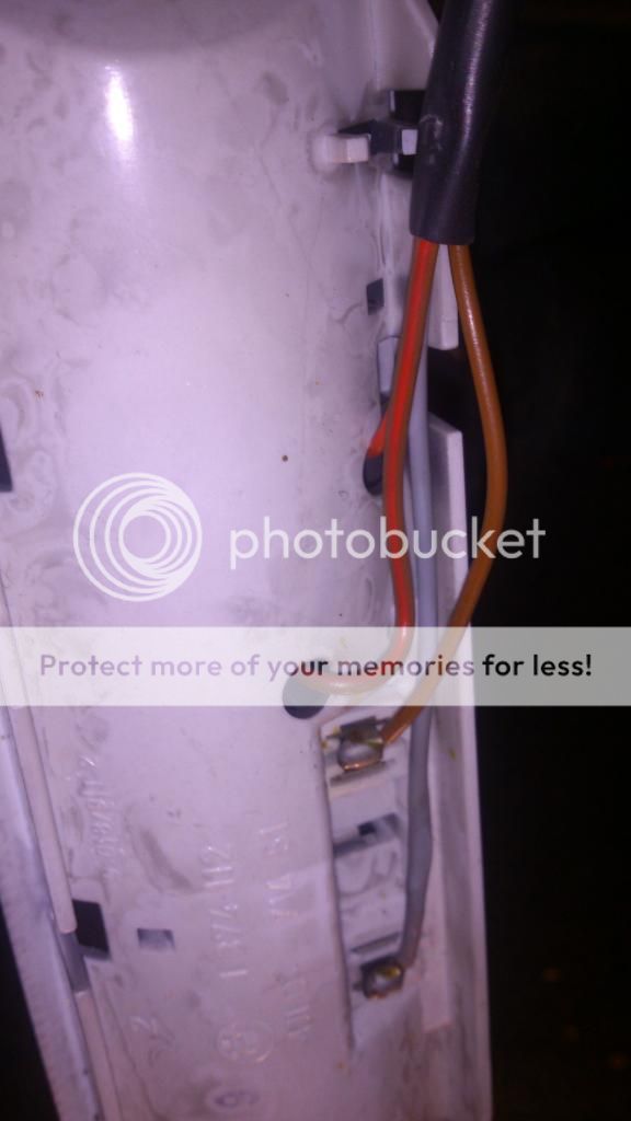

Now all the tricky parts are done you need a constant live, my car is a touring so doesnt have a power aerial. So i took the permanent live from the rear interior light above. Flat screwdriver should get it off no problem. Then joid RED wire from unit onto BROWN AND RED wire at the back of the interior light.
Otherwise the live can be found on the antenna wires.

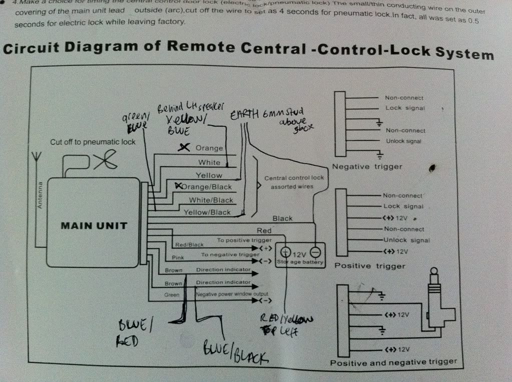

Y did you put it in the boot?
Mines above the ABS ECU where you can tap into both indicators as well.
This wiring diagram has the E30 coloured wires on it relating to the glove box area and behind the speaker there.

Sanchez wrote:Y did you put it in the boot?
I went to the boot because when i searched on the internet people where saying it was the easiest place to install it.
BMW planned the wiring loom to provide all the required connections for an alarm/immobiliser/remote locking module in the area around the glovebox.
Just a quick question, area all the wires mentioned behind the speaker?
1988 M3 lachs silver S50B32
1989 325i sport delphin grey
1993 316i lux touring lazur blue
Brianmoooore
Posts: 49358
Sun Jan 05, 2014 3:24 pm
Yellow/blue and green/blue behind the speaker.
Red/yellow at the accessories socket.
Earths at the earthing stud with all the existing browns.
Blue/red and blue/black at the plug next to the accessories socket.

Brianmoooore wrote:Yellow/blue and green/blue behind the speaker.
Follow this and you cant go far wrong, just done this on my touring the other day, had it done in half an hour, to make a neat job of it have some heat shrink and use soldered joints. Dont be a butcher and use twist and tape, bullets or chocky blocks
I opened up the wires in the boot of my 325e (US) '84, and the wires seem to be a different color for me. I'm colorblind to some colors but I'm pretty sure this is not green with purple, right?
Photo: https://i.imgur.com/vVaX2tB.jpg
