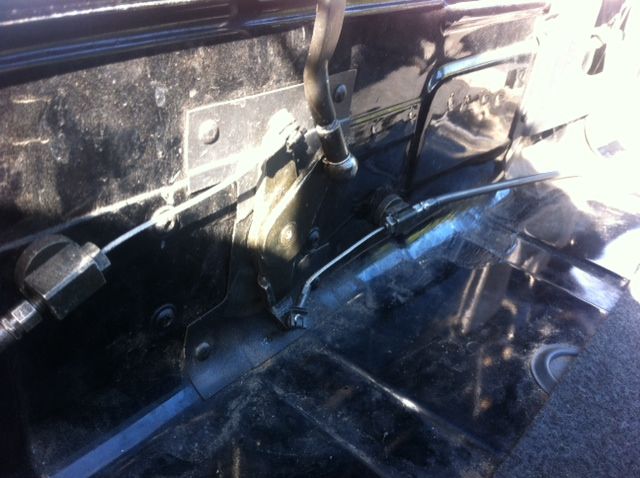

The Horseshoe on my cab isnt closing fully. I think the roof is folding flat but on inspection, Ive noticed that the cables appear stretched.
Has anyone ever changed these cables before?
have a look at the pic.. Apologies for pic quality..

I had a similar problem with mine and I was able to correct it by adjusting the plate that holds the microswitches on the horseshoe motor in the boot. The problem was actually that the motor was being switched off before the horseshoe was fully pulled down, so I just adjusted this plate to make the motor stay on that little bit longer.

Thanks Pete, I thought the cable on the right in the pic looked loose. Any pics I've seen seem to show cables that are tighter.

Mine look just as loose as those to be honest. I looked into getting replacement cables, but they're like £30 or £40 a pair if I remember, maybe even more. Best to try a little tinkering first in case you can save yourself a few bob.
