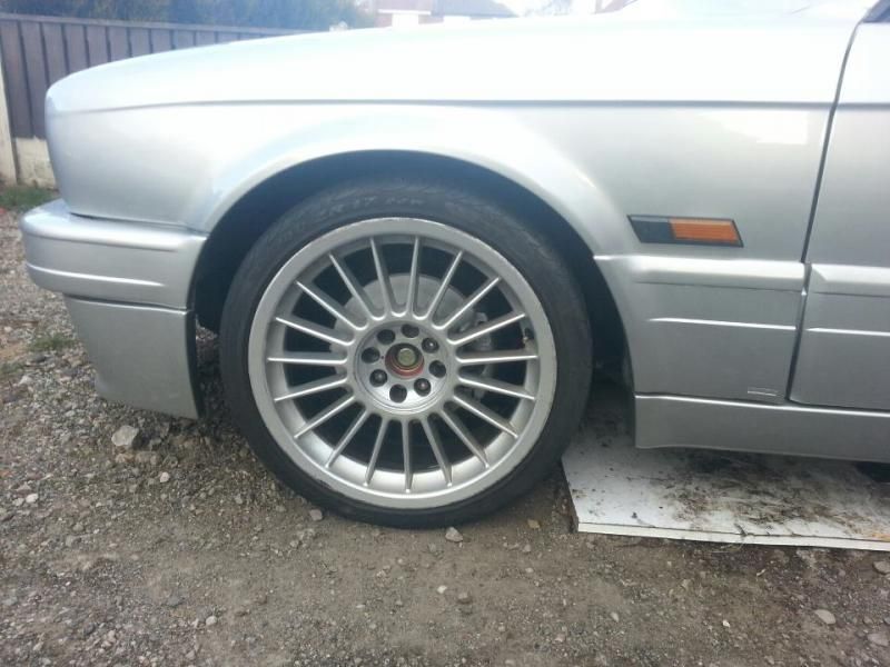

This is how mine sits with 60/40 H&R Cup kit, and E92 top hats which supposedly drop the front another 10mm. The car hasn't moved yet since fitting but can't see it settling too much more. The wheels are 17" with 205/40 tyres on, I have got new wheels, so ignore the fact they're Alpina replicas

yerr I see what you mean doesn't look low enough for what im going for.
my car looks as low as that on the standard 15" bbs wheels,
