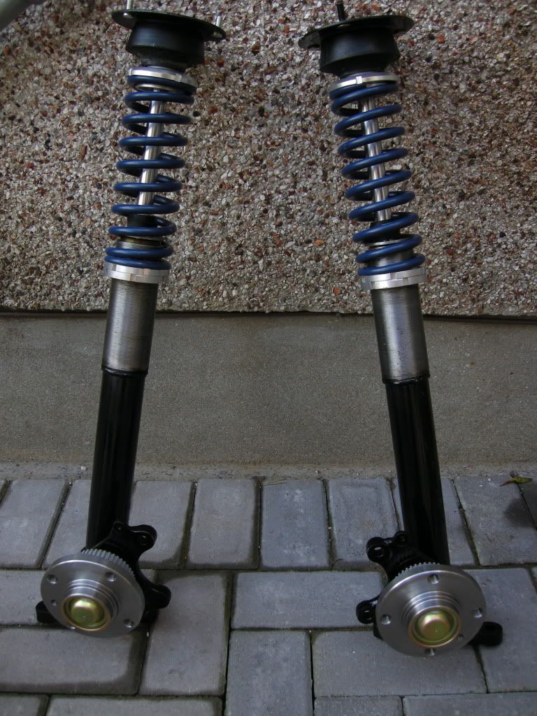

You need to do some serious research on what you are doing. Here are some I built:
The problem that you have is the top mount. With OEM springs it sits down within the springs, but as you can see it sits on top of the coilover. This means before you start winding down the collar and lowering you have added to the ride hight. This means that by the time you have a meaningful drop you start running out of suspension travel.
Theres a few ways to combat this, shorter top mounts etc the way I did it was to shorten the strut and get shorter shocks to fit in them. Gaz will do this for you so best to order them the size you need in the first place, not what I did.
Your welding needs to be 101% No pigeon sh1t.
Additional to that you will probably need helper springs to keep the main spring under compression when there is no load on the suspension.
Are the £600+ ones starting to make more sense yet :D It is a lot of hastle, but you can do it. You will need a friendly/short sighted MOT man too.
