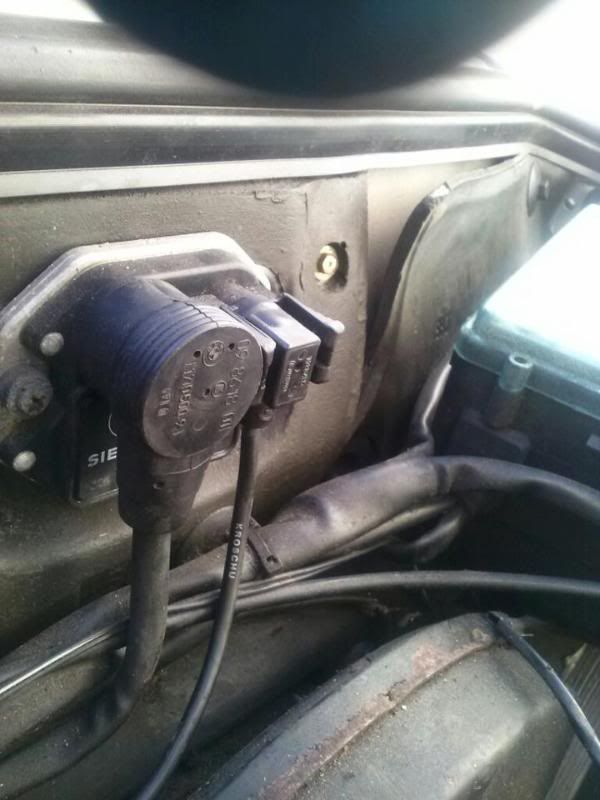

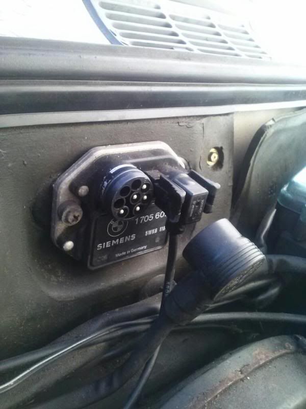

Post Sun Nov 11, 2012 5:01 pm
this is what i have on the 318 near fuse box , is this a ignition module only or loom plug??
