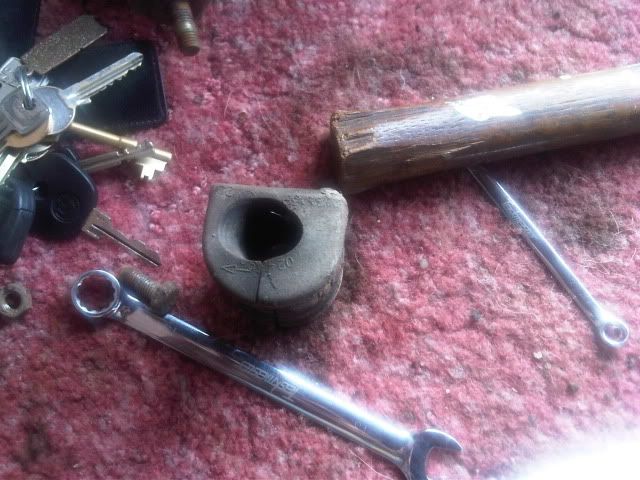

Posts: 9681
Location: South Staffordshire
Fri Mar 23, 2012 7:10 am
This one that came off my Touring 8O
