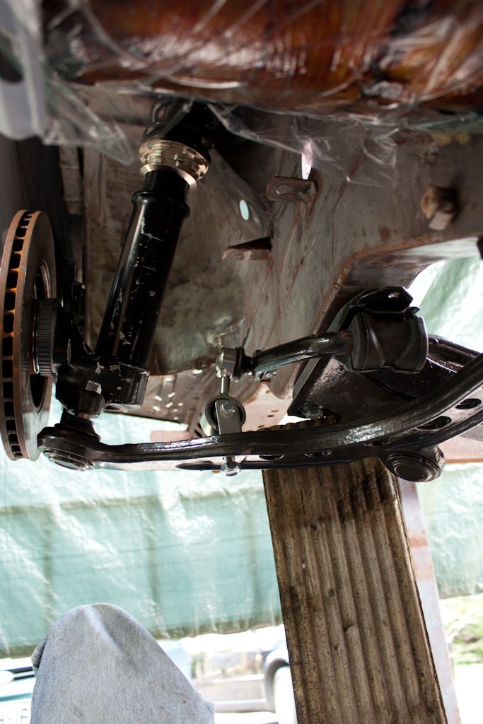

I've built up the front again to have a play around.
Just from looking at it the drop link will be at quite and angle away from the ARB when connected to the strut, is this going to be a problem? Is it the same on an M3 or does this have a wider ARB?
Also from looking around and reading about this upgrade, how is this going to effect how the car drives on the road?
Also shouldn't I be looking for something for the rear ARB also to get it back down with the car lowered?

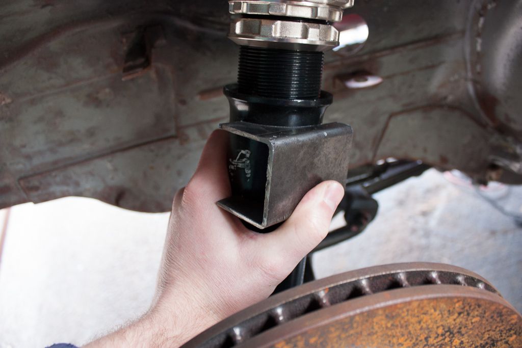

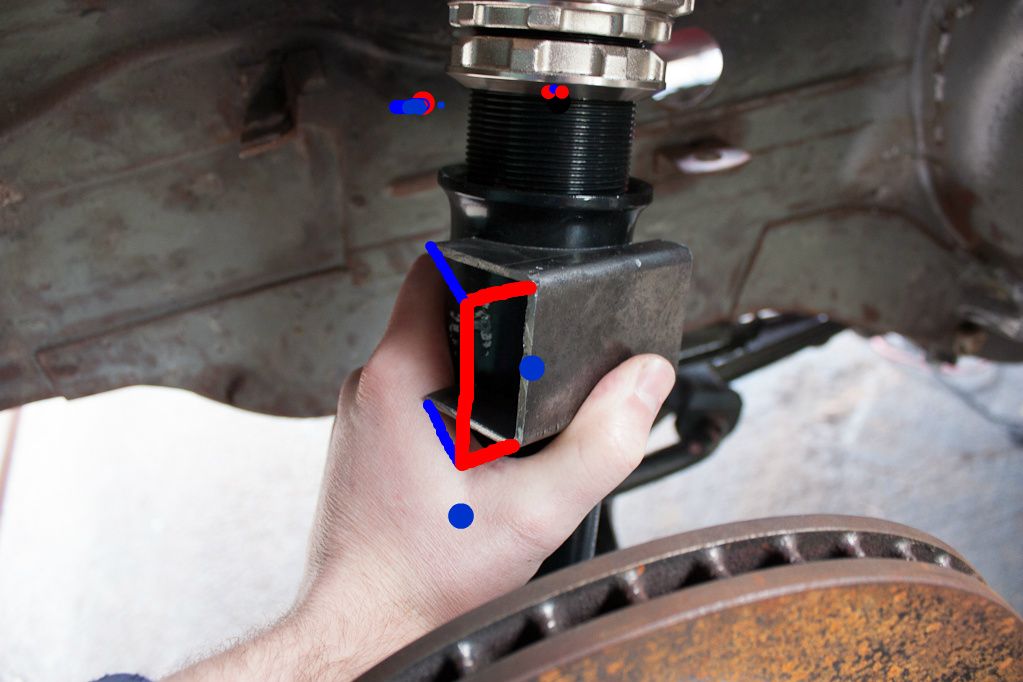

Got something knocked up earlier, let me know what you guys think:
Better/clearer view of it
I made it a little short, reckon I should extent it a little and chamfer it back to the strut bit like so
Possible the end nearest to the strut could be bent down an also welded to the strut?
I'd appreciate some feedback on this before I go and weld this onto the strut!

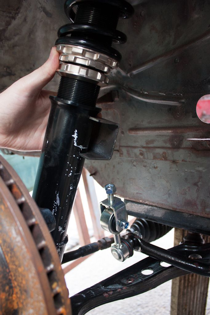

Got the adjustable droplinks, they come with 2 lengths of bar, I'm using the shorter one in the pics.
Can anyone comment on how it looks if it were welded as in the pics? The ARB is roughly horizontal and the coilovers are adjusted with the ride height at more or less how I want them. Should the link be parallel to the strut or does it matter if it's at an angle?
I need to re-make the bracket but you get the idea.
