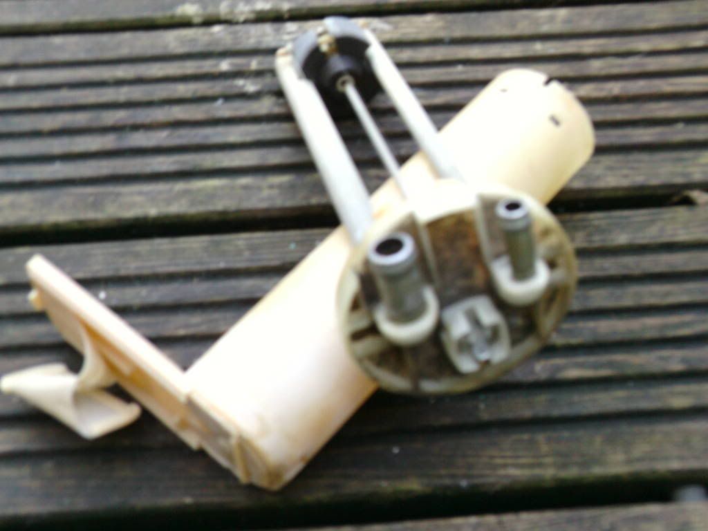

Well, I have bought a like for like replacement. I thought I'd swap the internal pump first as it would be the easiest. I got curious wondering if it was a fuel pump/sender or just a sender so I took the one I removed from my car apart after swaping them. It looks like just a sender to me which makes me wonder again. If there is an internal pump which everyone seems to say there is on a prefacelift m20, where is it. There is only one hatch to open on the rear seat and this sender is all thats there.
The external one is where I would expect to see it, close to the rear arch.

hi mine is an SA car and mine has a pump and sender in the tank and it looks nothing like yours

Some pre facelift set ups used a pump in the tank to feed the external one and some didn't. I've never seen anything definitive to say which models have what, or what the consequences are of using the 'wrong' one, other than an external pump used with an internal pump will run very noisily if the in tank pump fails.
The easy way to tell which you have is by looking at the electrical connectors. Yours has only one three pin plug for the level sensor. If it was combined with a pump there'd be a second two pin plug.
Fitting a post facelift pump is the complete solution.
