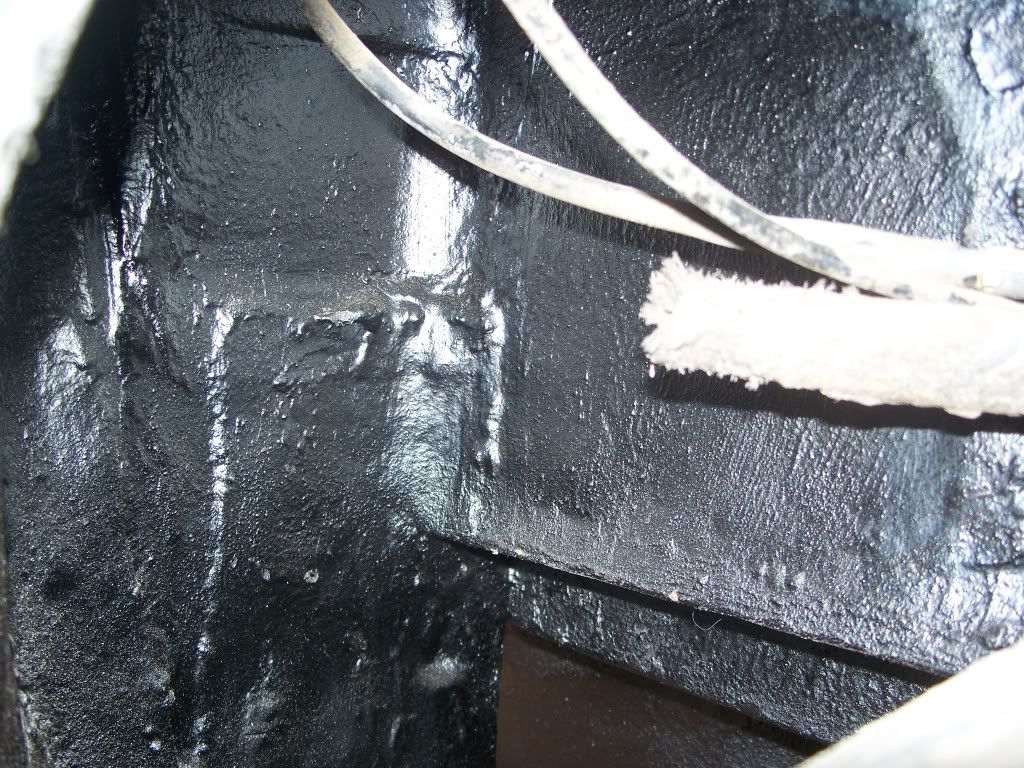

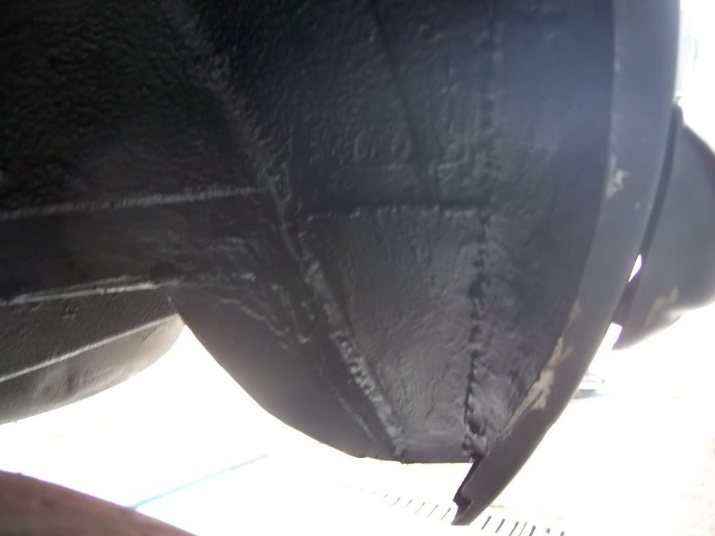

That doesn't look too bad tbh, i've had some fabricators working on my E21 and its now in for paint. The workmanship is so good you'd struggle to know where they have worked if it wasn't pointed out to you. If you need someone and you're in the north (well even if you're not) i would seriously recommend them and the pricing is very resonable (very!!)

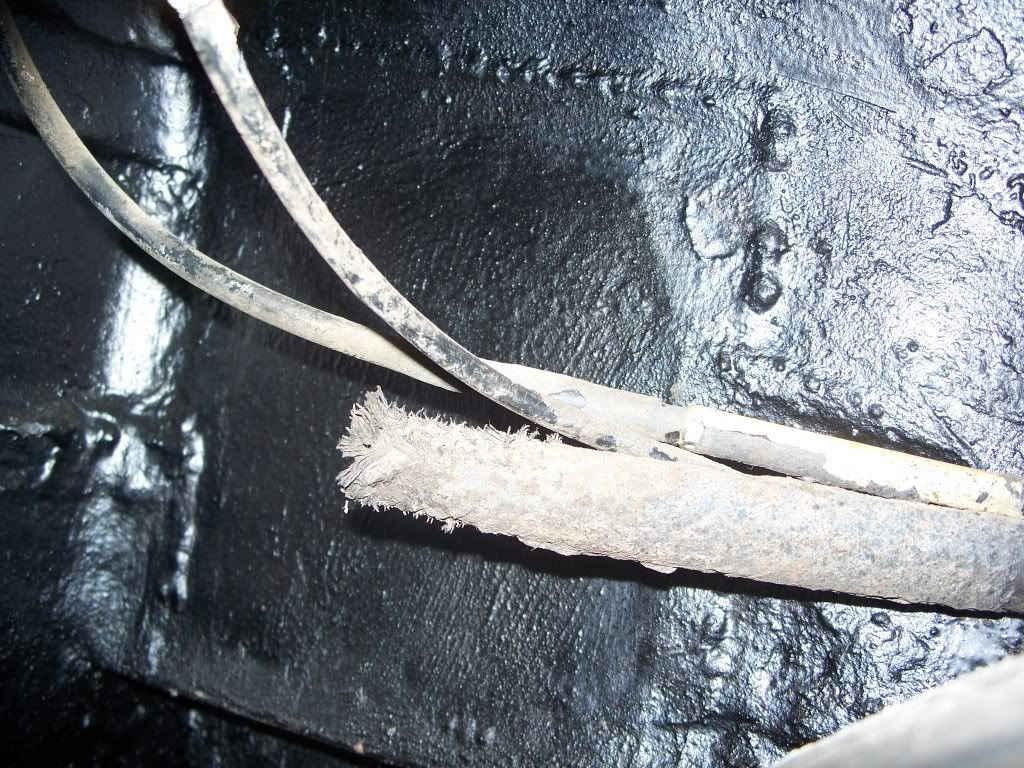

My Sport also had rust in this area, and holes in the front inner arches that let in water (remove the wheel arch liner to check):
