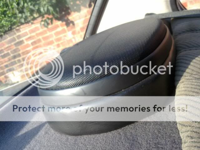

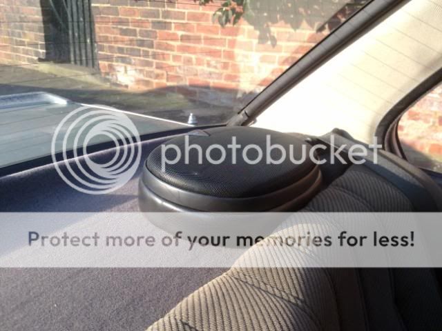

dont cut the metal, some pillock did that before i got my car pretty sure vibrations are coming from that area, just get boxes drill a small hole for the wires,
i got these - http://www.ebay.co.uk/itm/6-x-9-inch-Ca ... 2eb73b92d1
there big height wise, but what i did is cut the bottom inch or so off, took the parcel shelf off lined the boxes up behind the headrests, and screwed them in place from under the shelf all around, put the shelf back and screwed the speakers down,
the back of the box is slanted downwards so blends in nicely, its not just a square box,
you can just about make it out in the pics below
http://i223.photobucket.com/albums/dd26 ... 546283.jpg
http://i223.photobucket.com/albums/dd26 ... b4cc51.jpg

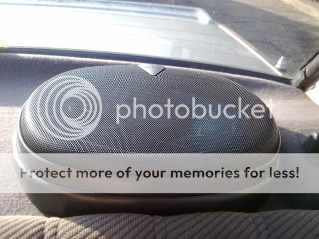

thst looks awesome, is it homemade?
- Von_Thrash
- Posts: 80
- Joined: Sat Jul 11, 2009 11:00 pm
That, is very nicely done.gaszman wrote:
My effort;
If they look big, . . . it's 'cos they iz 7"x10".

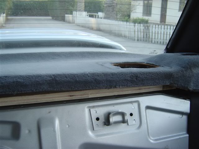

cutting holes will have no real negative effect other than it is a poor way to do the job, and is more difficult than making a spacer.
the speakers i fit were extreamly deep and the magnet was very big so i made two spacers from 1 inch plywood.
the first was a plywood sheet cut roughly to the size of the metal panel under the parcel shelf cover, i bolted this wooden piece to the metal panel (there are plenty of free holes to use) then you need to position the speakers to best fit the existing indentations in the metal panel. once positioned i cut out holes for the speakers in the wooden piece and bolted the wood to the metal panel.
you can see the wooden panel under the parcel shelf (it is not bolted doen yet in this pic

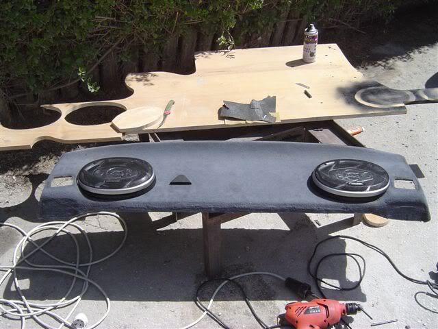

next i needed more spacers so i decided to fit them on top of the shelf, i cut out rings from the same plywood, sanded them and painted them black with a rattle can, (but you can probably just buy spacers)
then its a case of cutting the parcel shelf to suit, i needed to move the speakers very far outwards (i.e. toward the seatbelt reel) and thus needed to cut this part out, this is due to the magnet size, but if yours are not quite so big even this job will be easy.
and sprayed black
i dont have a shot in the car but i basically used long srcrews to fix the speaker to the rings, through the shelf and into the wooden panel underneath.
it is all very tight once in, and no vibrations, and best of all no ugly holes cut into your car. plus you can see by my pics all done in an easy DIY style!
