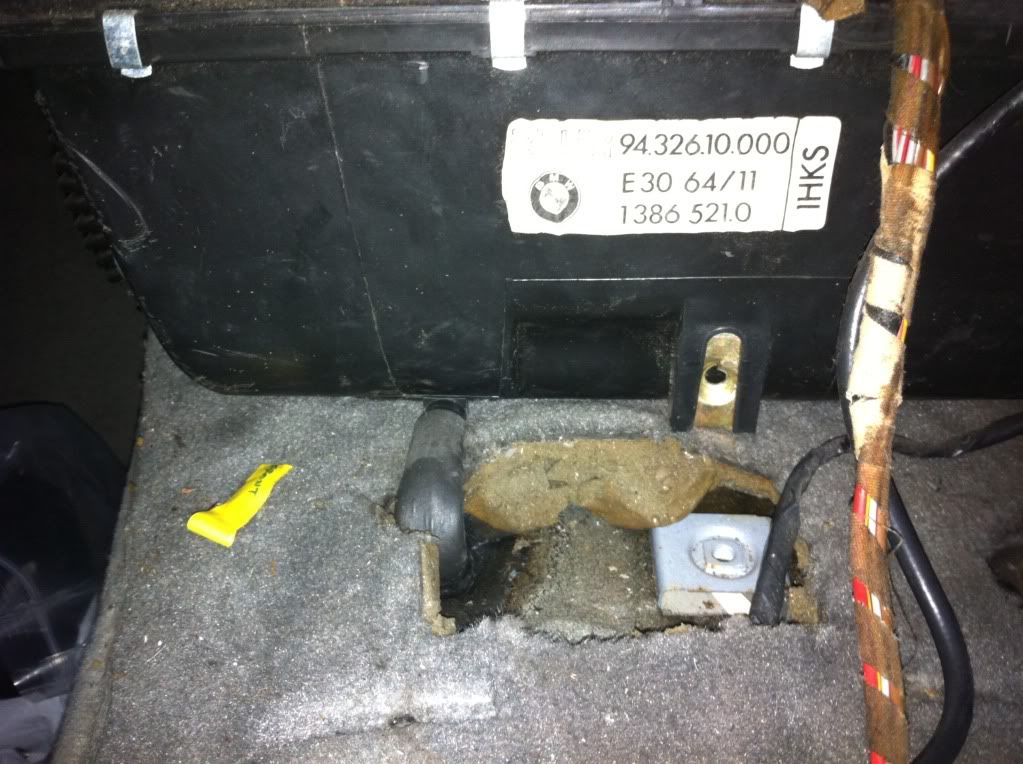

Ok, 1st picture shows a bracket on drivers side of heater box. I imagine I remove this.
These are just other photos of the heater box area.

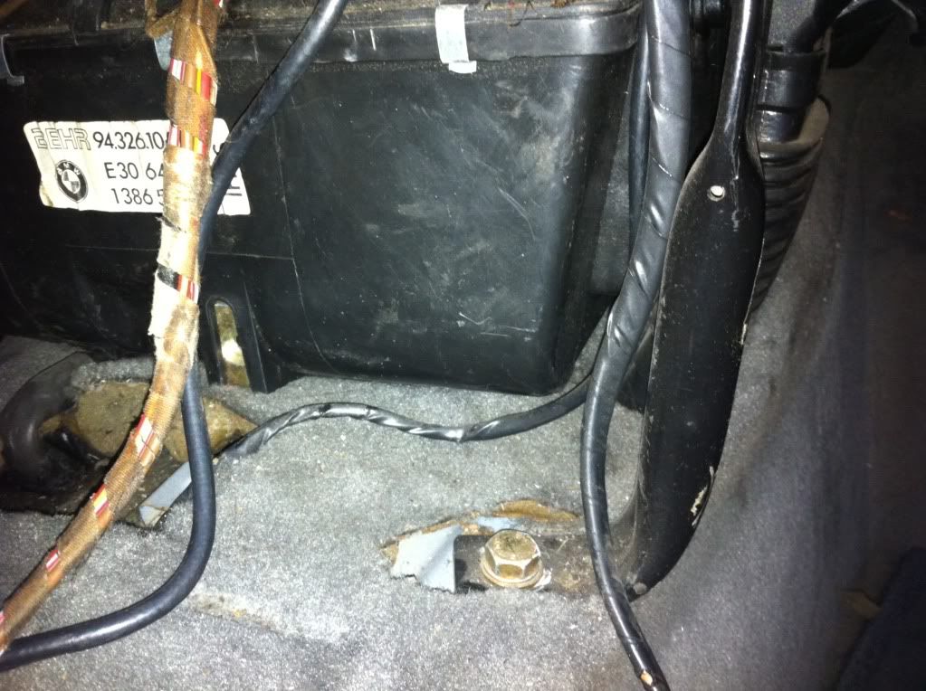

These photos are of the wiring that runs across the carpet where the rear part of the console sits!

That wiring looks like an alarm fit bodgery effort.....

Got the carpet out. All of the cutting that would be needed was already done. I had to cut so much of the carpet that lives under the centre console that it is only the last 6 inches or so of carpet that holds it together!
